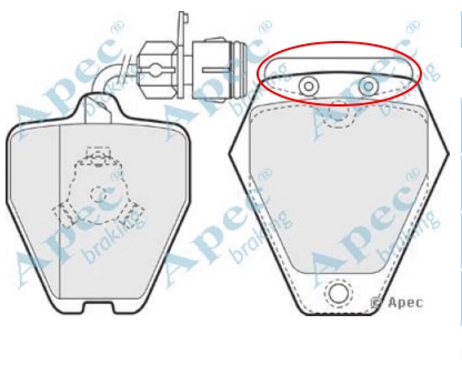

I recently picked up a 97 4.2L quattro that needed front rotors and pads replaced (UK personal import into Australia) Didnt think this would be a problem as I run my own business in performance parts. ... But wrong I was. After lots of googling, A8 forum searching and measuring, turns out my car runs a (cant remember exactly off the top of my head) a bit rare 310mm or 314mm front rotor. Not the same as teh AU specced car. .. Anyway I located them at a semi reasonable price. Then I started looking for pads. Im a dealer for Winmax brakes, and they dont do the Lucas caliper shape, only the brembo. My other brake supplier could only find a Remsa Pad to fit (its 4 pads per front corner) ... and to be honest once installed I find them horrible. Soft pedal, no modulation, they squeal (I dont mind squeal in a performance pad). 1500km in they are getting worse. have bled the system, ourselves and by a audi tech, pressure tested the system and master cyl and no leaks .... so conclusion is these Remsa's suck The only brake brands I normally deal with are Winmax and Project Mu, none of which do this shape pad. I'm ideally looking for a brand/spec that will take a bit of abuse (I also race, so I drive my road cars a bit enthusiastically) .. good braking torque, dust and noise im not overly concerned about, maybe rated to 500C at least? Organic, semi metallic, not fussed In my searching on the web I cannot find this pad in a performance spec. Mainly due to the brands in Europe being things never heard of here, ... can anyone give me some suggestions please? This is the info I have Remsa #0508.02 ![]() Many online catalogues, if you put in 97 A8 D2 4.2Q it only gives you the brembo single pad per side option Appreciate any input |

Eurocarparts - http://www.eurocarparts.com/ - do Pagid (standard, domestic use only) front pads for the Lucas system on the '97 A8 4.2 which look like what you are after tho' i leave to to you to check the dimensions. Also, our forum sponsors are used to shipping stuff around the world so they may be able to source and ship them for you. Where abouts in the land down under are you? I can do personal delivery to Perth WA in March! This is the tech spec from the eurocarparts site Brake System Lucas Connector Shape Round Height 1 [mm] 75,3 Height 2 [mm] 74,6 Number of pads 8 Number of Wear Indicators 2 Thickness [mm] 17,5 Wear Warning Contact With integrated wear sensor Width 1 [mm] 63,4 Width 2 [mm] 78,3 Fitting Position Front Fitted Quantity 1 PR Number 1LX

looks like the ATE spec for the S8 to me
http://www.webdealauto.com/fr/jeu-de....310021/1.html presumably you can buy tax free from the EU, but guaranteed there will be an importer in OZ Last edited by oldnick; 23rd November 2015 at 04:17 PM. |

Oldnick, thanks for the info about them being similar to the S8 of the time with the ATE system. I've just looked up my Winmax stuff, and they list a pad for the ATE system, but dont have a diagram, so something for me to look into.
But with that info it's allowed me to find the EBC listings, which im familiar with, EBC Optimax im sure I'll catch fire too (have dont that with greens in a smaller car) but reds and yellow are good options there. .. along with Hawk Thank you very much guys! Some of the sites will be helpful too for my other car which is an E38 740IL, although parts for them are more common here, still lets me look at options |

314mm and 323mm does have different part numbers but the pad itself is the same, it's just that the ones for 314mm have extra counterweight to reduce vibration, noise & squealing but 323mm doesn't to save the space and not rub on 16" wheel as the pads sit further from centre on 323mm brakes.
