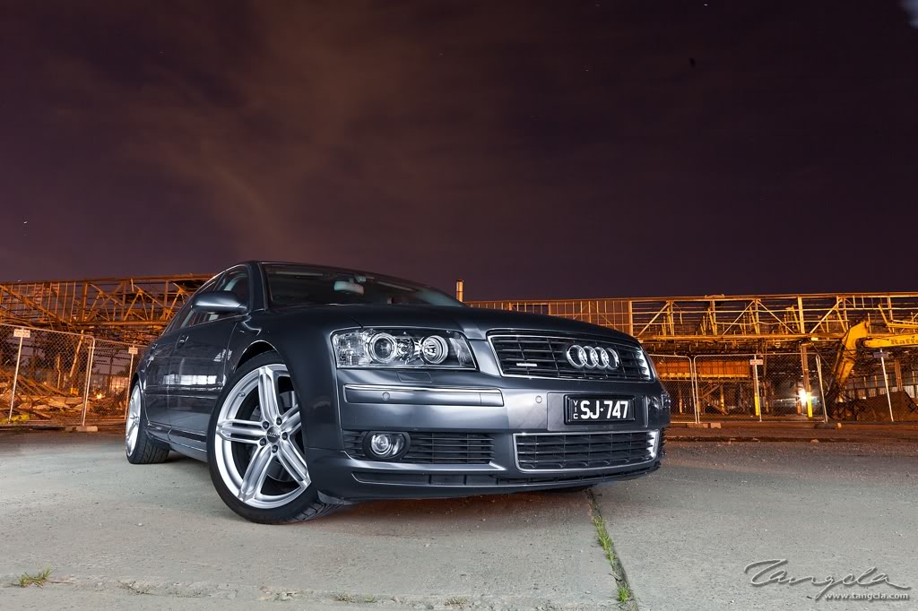

mike,
not sure how the car registration works over there, maybe the car reg changes with ownership, but this looks remarkably like your car. its an aussie car put up on one of the forums about 5 years ago if i remember correctly

Originally Posted by limoncello View Post
mike,
Attachment 12464
Haha. That is my car. That was probably uploaded by the previous owner.
It has changed somewhat since then however. Much more tech upgrades and some additional trim.
