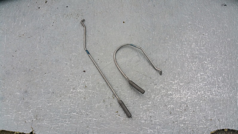

With some more wiggling, I got it to pop out of a hole:
And with some pliers, then removed it:
So, it seems somewhere in the last 5 years it was easier for someone to obtain a new door knob, than to simply find the one they had misplaced somewhere...

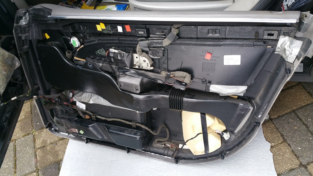

You can see the foam round the edge here:

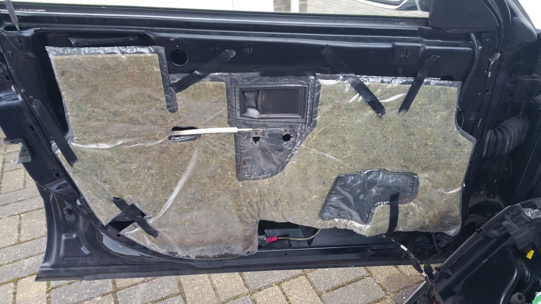

Another vital ingredient to getting this all correct is the plastic baffle that sits on the door, before the door card is installed. Its a facelift only item, which fortunately a8parts went to effort of stocking as my drivers door one was missing completely
Anyway. So after that long, and harrowing chapter, the doors now shut. Yes folks. All that effort, just so the doors shut properly. Do you see now why I so nearly jacked it in ?
