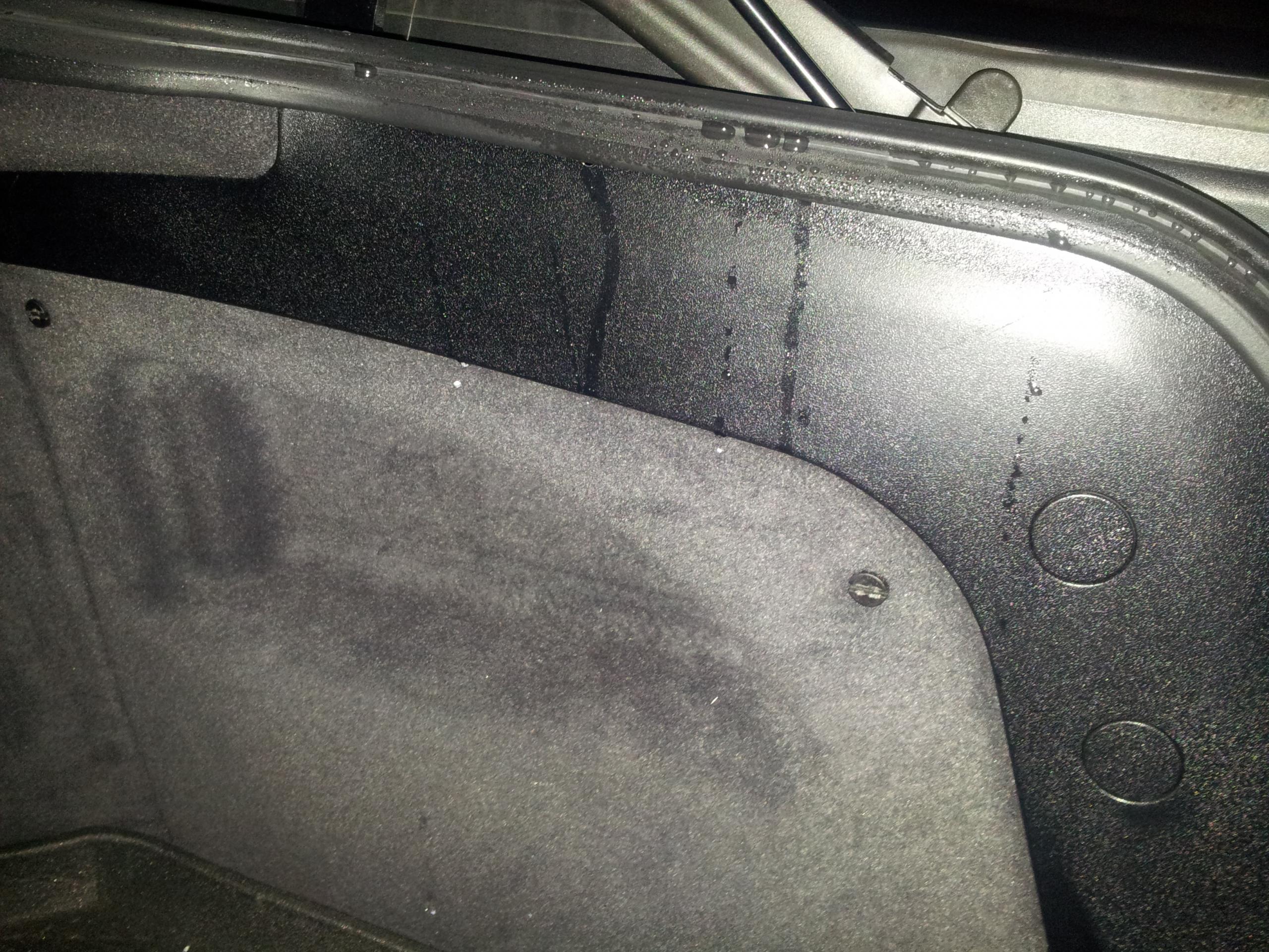

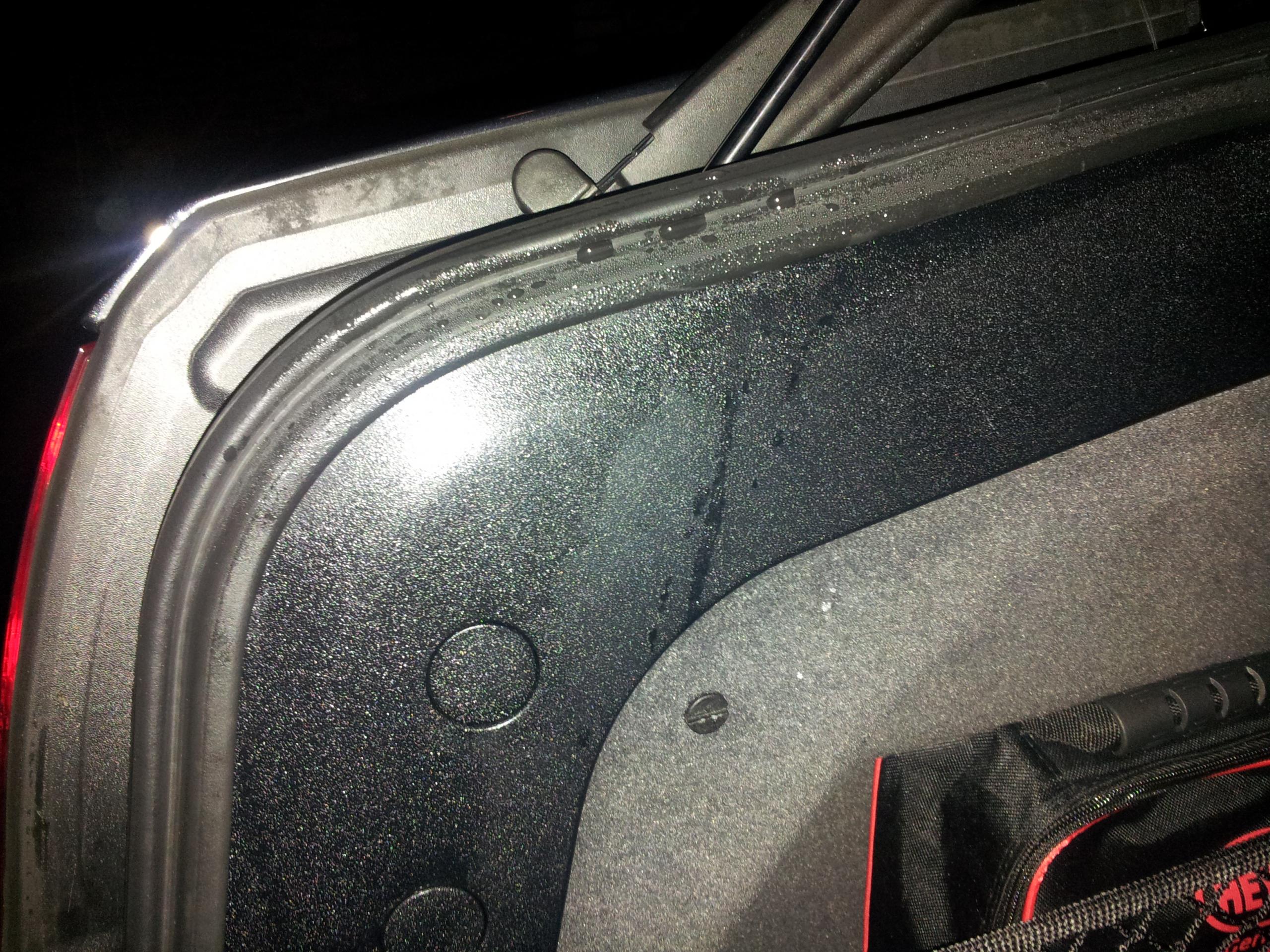

OK, I had little to no condensation on Tuesday as it was dry. It rained heavily yesterday and today I had condensation on front and rear screen, but more so on the rear screen. I opened the boot to check for damp again (which it was) and found water running down the side panels and along the seal. Do you think this could be either a knackered seal or a misaligned boot lid. A new boot seal maybe worthwhile do you think? Or is this a symptom of another problem?

Just spent the last 45 mins bailing out the boot. Under the boot liner, the carpet was wet and under the carpet/floor the spare wheel well was quite full. Had to do it with a sponge and kitchen roll and got 95% out. I have put spare wheel back and left the boot floor wedged up to allow air to circulate. I think that's where my condensation is coming from. The couple of litres of standing water in the boot!!!
I removed the RH side boot side panel and it was slightly damp in there, but that could have been condensed water from the main boot. Didn't seem sopping though and the battery was mainly dry. The LH side boot panel was bone dry. Both side panels seemed dry too. The boot-lid lining was damp, but again could be from condensation. No damp on headlining either, so I'm not sure it's coming from roof, but still a possibility its coming from window.
Next step is to get in there and close boot with a powerful torch and see if there is any light escaping and then after that it will have to be someone in the boot with a torch and me outside with a hose/jet-wash. I cant see how it can get through the boot seal as the seal is raised but I did jet-wash the car the other day so if the seal is bad then that would let a fair amount of water in. Very strange.
None of the water smelled bad either suggesting that all this is a recent thing. I don't remember anything this bad before.
Anyone seen water ingress this bad before or have any ideas other than window seal? It seemed far too much water for it to be the window seal.

Well everything is dried out and I have driven 150 miles or more in the rain and its all still dry. Will check again in the morning after its been sat in rain overnight but I suspect that the water came in courtesy of the jet wash and an old flattened boot seal that's just not enough to keep pressurised water out. Will order a new seal anyway and see how it goes. Won't harm.
I have been jet washing the car since I've had it so i wonder how long this has been going on for unnoticed. Condensation in the back light lens as well as in the rear windscreen. Could all be related?
