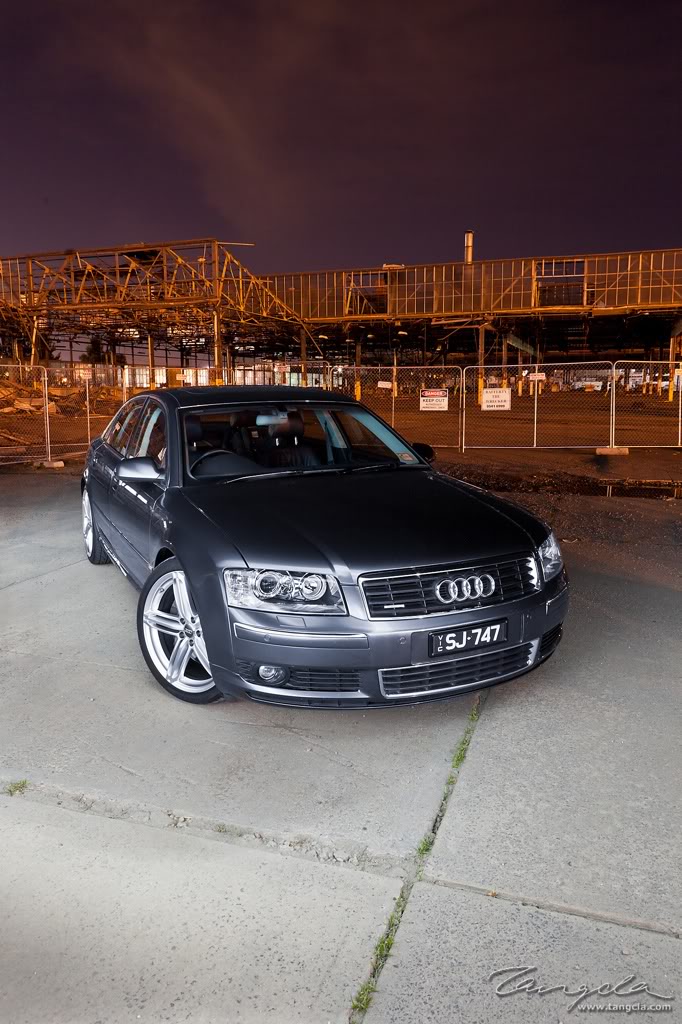

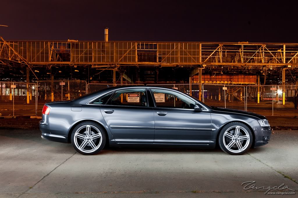

i saved them becuase they were fantastic pics
heres a few more
