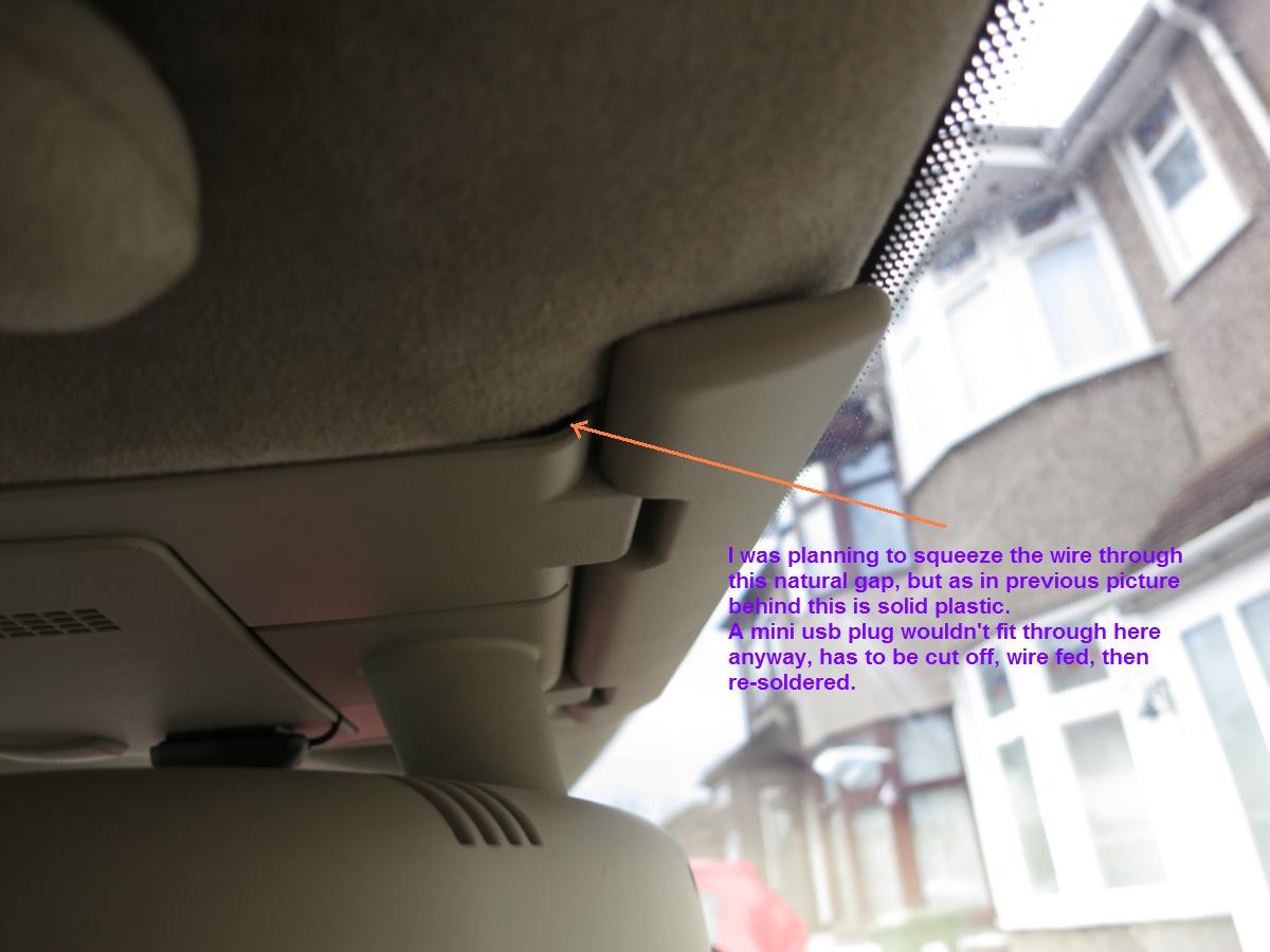

Yes this is a good idea. Looks like I may have to take apart the adapter for another reason anyway. The mini-usb plug is too large to squeeze past the reading lights surround trim and the roof lining. I'll have to chop the wire off, which should be able to feed through, then re-solder it to the regulator inside the cig lighter type housing.
I actually have a spare brand new roof surround trim so now I can see that where I was originally trying to squeeze the mini-usb through it was hitting solid plastic. I still can't figure out whats holding the surround trim on so tightly even with bolts removed. it doesn't actually touch the mirror arm at all, once the little square mirror trim is dislodged the rest of the surround should be able to move.
On my spare trim it is made up of two pieces sandwiched together loosely with lots of plastic tabs that protrude through the top layer. Looks like the roof fabric is sandwiched between these two, I hope they are not plastic-welded together pinching the roof liner permanently.

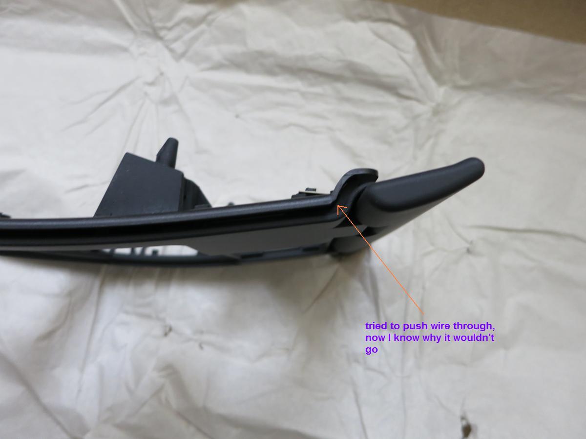

Here are some pictures of my attempted charging wire placement. The whole purpose of this seemingly un-necessary faffing is to hide the wire as much as possible, I simply hate the sight of any dangling wiring.
I am a bit stuck but I am sure there is a solution. My biggest problem is that the roof console trim surround is sandwiched around the roof lining and then plastic welded, that's why it won't come out even with bolts undone.
That's kind of ruined, or made very difficult my plans to change the beige trim to the black trim I bought. I think it is possible by carefully cutting off the welded tabs, but very very difficult without much room to manouver tools up there.
As for the wire, I will find some place to feed it through.

I pushed a wire between the lining and the windscreen which then hangs down to the camera which is mounted on a windscreen sticky pad behind the mirror.
The wire is actually a twin core cable with camera +ve and earth.
There is plenty of room above the lining and to either side of the roof electronics for the 12v to camera voltage dropper.

So you squeezed the wire past the roof lining at the top of the windscreen? I'll try that too seems to be much easier than what I'm attempting.
I was worried about leaving a permanent bend in the roof lining from the wire, but maybe it will be fine.

Thanks
The lining doesn't look distorted at all. That's where I'm going to feed the wire through too, and discard my other ideas about cutting the cable and trying to get it between the lining and roof console trim.
