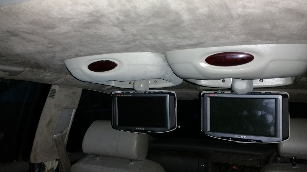

I kinda see the theory behind having two screens, but it was never going to work properly. The multimedia kit has cables of very specific lengths, meaning the one on the left was never going to reach the boot area properly, and then they are both transmitting on the same IR channel, and there's no headphone socket and theres only 1 DVD changer, so its not like they can really watch different things, so, er, its got to go.

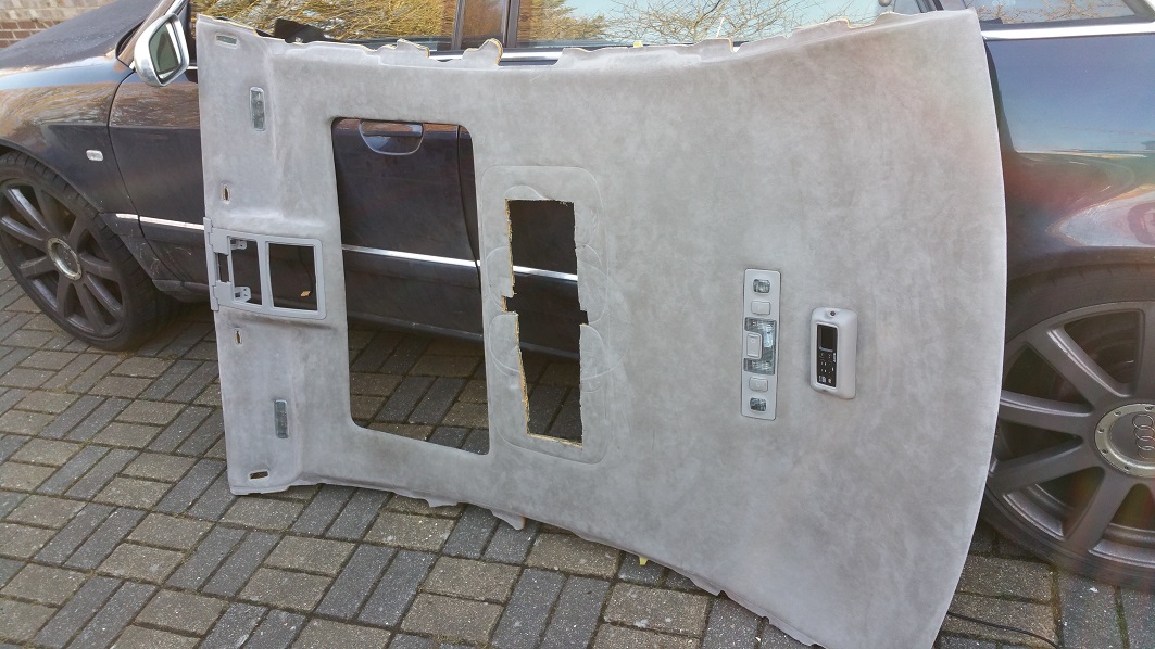

Removing the screens is going to leave a huge mess of roof lining, so the whole lining has to come out. This needs replacing with the new one. At the same time, I can inspect the heated windscreen retrofit to see if anything is salvageable.
So, it comes in this order: Rear seats out. C pillar trims off. Door sill trims off. Lower B pillar trims off. Upper B pillar off. Grab handles off. Pull the 4 release cables. Rear curtain airbag trim off, front curtain airbag trim off. Then carefully separate from the sunroof clips and finally sunvisors / sunroof & light control. Then pull the roof lining down vertically at the front, and when all side clips are released, push the lining back towards the rear of the car to unhook it. Piece of cake. Took me sub 2 hours in the dark on the driveway. Totally foxed me though as I came across some parts of the car that were actually still clipped together properly, which was pleasing.

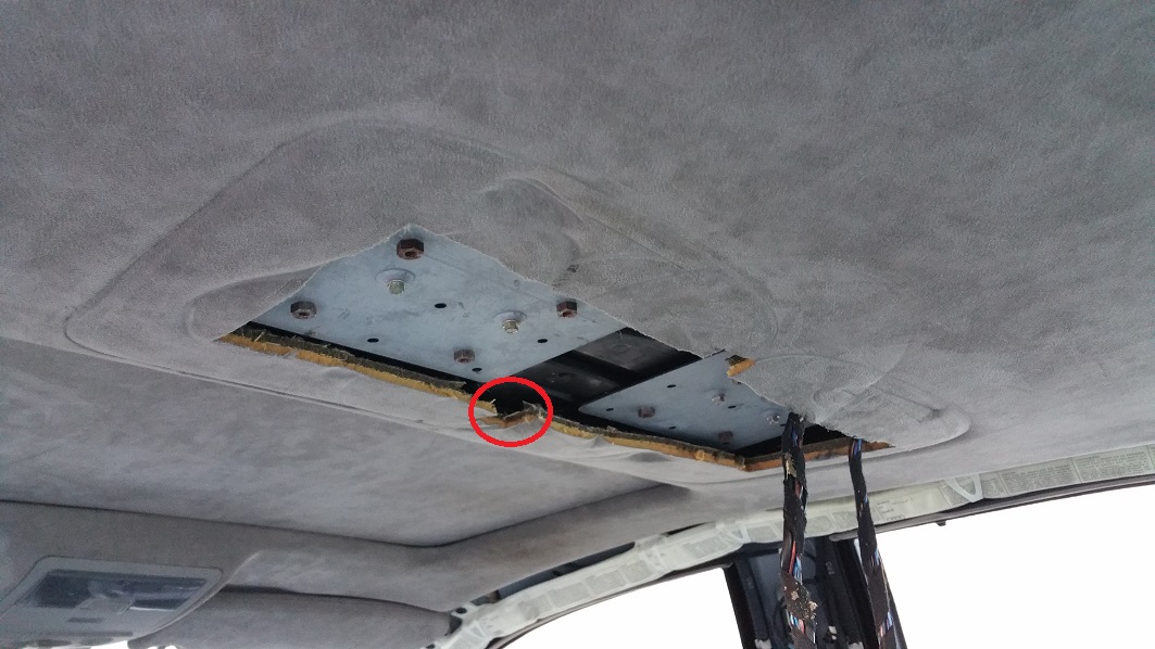

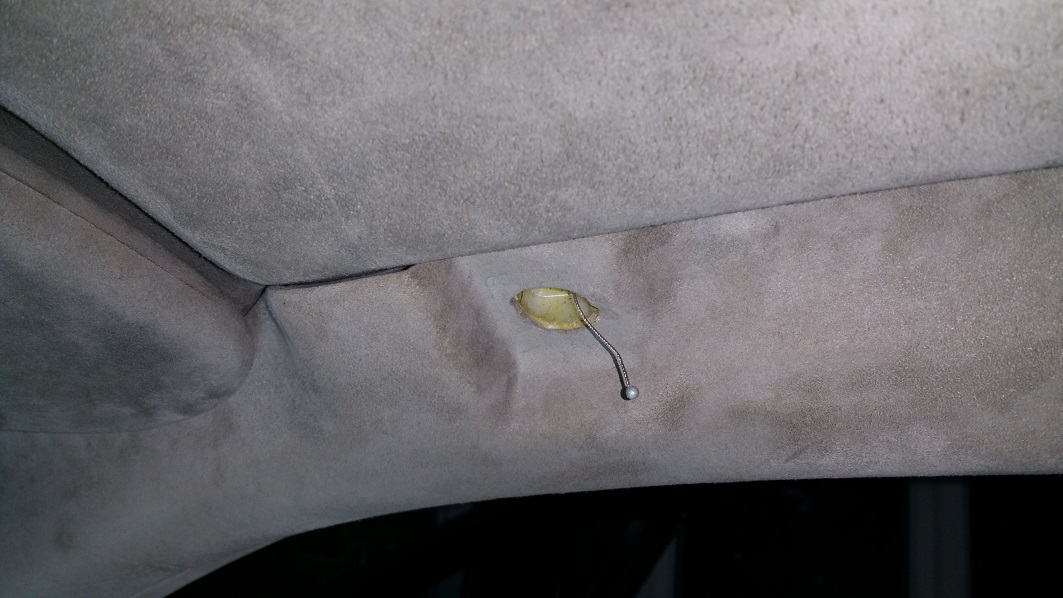

When the screens were removed, this was the hole left. Again, huge levels of weight saving here where the eye can't see. The red circle is representative of the hole the cable would normally go through, and a 2nd hole about twice this size would more then suffice to get the screws in place for the mounting brackets, but alas it seems hacking away acres of alcantara was the preferred method here....
Fortunately I'd already written this headlining off in my mind, but still seems a shame.

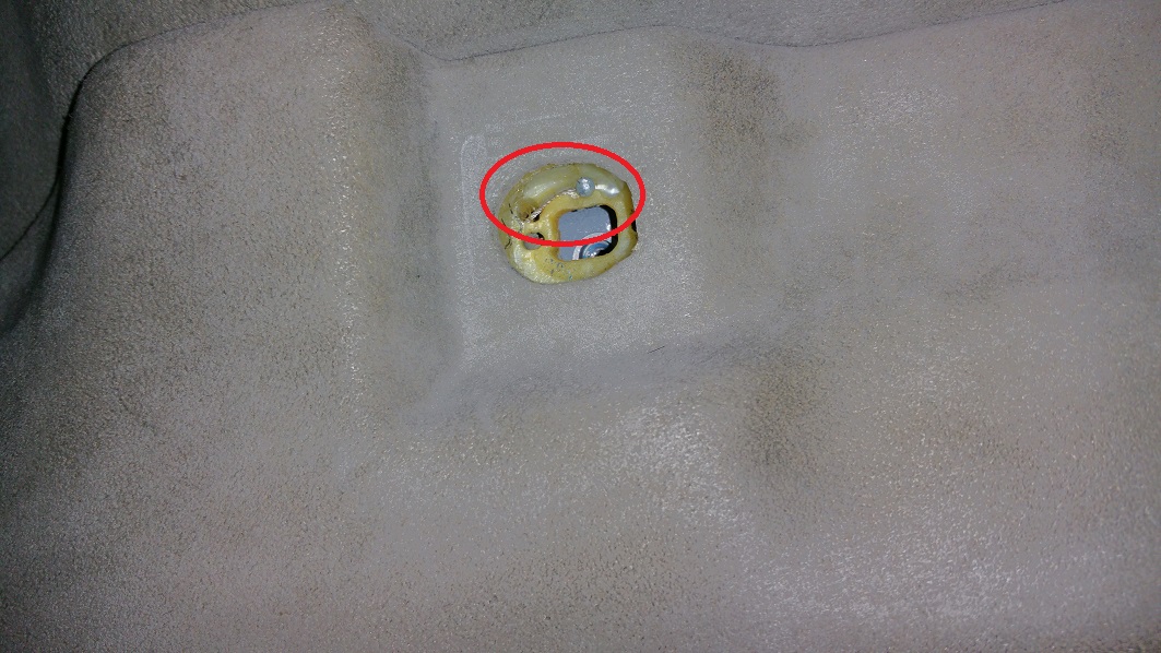

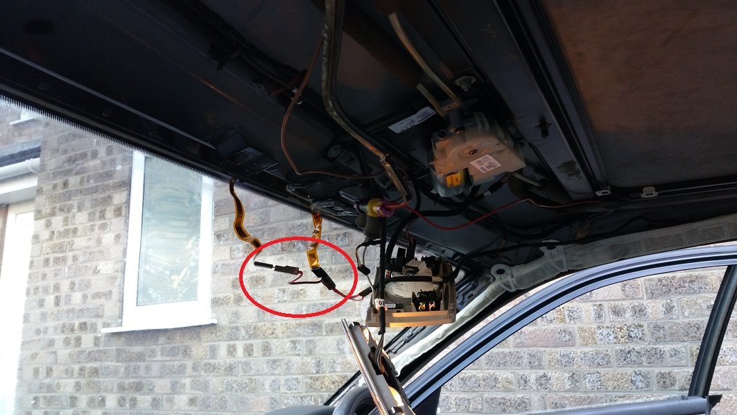

This is more interesting. The wiring from the rear of the car to the screen isn't as bad as I first imagined. Here, the positive connection for the screen is run from the rear of the car, all the way down and is happily connected to the top of the screen.

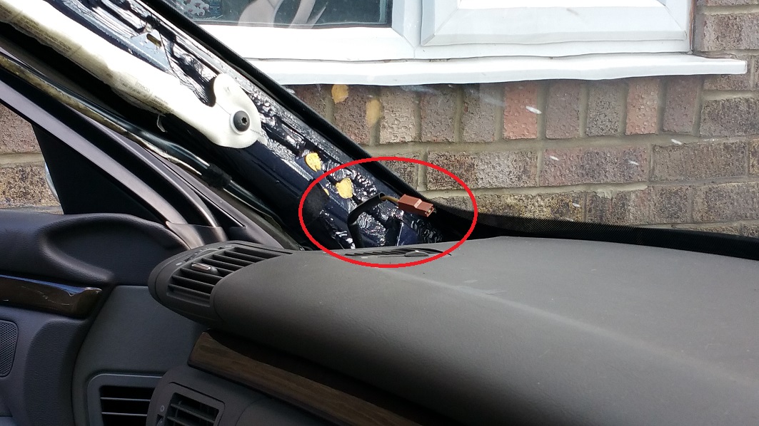

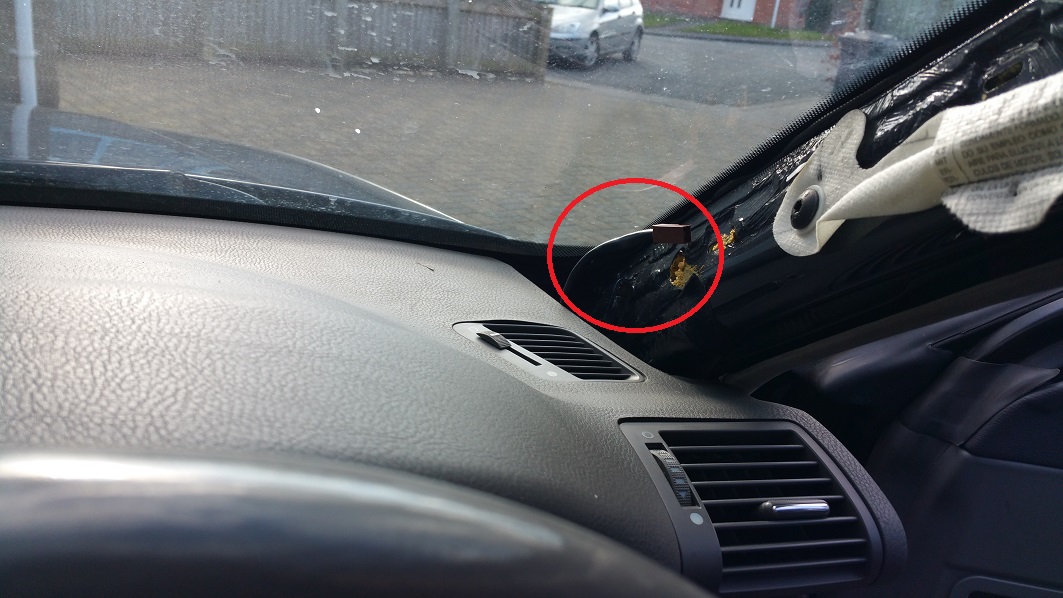

I cant say the same for the negative connection though as bizarrely it seems to have made it 95% of the way, and then stopped short popping up at either size of the dash:

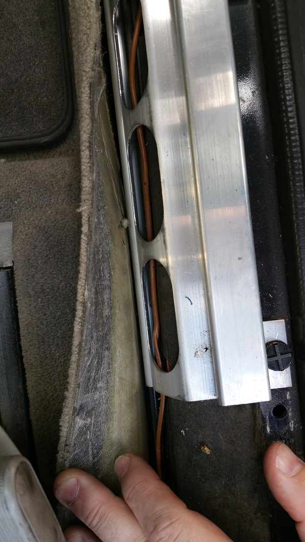

It also takes a rather dodgy route, rather than going inside the nice cardboard lined protected channel, it instead chooses to be rammed just inside the metal bracket, rubbing against it nicely....
Needless to say, it will all be ripped out....

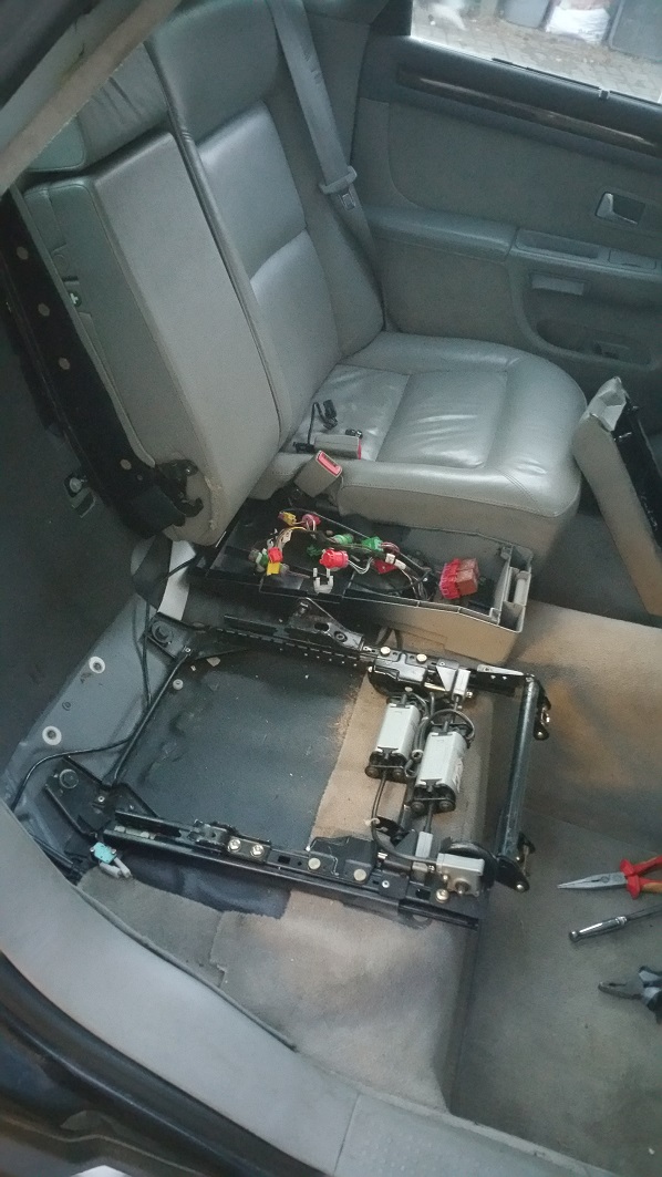

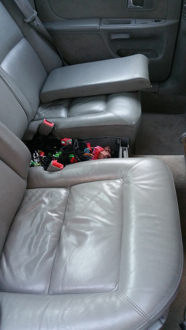

This is actually an earlier photo, from beginning to remove the rear seats. This is starting to unplug the mass of wires from the central wiring box:
and the first seat removed.... turned out to be pretty easy as it wasn't even bolted in.... <sigh>
Looking pretty bare now. Also means I have access to replace the diversity aerial switcher which has failed (common problem) and fix the broken armrest too.
One dead roof lining:
