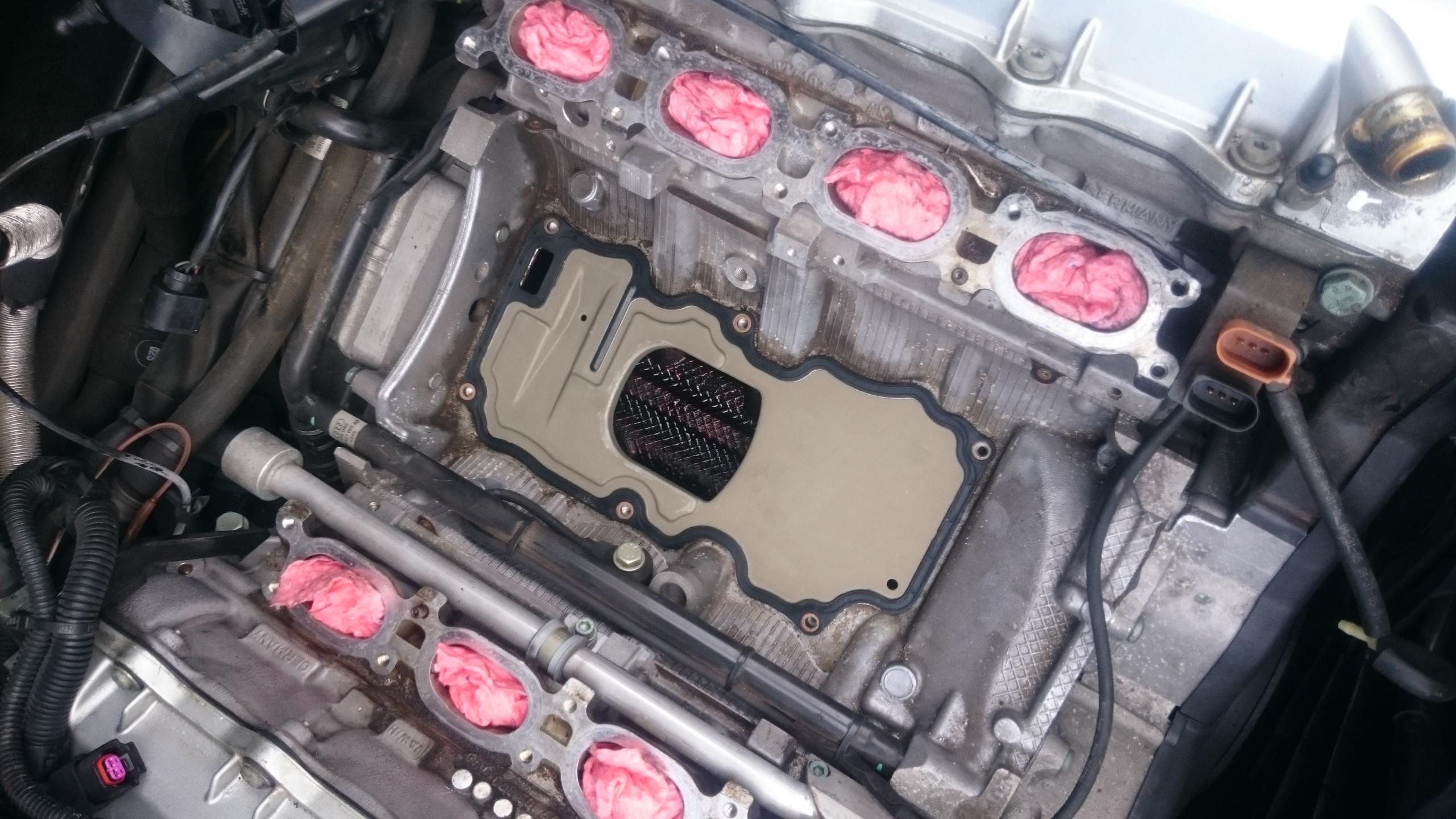

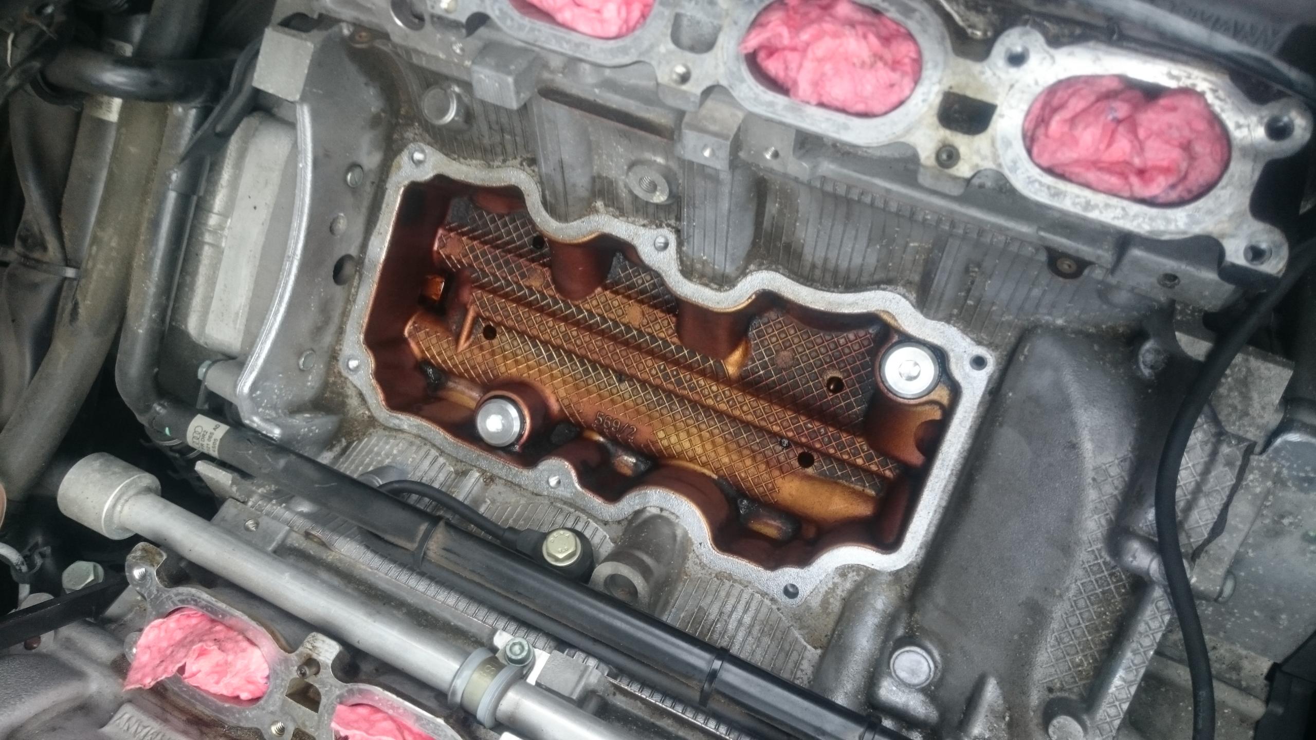

In the meantime I have a found document released by Audi here on the forum, I'm pretty sure it was in the D2 section, listing all the engine which can develop or have this specific noise, but. There was a lot of V8 listed but the my BFL engine wasn't on this list so I called my mates who both are ex Audi master technicians and the last thing which could caused this such noise where non returning oil valves under the intake manifold, so I went to Audi and ordered both valves, bot manifold seals and the seal plate.
Approximately 2.5hours later job was done, but I wasn't convinced this will sort the problem purely because the valves I have removed seemed to be fully working

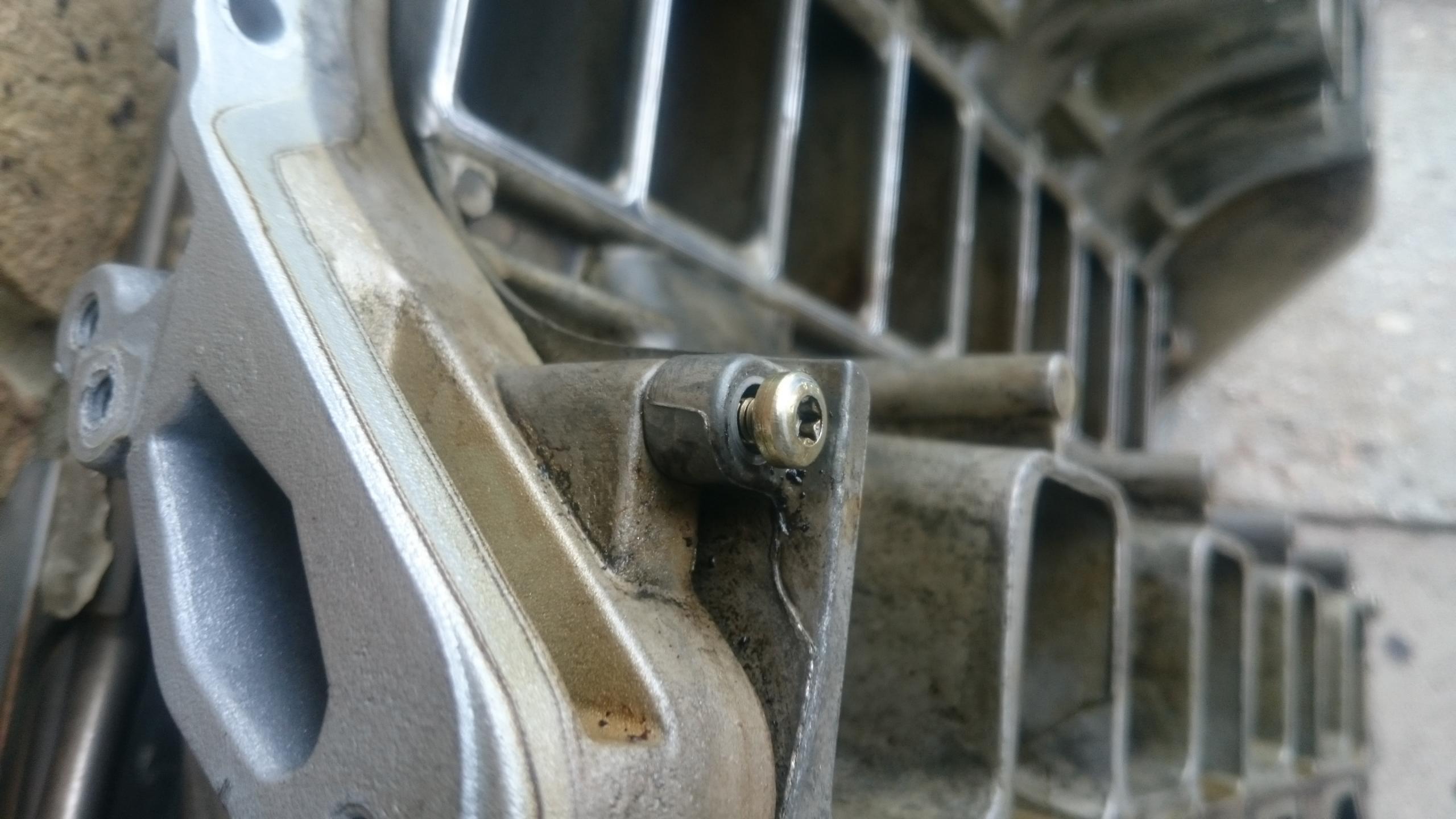

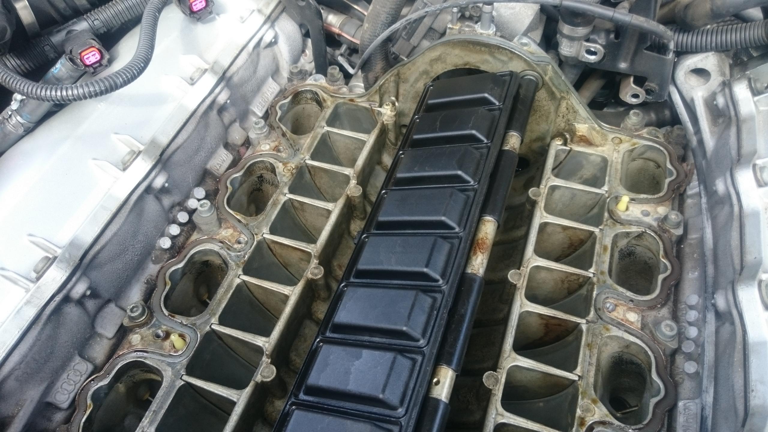

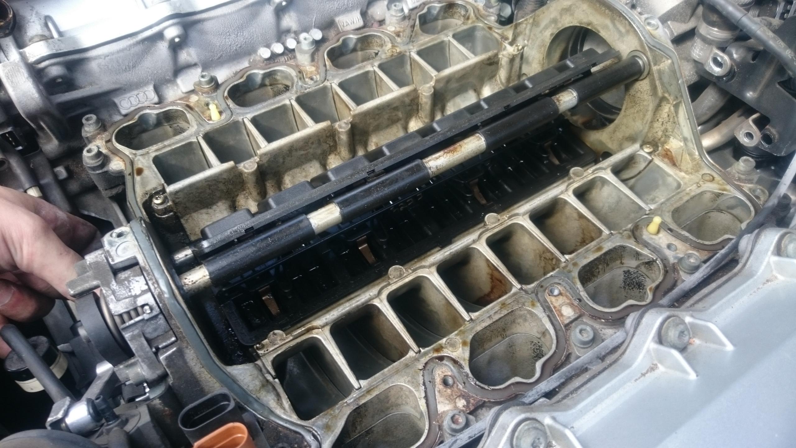

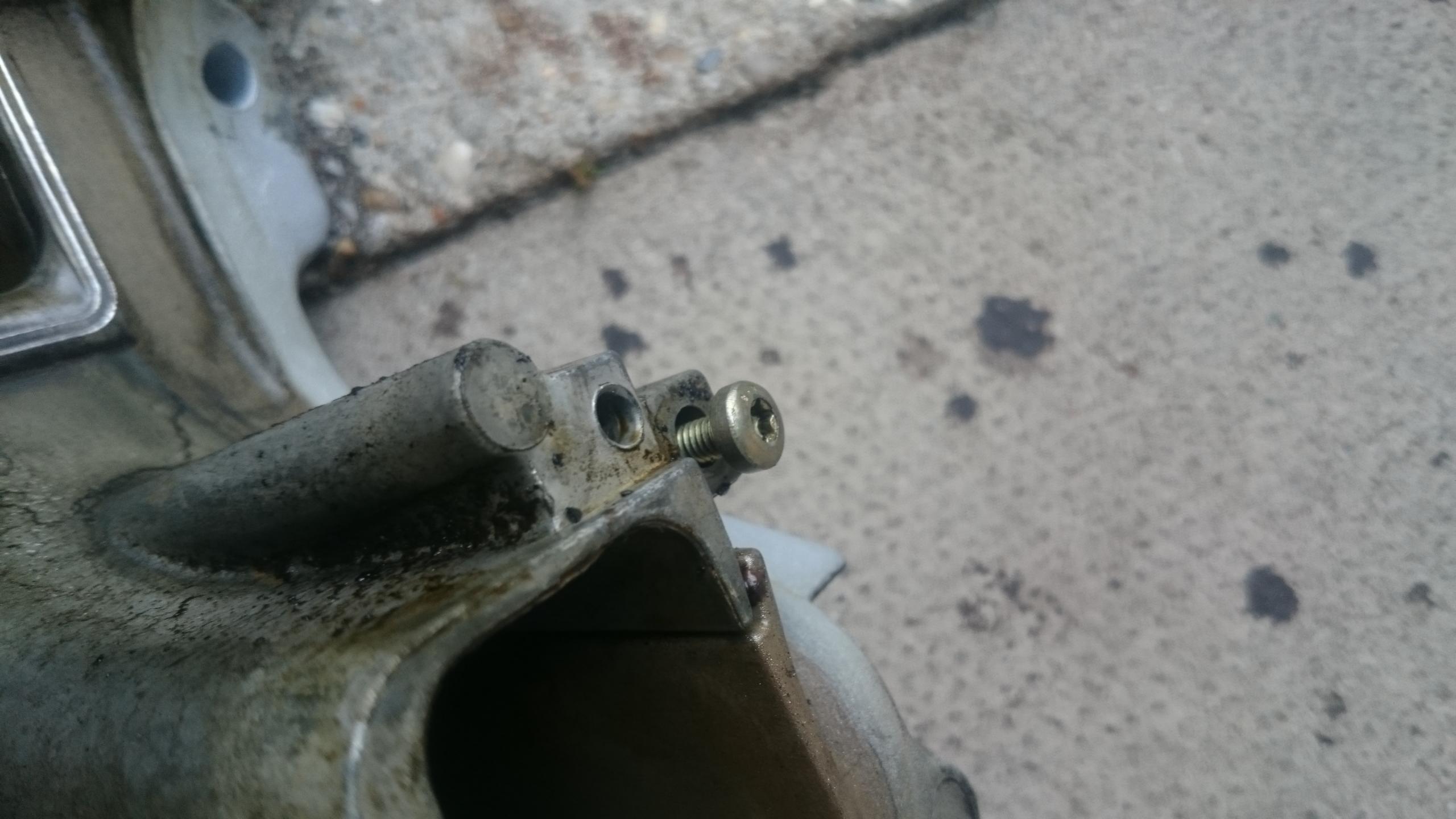

In the meantime, I wanted to take the manifold apart and just see the condition of it and how the exhaust manifold flaps are working and I was shocked when I saw all 4 little torx screws loose, one really badly and all other 1/3-1/2 out. I've tighten them up to the recommended Nm setting and I putted all back together. For a second I thought that this is what is causing the noise, but I've been reassured over the phone by Audi guy that this wouldn't cause this noise.
You will see 3 photos there for manifold flaps, 1st the closed position, 2nd one with one open (approx 3000rpm) and 3rd one with the other one open at around 4000rpm up.

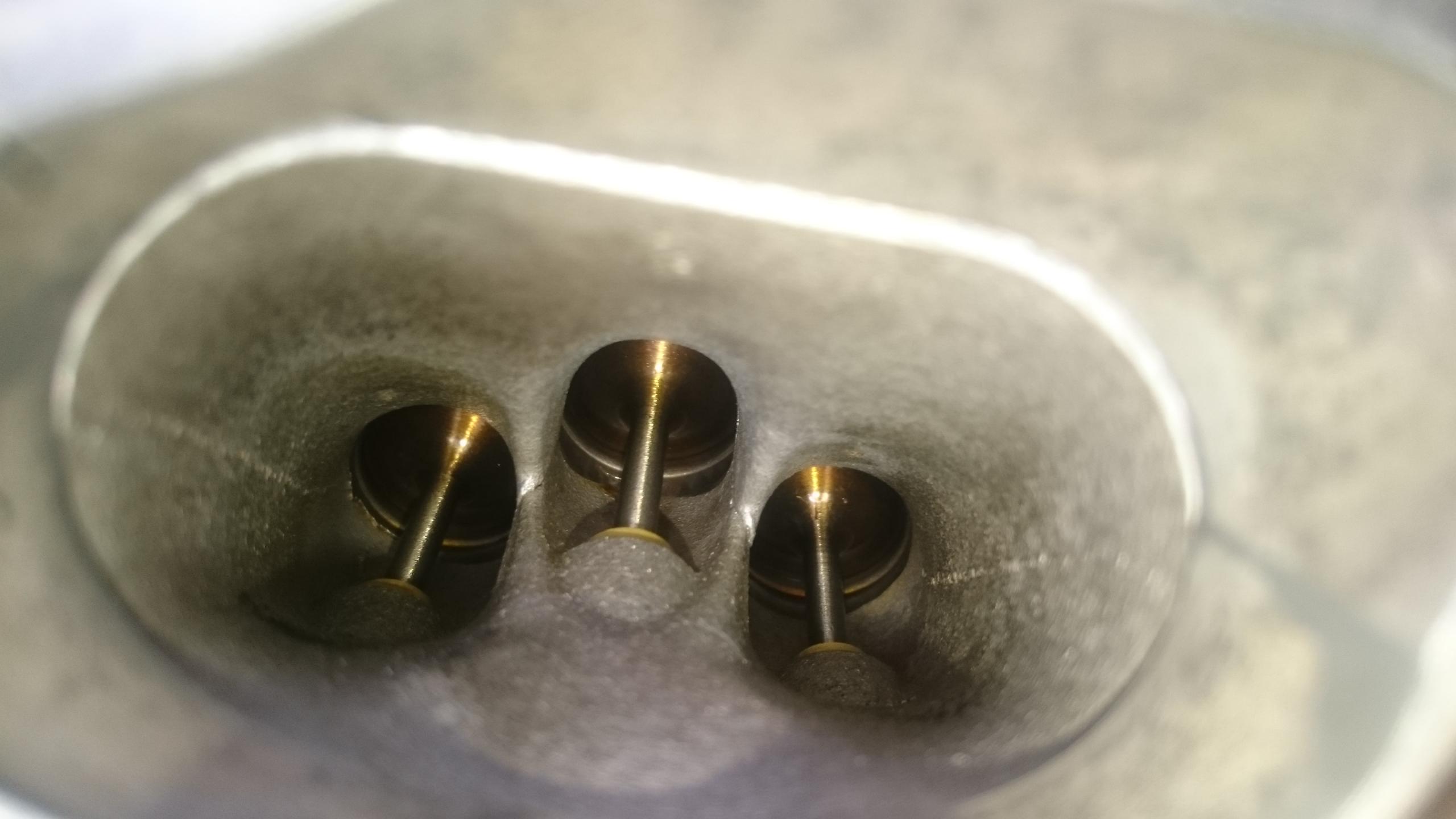

I'm not sure if I should be impressed, but the intakes and valves (top) were nice and clean as per last two photos.

I've replaced both intake seals, both valves and the seal plate, all info to what Nm you need to tighten the valves, plate and manifold bolts can be found in the D3 Tech Dump section thanks to Del
