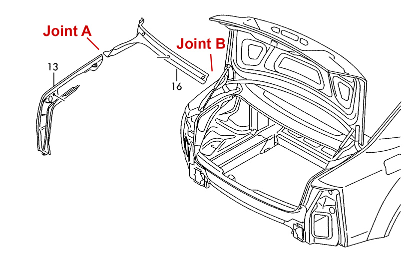

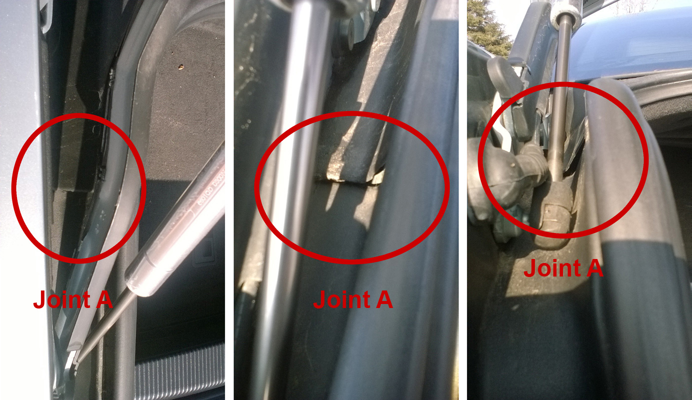

I do get a small amount of condensation on my rear glass, as said earlier my window seal and interior is dry so I don't think they are the cause. Yesterday however I noticed that the weather strip around the boot doesn't have a very good seal between parts (joint A left and right, and centre joint B) and I'm wondering if this could be an ingress? Although there's no visible water anywhere. If I can next weekend I'll remove the weather strips and see what's what behind them.
