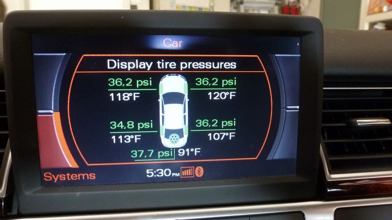

ScottD3's Avatar
ScottD3 ScottD3 is offline
Location: Plymouth
Posts: 1,888
I guess it does.

Old 10th March 2016, 12:27 PM
Location: Norwich & L'viv
Posts: 1,679
I wonder if the spare wheel sensor is detected through the rear seat bulkhead by the control module, since that lives under the back seat?
I read yesterday that one of rear aerial reads both the RL wheel and spare. Can't for the life of me find where I read that to quote the source.
Matt
Old 10th March 2016, 02:00 PM
Could that explain that A8 specific ECU vs A6 ECU would increase the range of the aerial for RL wheel aerial to pick up spare if all wired correctly ??
