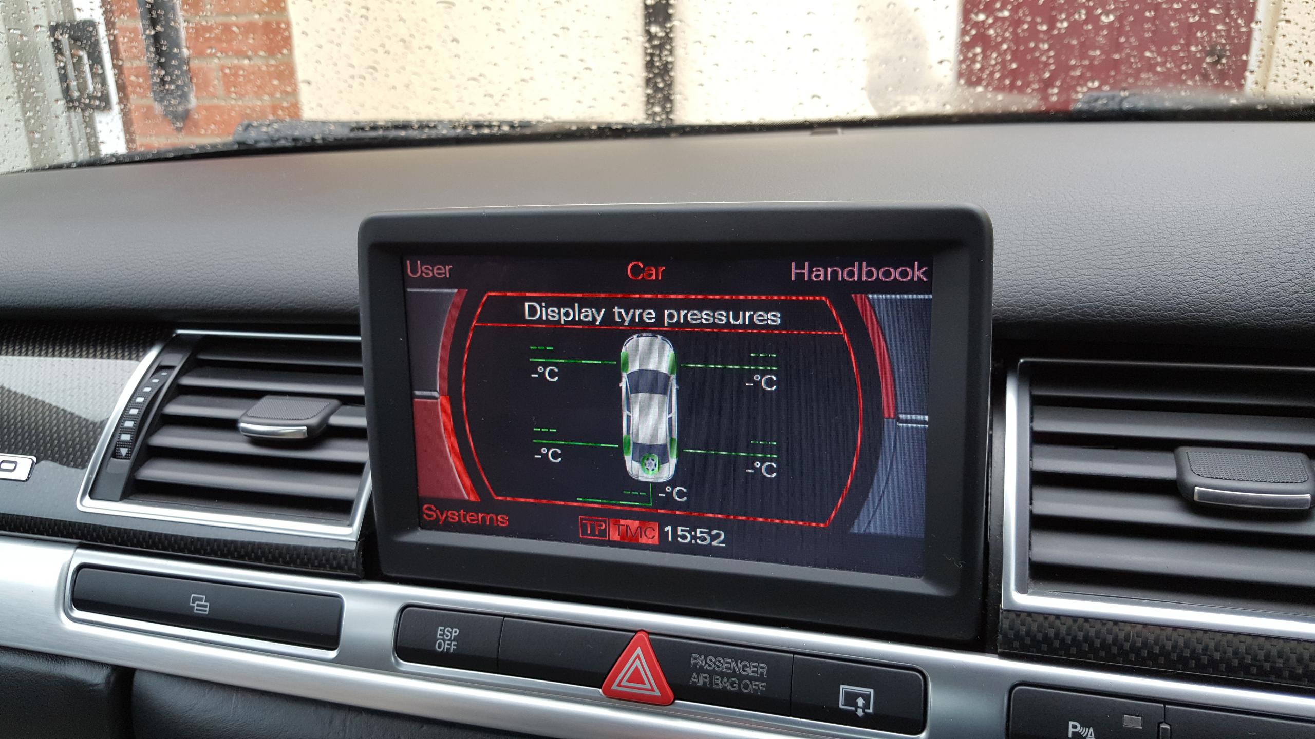

Alright lads.
Had new tyres put on today so changed the old dead tpms units for new ones.
Im having trouble getting them to register.

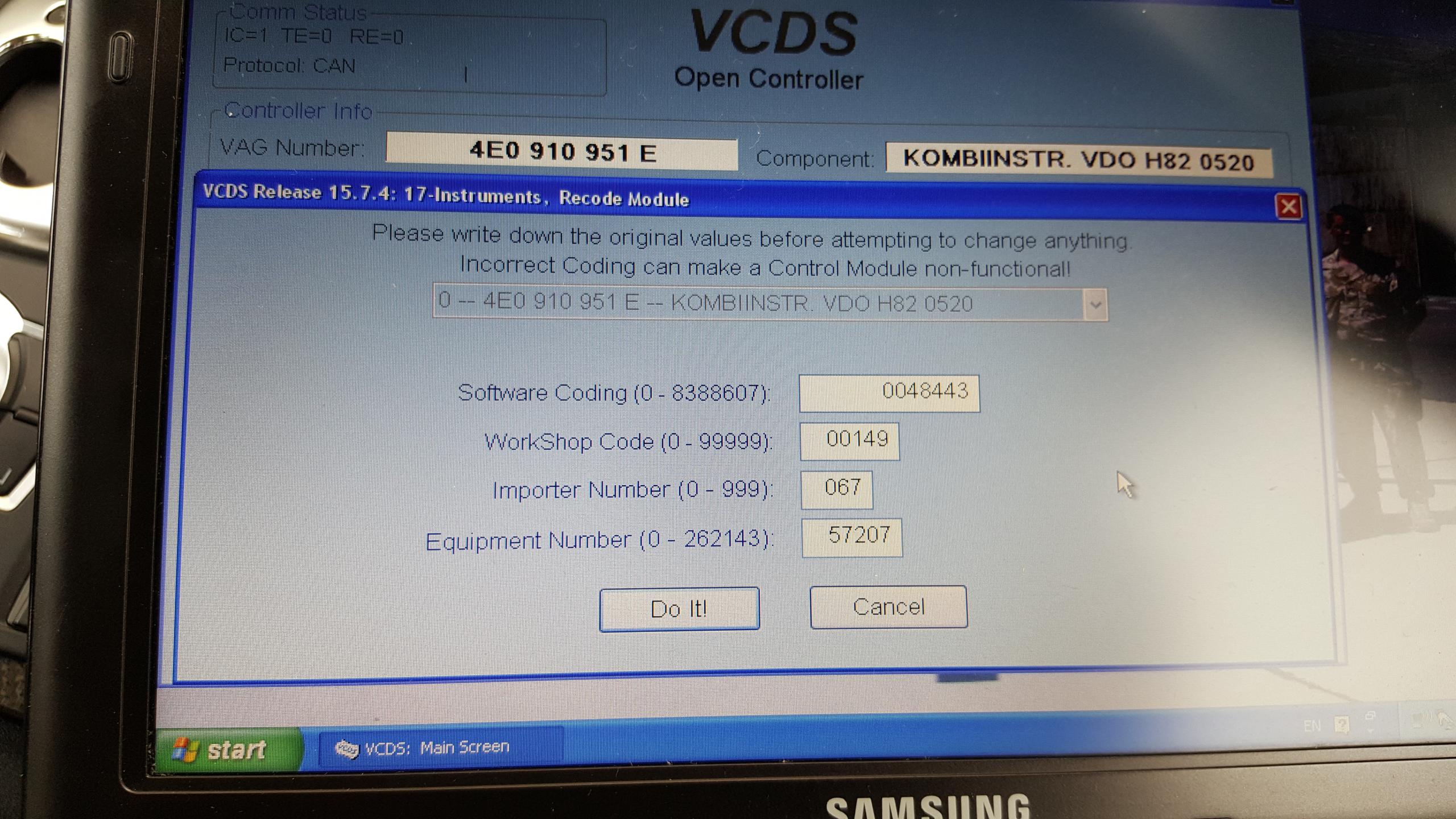

Can someone do me an idiots guide to enabling and coding in vcds pretty please.
This is what i have at the mo showing
Lovage xxx

Coding on that screen is fine, you need to check coding in 17 instruments first pair of non 0 digits should be 48
Also check the coding in control head if you are missing the menu item from the systems dialogue on the mmi
Once you have that all sorted go into the tyre pressure menu and choose initialise then go for a decent drive
Good luck

Yep all that is good.
So its a case of give it a drive? Came back across town once wheels were done. Should i hit the dual cabbageway later?
Its telling me to put key in and turn ignition on to configure the system, could it be do that and wait for 5 or 10 mins?

Old 9th April 2016, 03:15 PM
From starting the process when I did mine yesterday it took a 15min approx drive to get it to register.
