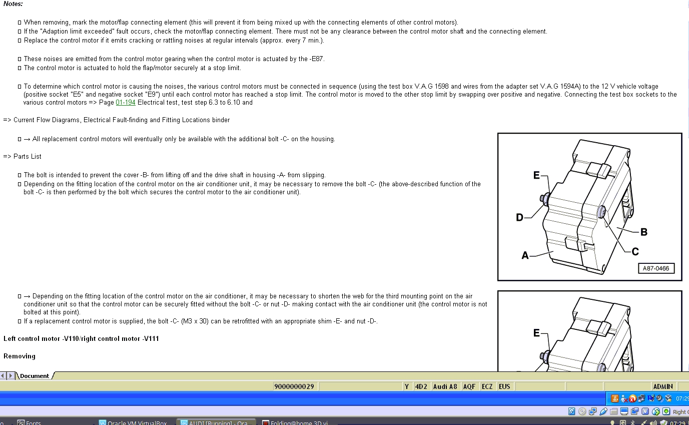

See this post that Adrian and I commented on:
http://forum.a8parts.co.uk/showthread.php?t=4786
Please find two attached screenshots from ELSAWIN.
PM me if you want access to my ELSAWIN running under Virtualbox, and I'll let you remote in, if that helps?

I think (if I remember correctly) that there are 4 motors on each side of the console, plus the other one that Adrian mentioned under the bonnet which seems to be a different part. Don't take this as gospel, but judging from all my rummaging around, the 4 motors seem to be similar. I ordered one from the forum sponsors in order to replace my faulty clicky-clicky unit.
Just like IT said, you can normally feel the clicking if you place your hand on each motor in turn if you're unable to echo locate it like a dolphin lol - that's exactly what I had to do in my case.
