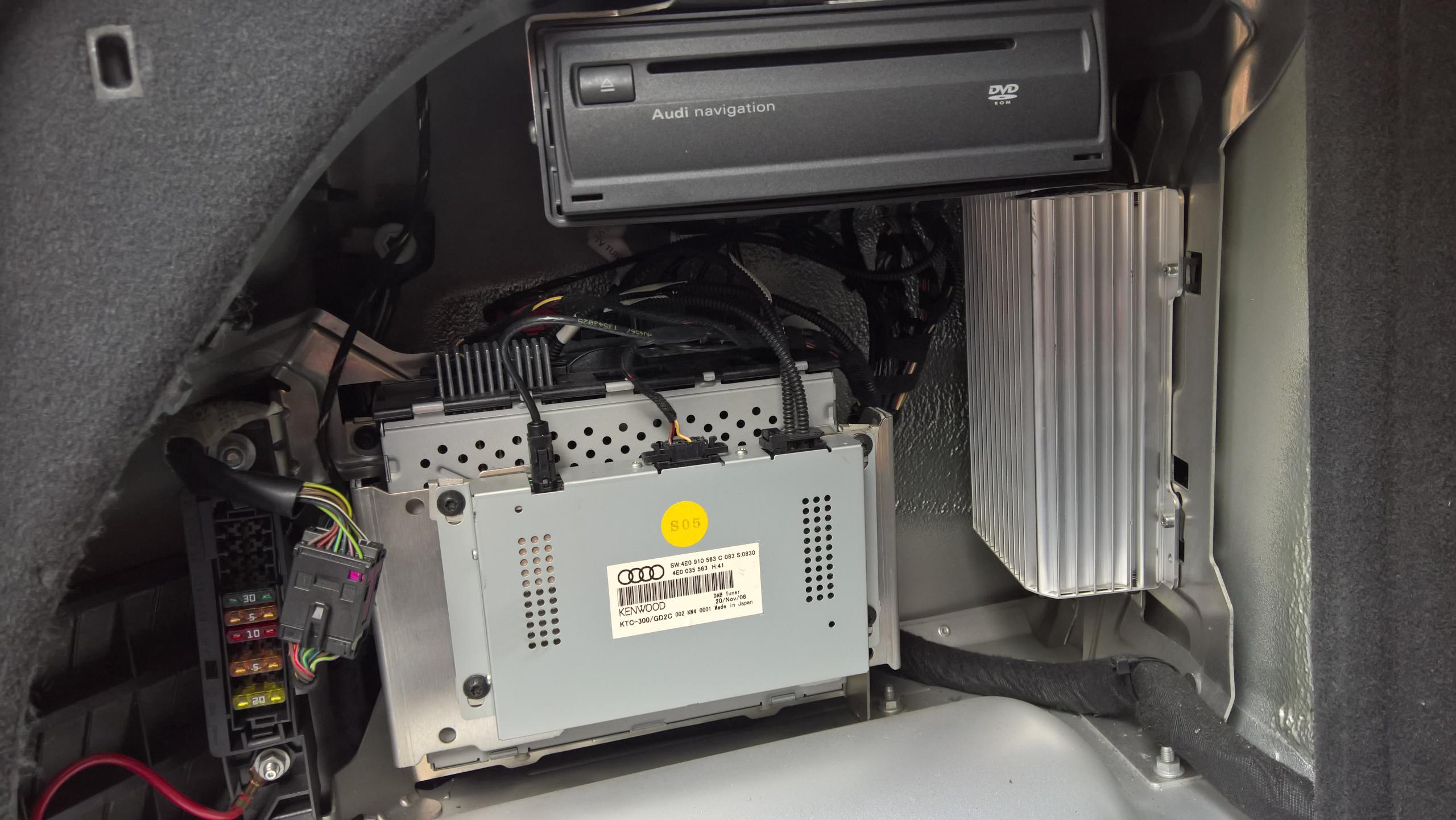

First bit of confusion! I have the DTV module and can select av1 or av2 from the mmi but where is the plug to connect the Av leads to? I understand it to be a 20 pin plug. Picture attached of my boot in the area I believe it should reside.

The red one at the back of the boxes on the left (behind the cooling fins for the speech dialogue system.
Thank you - so it is right at the back!

you can get to it by loosening of the dvd bolts and lower it out of the way, then you just have enough room to get to it
