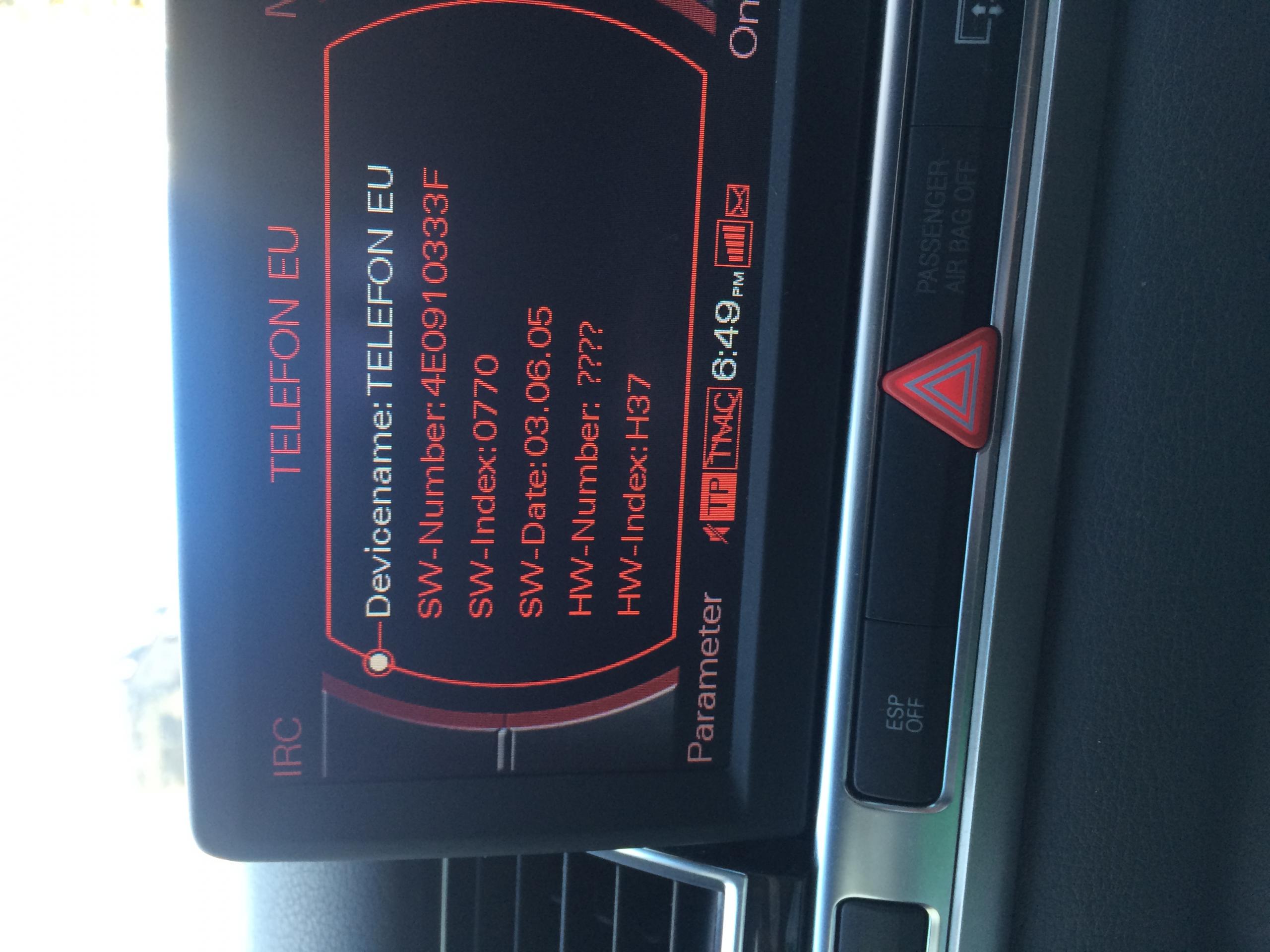

Julian is that a good thing or bad? Getting bit worried now. Shall I run cd3? I am attaching my phone SW
Neither good nor bad And your screen scan has explained a long time mystery
From various bits of info and your screen scan, I've now worked out that there were two different 2G MMI Bose amps in A8s. One was installed from 2002 until 2005 and a different one from 2006 until 2008 when the 3G MMI cars were built. You have one of the 2006-2008 amps. It would seem that Bose in the 2006-2008 cars was rare as that was when the B&O amp became available.
I believe only 2002-2005 Bose amps sometimes went into CP!
Your phone scan shows you have the original 'SIM in the arm' phone. Your firmware version 0770 is the latest and won't change at 5570. You also don't need to run CD2, the Bluetooth update CD.
If you run CD3 it will only take 10-15 mins.
Julian
