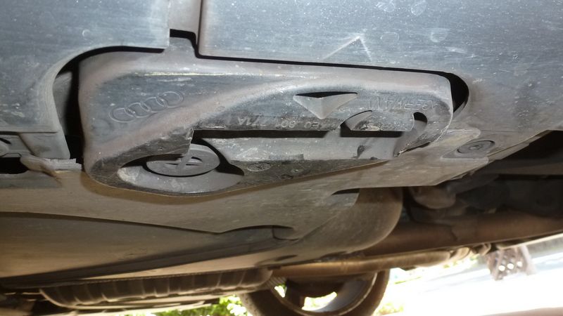

Lift on the MMI and then Jacking mode and theres even a slot for a trolly jack on the D3 and it's high enough you don't need to mess with the Audi Jack
Nice one - where is this slot please?

There's a slot for the curved Audi jack, and a circle right by it which my 2 tonne trolly jack fitted into nicely!
http://www.audiworld.com/forums/a8-s...cking-2849079/
Like the image on this site!

Old 25th August 2016, 12:14 PM
Posts: 1,669
Brilliant! Thanks for taking the trouble to photograph it!
I never noticed it due to just feeling for the slot with my fingers for the audi jack.

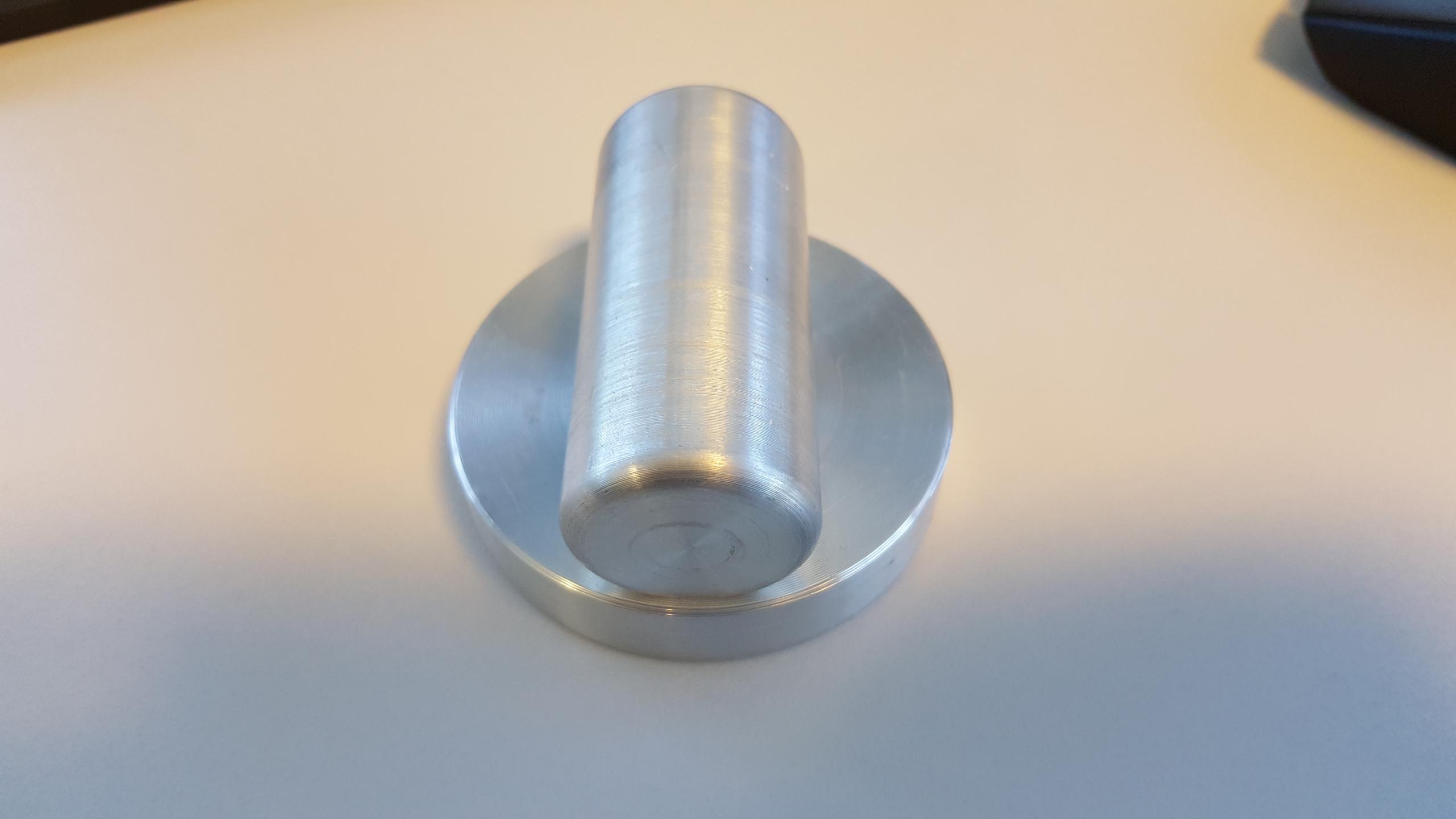

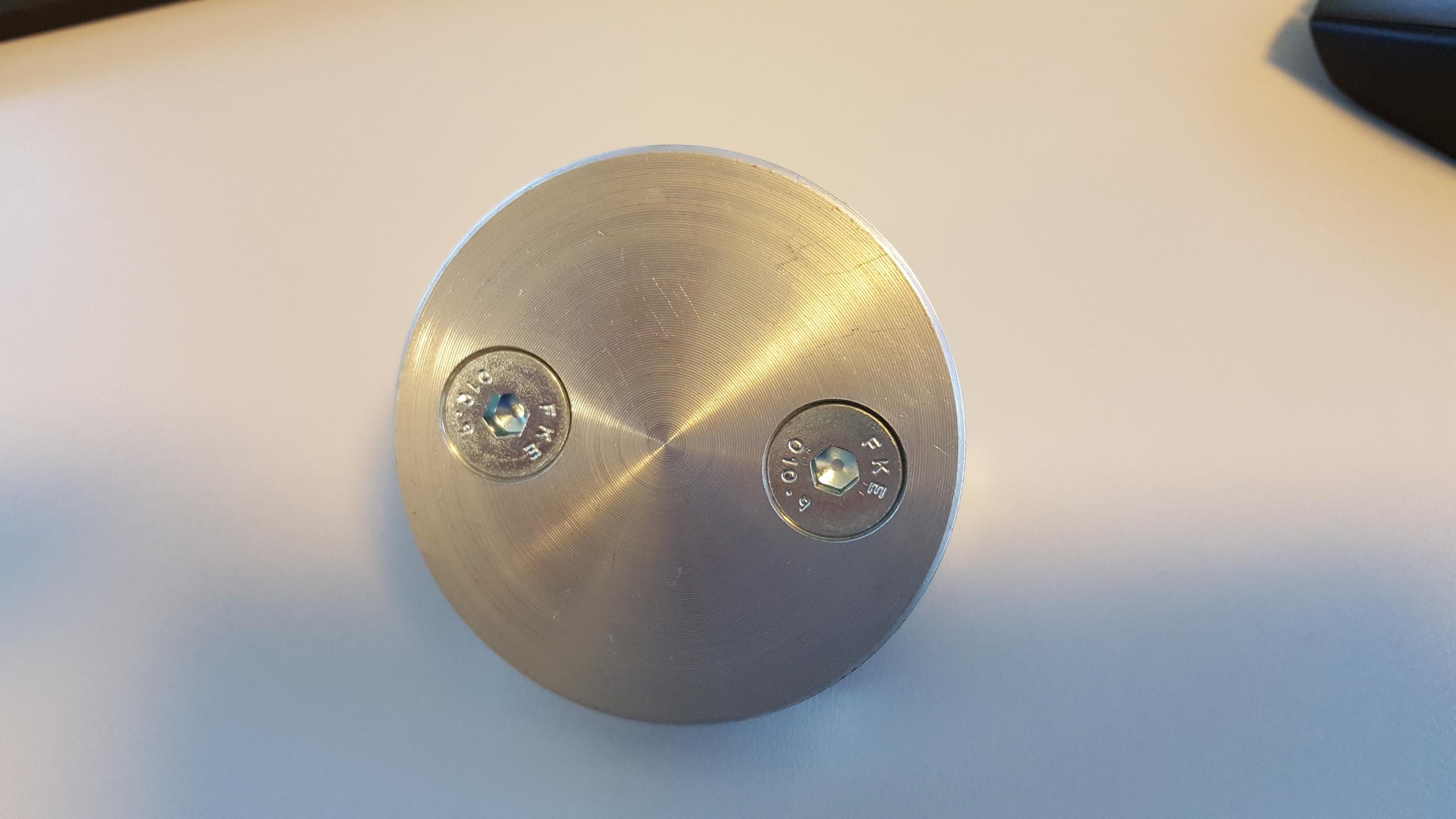

Just bought one of these for use on the D3 and with a trolley jack. Solid ally. Seems OK for 8 quid.

That looks good and well made....Any details?

Ooops. Sorry... Yes...
http://www.ebay.co.uk/itm/AUDI-R8-RS...MAAOSwiwVWSO1y
