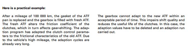

Maybe a silly question as both companies are well regarded professionals but have they done adaption procedure after oil replacement, see screenshot from Audi self study programme.

That quote from Audi sounds exactly like what's happened to mine, but Mackies tried to erase the adaption, to no effect.
