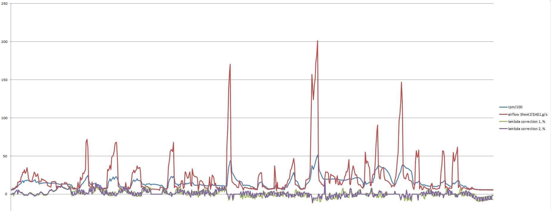

I've just done a quick log while driving. Not the best test data but it's quite hard to get through the rev range on public roads!
I logged the following fields:
- RPM
- MAF g/s
- Fuel Consumption - Signal (not sure what this is)
- Fuel Consumption - Equivalent (not sure what this is)
- Timing Retardation - Cylinder 1
- Timing Retardation - Cylinder 8
- Lambda Control - Bank 1 Sensor 1
- Sensor Voltage - Bank 1 Sensor 1
- Lambda Control - Bank 2 Sensor 1
- Sensor Voltage - Bank 2 Sensor 1
- Injector Timing ms

Old 5th October 2016, 09:59 AM
Join Date: Jul 2015
Location: St Helens Haydock
Posts: 434
Hello Matthew , using my mass air flow calculator im getting
640 rpm 6.7 g/s
2000 rpm 20.05 g/s
So we are loosing air.... or the reporting of air mass is off ( air mass meter ).... or air cannot get into engine (blocked exhaust route )
Does the car pull well if you put your foot down .....with blocked cats the more you boot it the more it will die a death from lack of flow
For it to affect idle readings the cats or exhaust would have to be pretty blocked which would kill mid and top end .
You say you have had a genuine air mass ......is this genuine audi part or a genuine bosch one from a motor factors or Euro car blaggers or somewhere ??
loads of Chinese copy supposedley gen. bosch air masses out there ........seen this a few times now ......under performing air masses affecting fueling ........seen over performing ones as well .......black smoke r us .
Try this i want to see if the lamdas are reading rich .............

Air flow is not as simple a s fixed value at certain rpm. There will be massive difference at 2000rpm depending how much throttle is open. There are some readings in the log around 2000rpm with 45g/ms and the highest reading is 201.28g/s at 5120 rpm so the values seem plausible.
Lambda correction seams to be all over the place from -11.7% to +18%
I have made a chart in excel, it does not look that correction depends on either rpm or airlow so really don't know whats going on.
