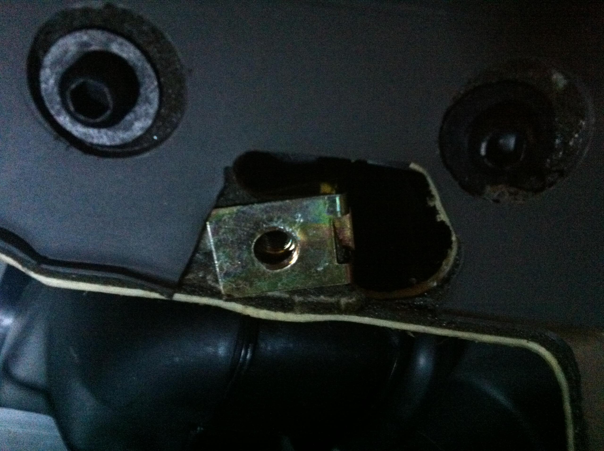

My broken fixing. This is what I'm dealing with. I think I'll try and epoxy a small panel behind what you can see. I'll locate the retaining lug first.

Yup, mine was virtually identical. I cut off some of the top layer of soft plastic material and then screwed/glued a strip of tough plastic to the fibre backing.
Think I just used very short self-tapping screws, but something with a fixing behind would be better; was plenty strong enough. ![]() See rather blurry picture posted earlier in this thread: http://forum.a8parts.co.uk/showpost....4&postcount=12
