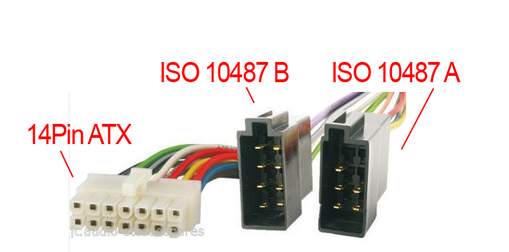

Not wanting to rewire the (now botched) plug I bought the audio adapter pictured below which has the right 14-pin connector on it.
I was going to cut off the two big sockets and just "graft/solder" it on to the loom (in place of the botched connector) but I'm wondering if I can buy plugs that fit those two sockets, anyone know what they are called? The actual cable is sold as "Kenwood Car Radio Stereo 14 Pin Molex Type Wiring Harness Loom Old Version ISO" so they may just be specific to old Kenwood equipment.

Old 21st October 2016, 10:27 AM

Many thanks Matty, so I need one of these now:
(might seem a bit complex but it will also add a bit of extra length to the loom which I really need)
