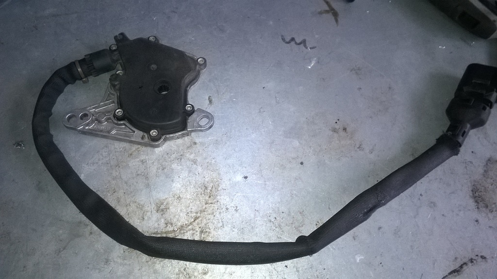

Yeah not really Not a 5 hour job!

Old 20th November 2016, 11:06 AM
Originally Posted by mikkijayne View Post
not a 5 hour job!
2.5-3?
  #90
Old 20th November 2016, 11:15 AM
Yeah thats more realistic. 38 minutes to take it out, including uploading a picture, but my car has no seized bolts. Allowing for nothing having been taken to bits before thats a reasonable figure.
My switch has the same bad contacts as the others so I'm going to clean them up, re-grease it & put it back together and see what happens...
