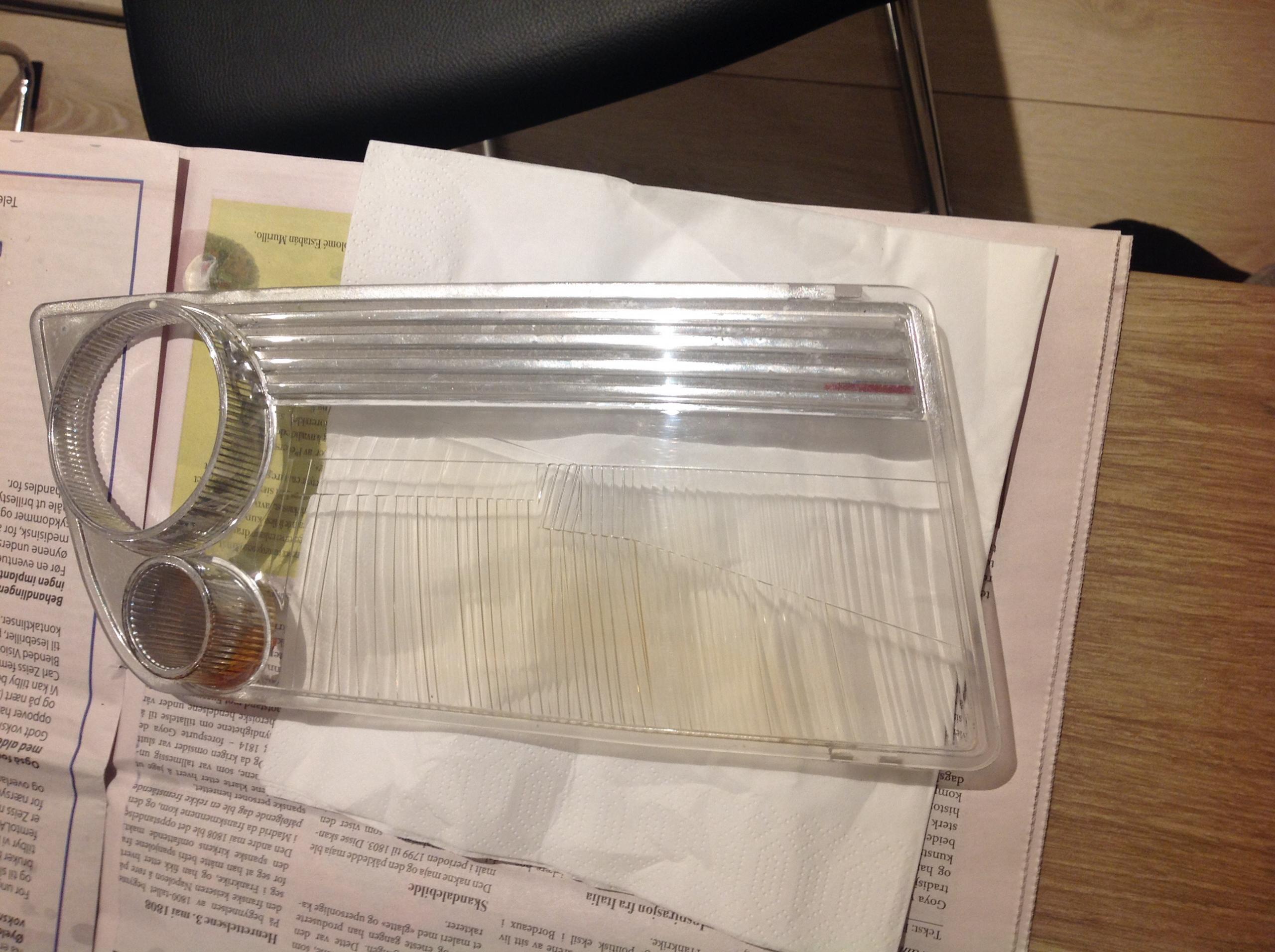

On pickup this afternoon they also informed that the headlights did not pass, as the dreaded plastic "cover" inside the BI-Xenons was to miscoloured... Anyone ever managed to get theirs clear again?
What specifically was the point of failure on that? They can object to the lights being different colours but I can't see how Xenons (unless really different) could be like that, or was it some other standard reason?

Checklist cotains 150 checkpoints and in regards to the headlights, it's enough for the control (freak) person to look at the yellow-aged plastic lens/cover and say this is not the way it should look.
Have removed them now in order to work some magic with all sorts of stuff found in my garag e

don't attack the silver painted bit with anything stronger than water - it'll come off. The inner lens should clean up a bit but to be honest they don't look bad
Have a look at my bi-xenon refurb thread if you haven't spotted it

MOT passed after removing the tint and polishing the ldl out of the plastic covers. Got a bit better but still a bit yellow-ish.
I did mine a couple of years back. There is a guide on this on Audipages IIRC. Got the internal lens covers much less yellow.
EDIT: Look in the stickies in D2 Lights - there are two, one for external lens polishing and then a thread from this forum which shows the internal lens cleaning procedure - http://forum.a8parts.co.uk/showthread.php?t=5817
Old 9th December 2016, 09:48 AM
More info in my refurb thread too
http://forum.a8parts.co.uk/showthread.php?t=9336
