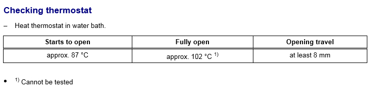

I agree with Marcin, pay the extra few quid and get it from Audi / TPS. In the overall cost it's only a slight % more. Are you going to change all the belts while you've got the front removed?

Thanks Matt, 87C sounds about right, the gauge sits at 90, but it's obvious there's a fair amount of 'signal conditioning' applied to the temp sensor to eliminate a wandering needle.
