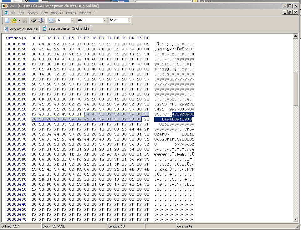

That error sometimes occurs when a remap has been done. Does that time stamp coincide with the original remap, if you have the history?
What does it show in Advance ID?
The ROM is the 93C76 which stores the odometer reading, CP data and the advance ID stuff. When viewed in a hex editor you can see all this information.
If everything works with the cluster I wouldn't be too worried.
