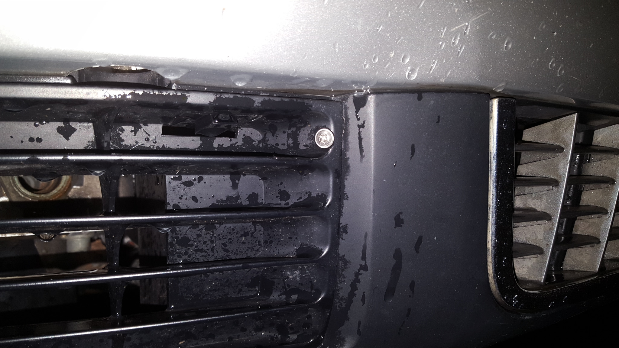

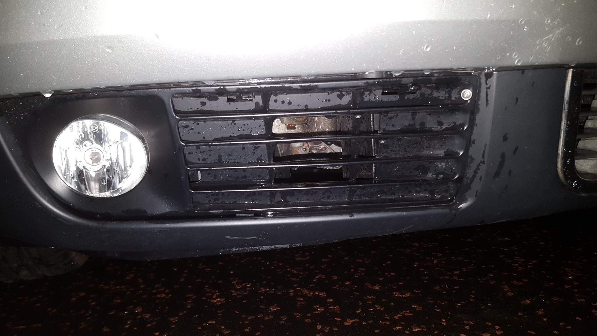

A couple of pan head stainless steel self tappers hold on to mine
ID:	15564   Click image for larger version

Mine is exactly the same but with black screws

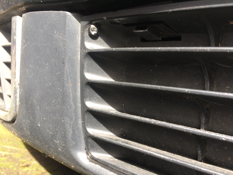

To save me crawling around and feeling the materials and behind, what's a good size and length to go through both layers and grip well without hitting anything it shouldn't?
  #46
Old 6th February 2017, 01:12 PM
10-15mm. There's plenty of space behind that surface. It only needs a small self-tapping screw - 4mm or so is fine.
  #47
Old 6th February 2017, 01:16 PM
HPsauce HPsauce is online now
Thanks.
The only suitable screws I have on hand are fairly short at 10mm thread so I'll give them a go first.
  #48
Old 16th February 2017, 11:31 AM
Job done, black 10mm screws both sides, nice and tight.
