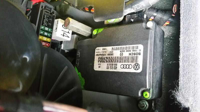

Old 18th February 2017, 03:19 PM
Posts: 2,341
Julian,
Unloaded the shopping and taken a photo.
Name:	20170218_125131 shrunk.jpg
ID:	15690   Click image for larger version
Name:	20170218_125141 shrunk.jpg
