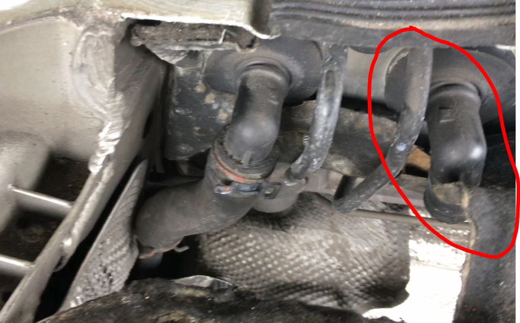

Ever made a picture of how it terminates in the cabin?
Old 26th February 2017, 12:47 PM
It terminates just before the bulkhead in the wheel arch. It's just a short S shaped piece so another joint/connection is on the wall of interior bulkhead.
Old 26th February 2017, 01:18 PM
I'm pretty sure that's where it terminates from what I remember.
Old 26th February 2017, 10:21 PM
daandaman daandaman is offline
Join Date: Oct 2015
Posts: 109
Hehe im doing my best but as my car is LHD I can't really make sense of that location. I must say that elbow looks like a heater core coolant connection... like the one on the left
