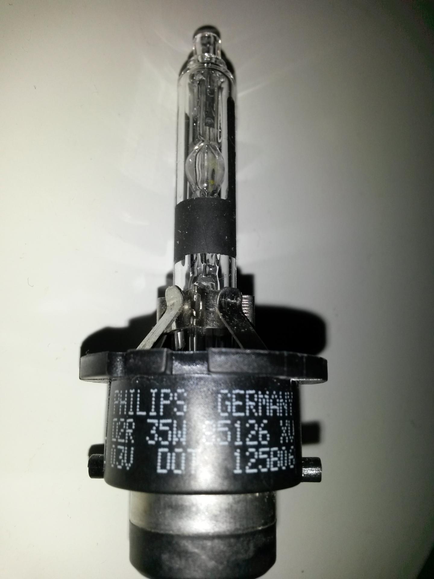

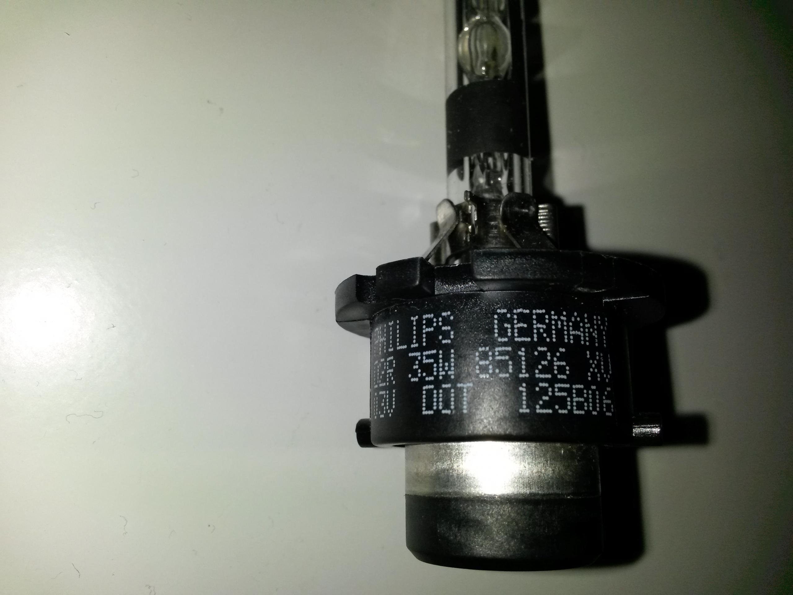

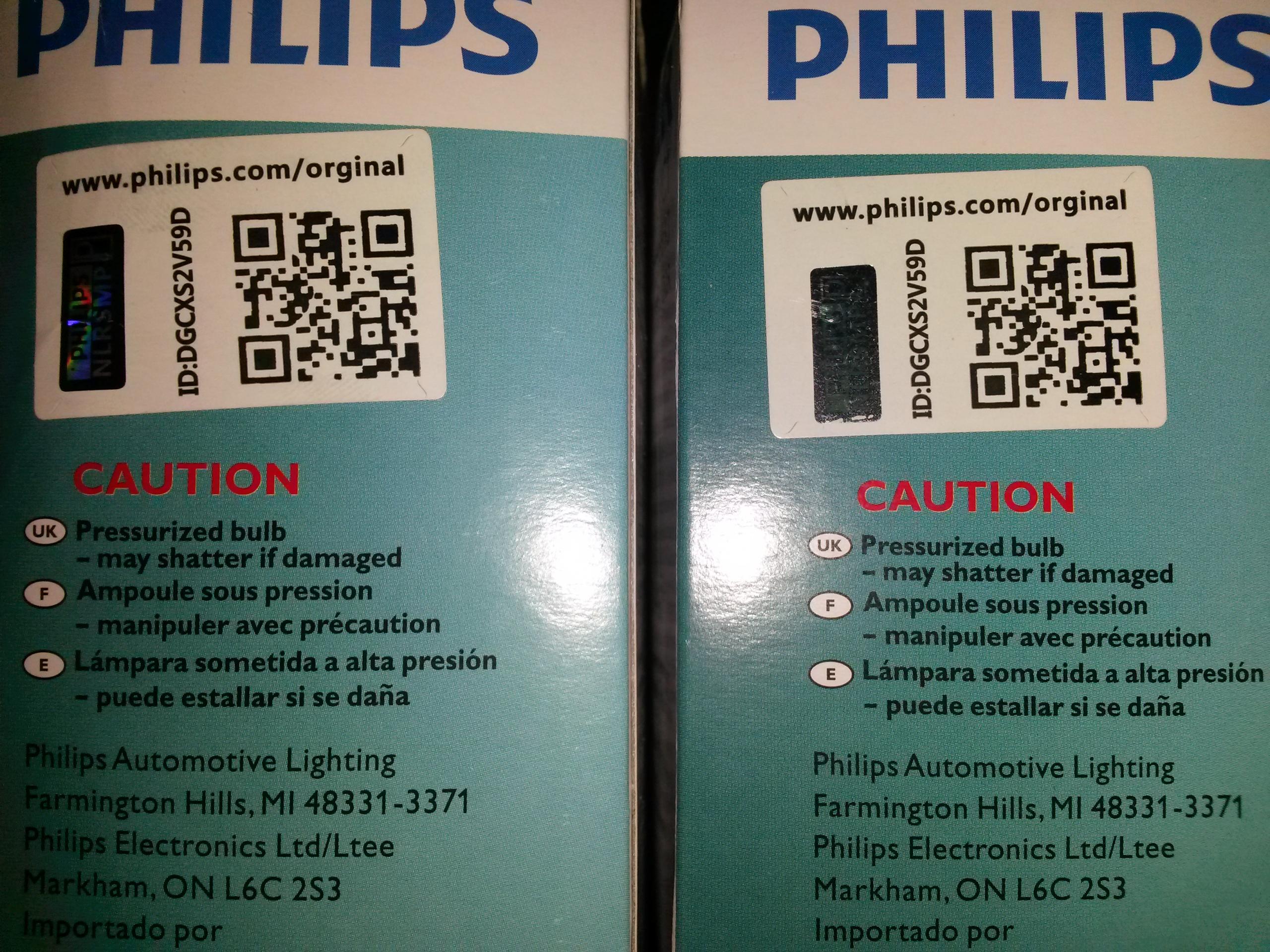

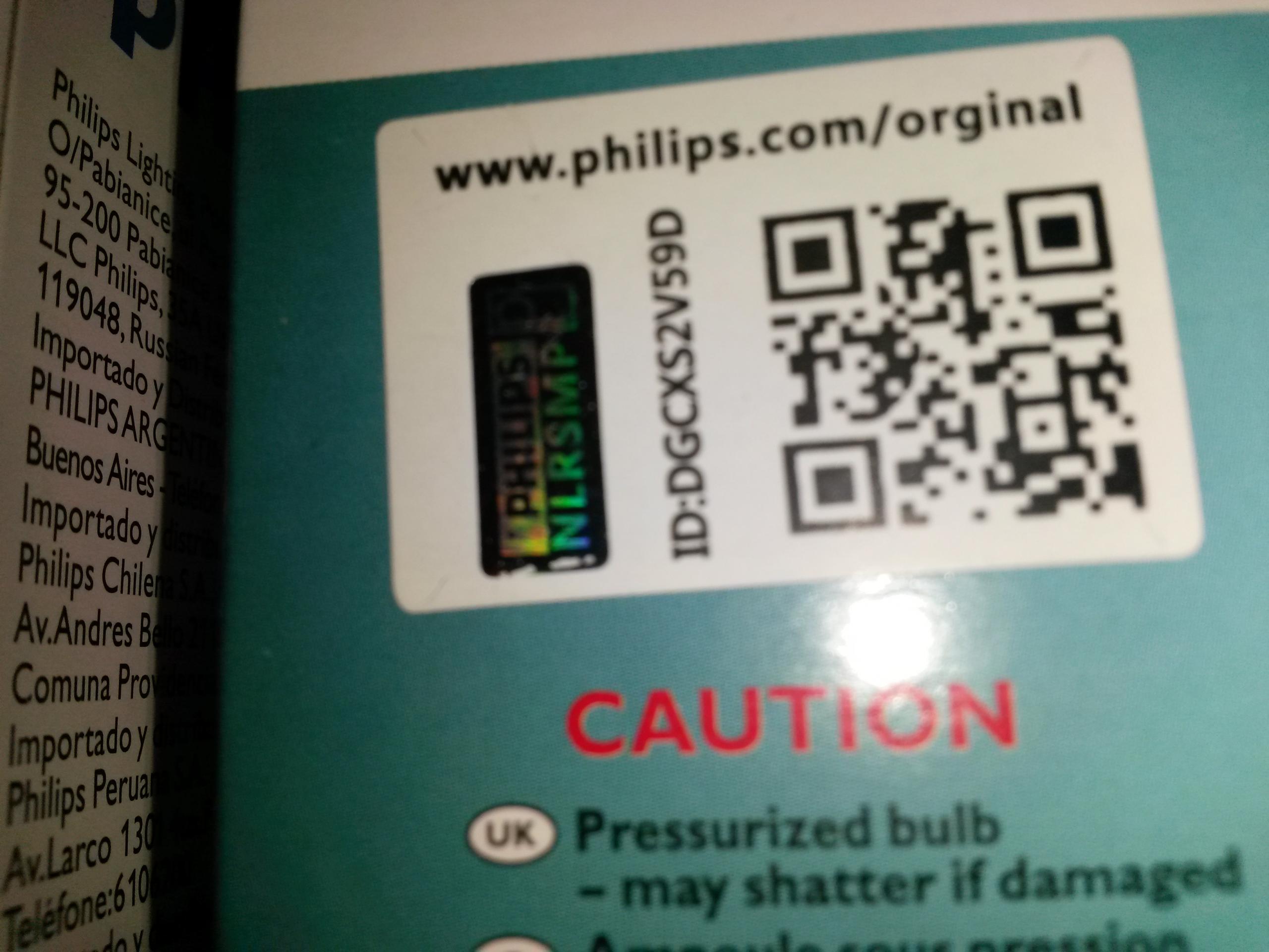

You're welcome For reference/comparison, these were the fakes I received. It's hard to tell from the photograph, but the holographic element is 'flatter' on these than the genuine units. Comparing the bulbs with photos of fakes online suggests they fakes have been gradually improving, making it more difficult to tell but the lack of weld points was the clearest indicator.

Thanks for those pictures Mark, where would these weld points appear and what do they look like?

These are the weld points (genuine bulb on the left):
The image was taken from here, which gives a few more things to look for:
https://www.powerbulbs.com/blog/2014...e-real-or-fake
It seems to vary from one fake to another which of the traits are present. The fakes I had were almost identical to the originals (as far as I could tell) apart from the missing weld marks and the missing 'curved' part mentioned here:
http://www.hidconcept.com/blog/a-war...eadlight-bulb/

By the way, the number printed on the labels of the fake units checks out as genuine on Philips' website, so don't be fooled by that. I contacted Philips because the labels were identical and they confirmed that they should all have a unique number. After giving them further info and photographs they wanted to know who the seller was and requested a copy of the invoice. I felt that they were using me to gather evidence against the seller so I declined. I decided instead to tell the seller what Philips had said and he promptly offered to arrange collection and replacement of the fake bulbs.

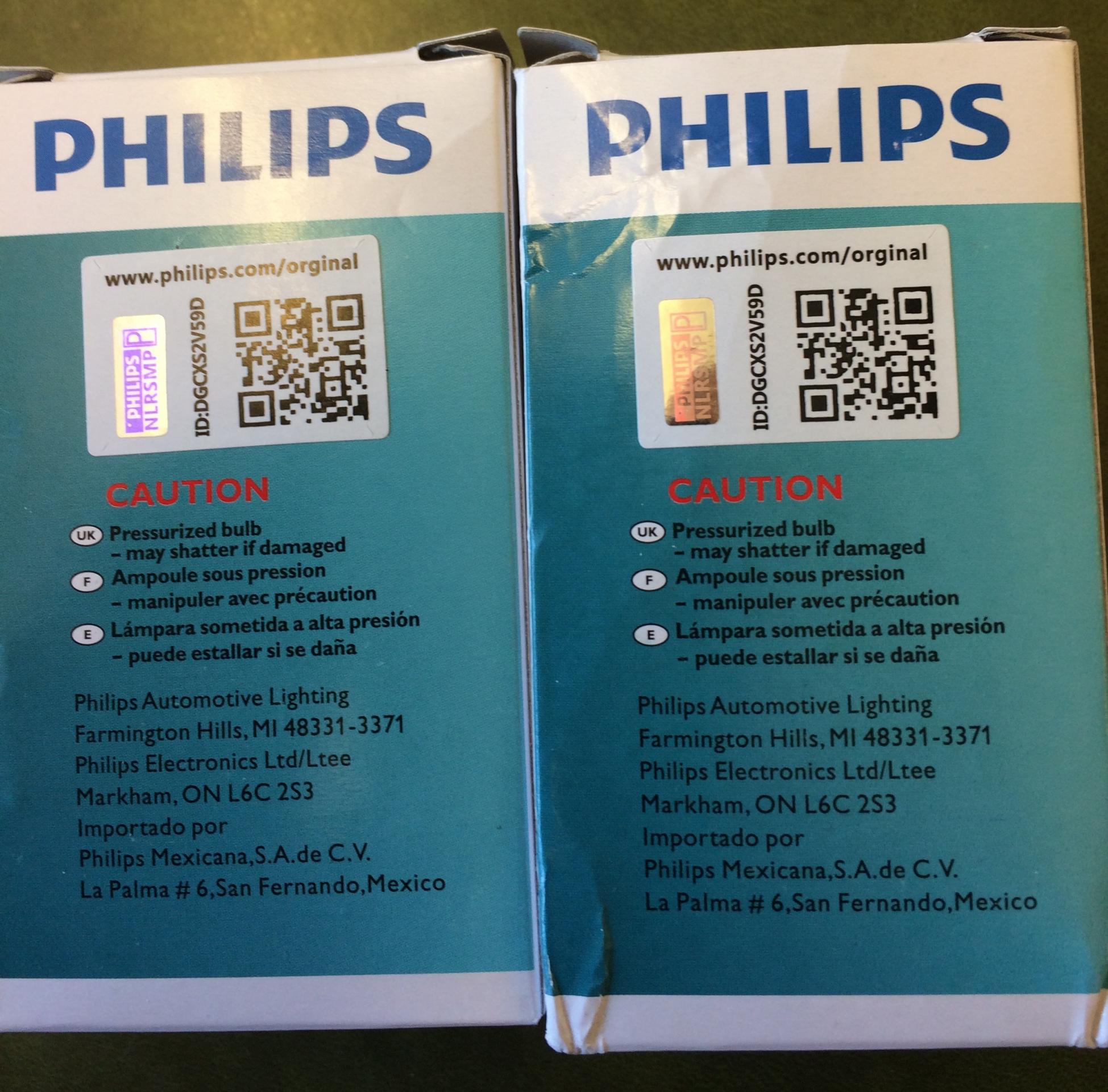

Well, well, well, exactly the same (unique according to Philips!) codes on both my boxes!
I'll post again when I've made some progress, meanwhile "lips are sealed".

The first thing that I saw when reading this thread and viewing the accompanying photographs was the heinous typo on the packaging, and that would have set Johnny's SPAG pedant alarm bell ringing (spelling, punctuation and grammar.)
www dot philips dot com ORGINAL?

Yes, mine were the same. A picture of those labels was among the information I sent to Philips for their "amusement".
