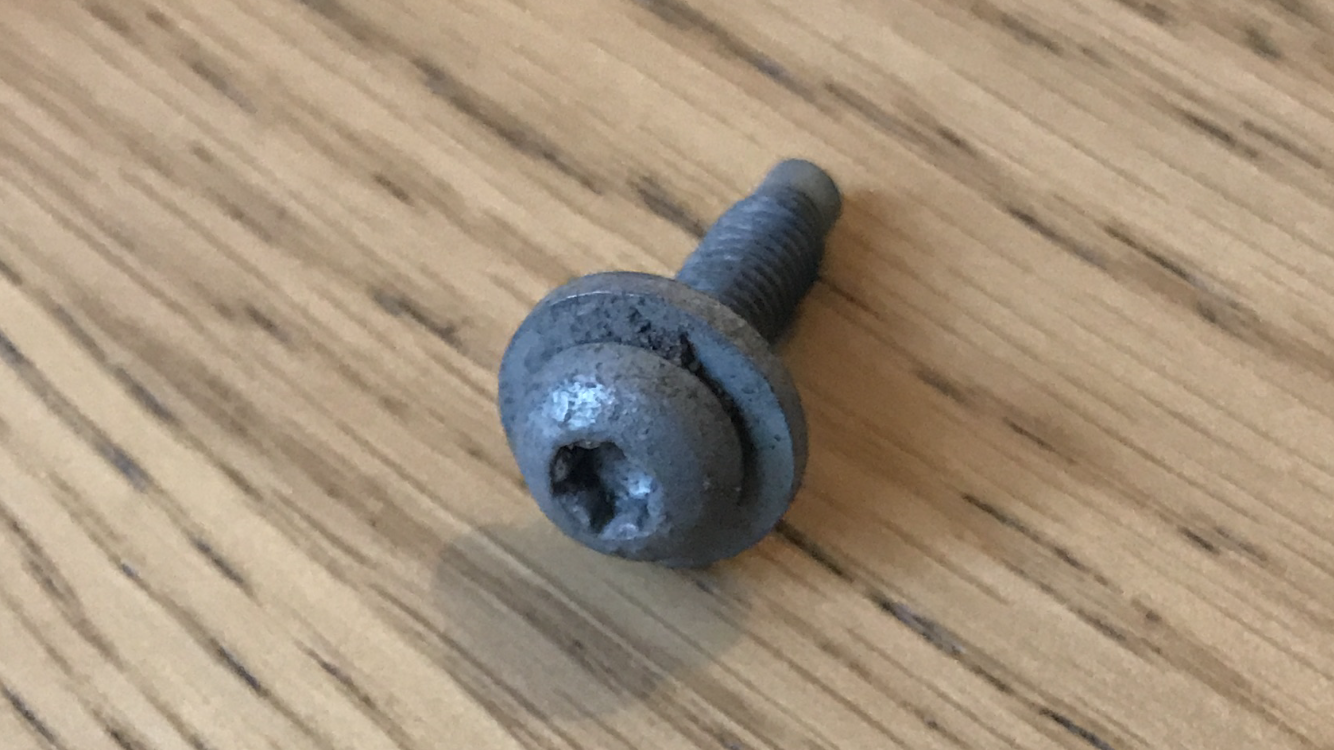

What type of screw (ooh errr) do you need Ray? Any pictures of one?

I think a nice pencil drawing, an Artist's impression ought to suffice Ray?!?!
Matt is one of those helpful enigmas, a man always with a quick and helpful answer to the unanswerable question. No one knows how he does it, or if he's actually just the one person, and not a team of people who share the same username.
Would this screw be of any use? My son just found it on our drive, it's likely from the A2 breaker I had a while back. If so I could use it as an excuse to drive over, and abandon SWMBO for an our or three!

John, that looks like the one.
