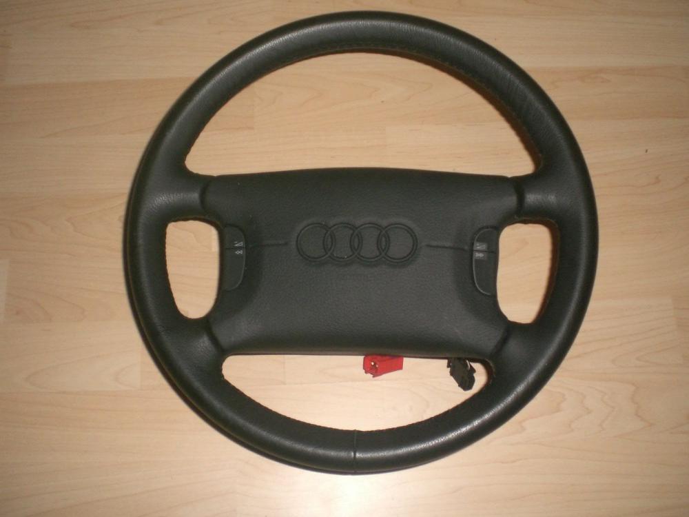

Thats a pre facelifted A8 MFWS steering wheel:
Its control a DeltaCC head unit.But i have no further info about it nor wiring schema
