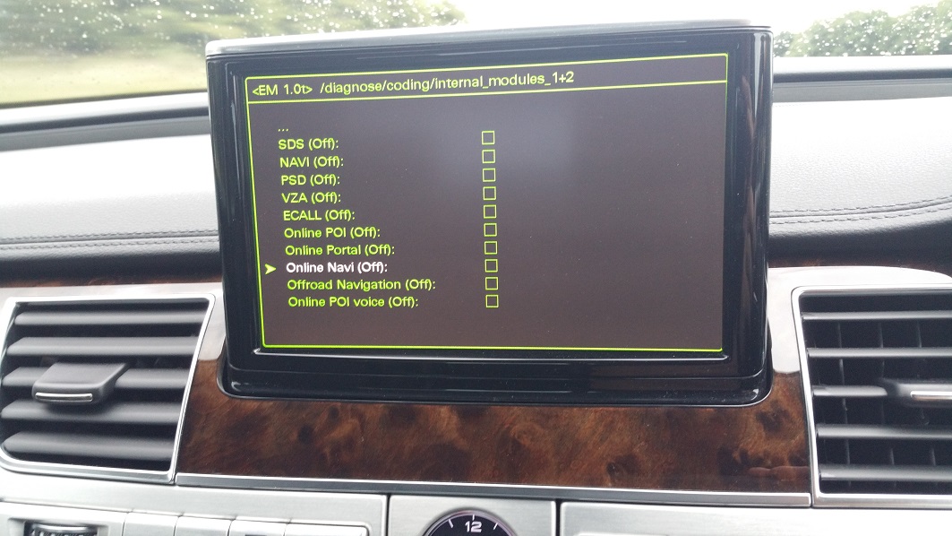

Default Success.....
As the D4 has been parked on my drive for weeks, thought I'd take it for a run and use some of the fuel sat in it.
Took the time to play with the green menu whilst the adaptive cruise was doing most of the driving...
Found this menu option (highlighted) which was on. Set it off, rebooted and it al burst into life.
So, all working perfectly now
2G is working ok - if you are motorway speeds and zoomed in quite close, it stutters a bit. 3G would definitely help there, as it would when my phone is tethered and decides to do app updates , but overall it works very well. I wouldn't be bothered enough to need to upgrade to 3G.
Best value for money A8 upgrade I ever did. - £0
