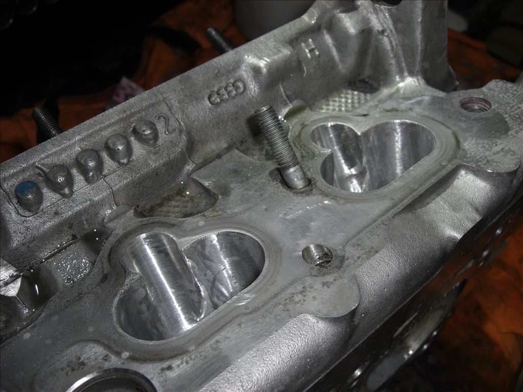

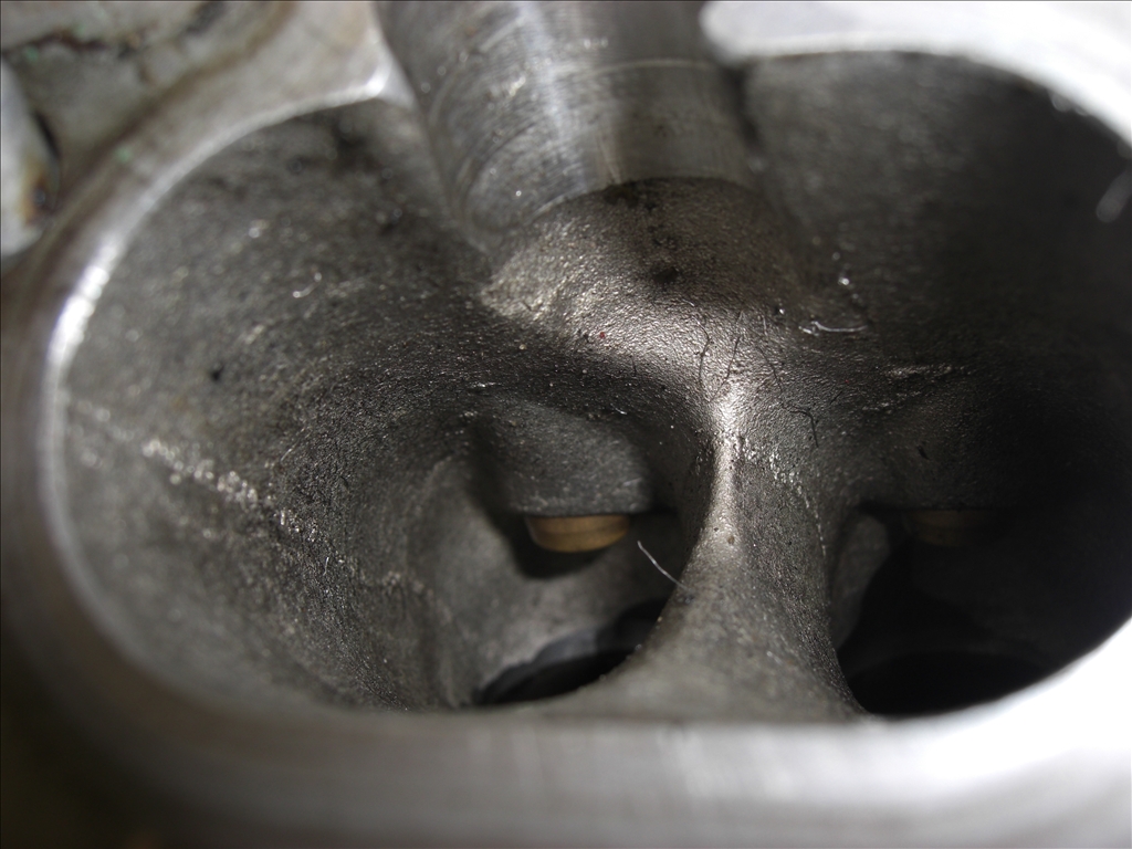

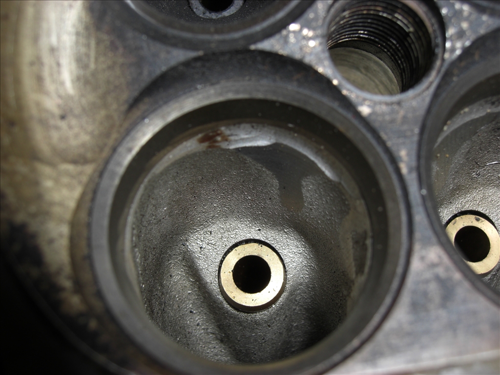

Not too much yet Amar as I have sworn Ben to secrecy!
However, all is not roses at the moment as the S8 engine we are using dropped a piston ring which has put us back and requires a full strip down of the engine and a full replacement set of piston rings which Audi don't sell!
Having to have them specially made...........
I will post a bit more on here when I have something to post, but here is a teaser.............
Before:
After:
