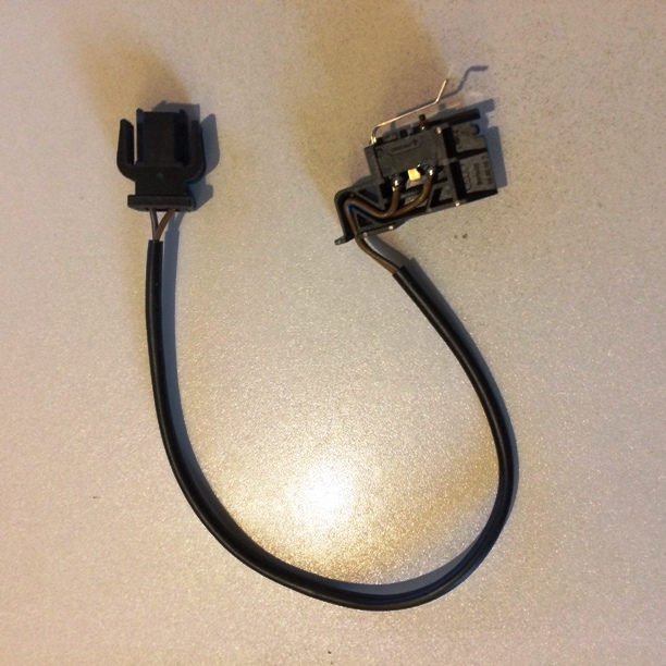

Further I've got a different problem in the boot, the light is coming on, but it sometimes takes till I've opened the lid all the way. Probably because it needs the small shock the let the microswitch work. Is there any way to lubricate the switch? Or do I need to look for a new one?

From my experience with boot latches it's more likely to be a broken (plastic) part of the mechanism inside, requiring a whole new latch - cheap enough from our sponsors. If you leave it the whole thing can jam extremely inconveniently.
To reinforce that I have a small collection of those exact microswitches, left over from fixing broken boot catches. It's the one part that didn't fail.
My advice would be to buy a spare latch first then start investigating when you have it and can see exactly how it works.

I think boot light switch is a separate switch on PF and integrated in latch on FL.
I've only looked at FL ones, didn't know or expect them to be different TBH.
The FL version microswitch is a component of the latch so in a sense is integrated, but in practice is easily separated (unclipped) and replaced.
It is actuated by a plastic component of the latch that is rather prone to failure and can't be replaced as it's within the body which is riveted together.
Here's a picture of a microswitch removed from one of my (now binned) collection of dodgy boot latches:
