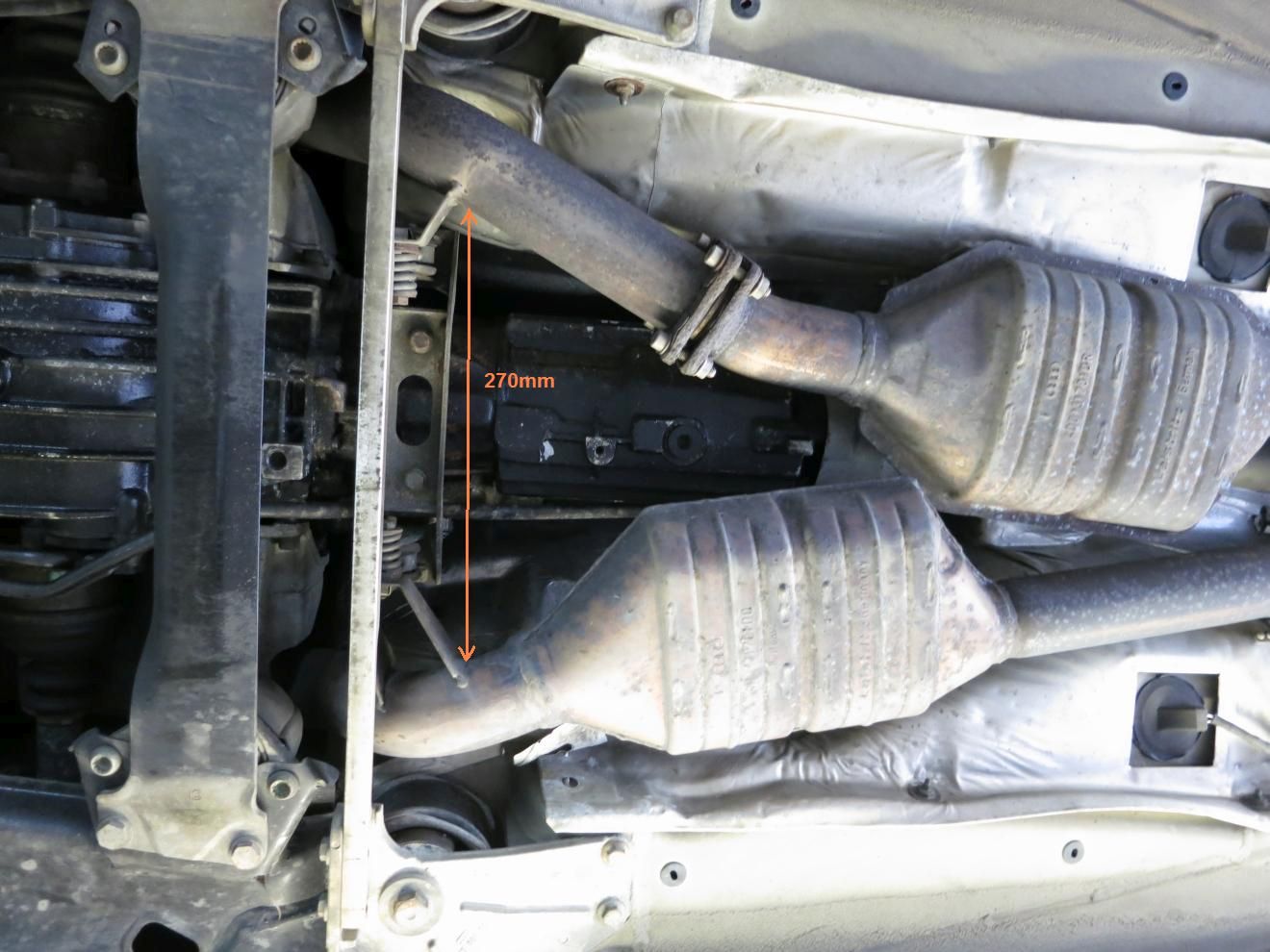

This is how stock cats look on a LHD S8, the RHD is almost identical.
These are the HJS cats, this is the better with both brackets easily accessed from underneath no need to remove the downpipe and front lambda.
