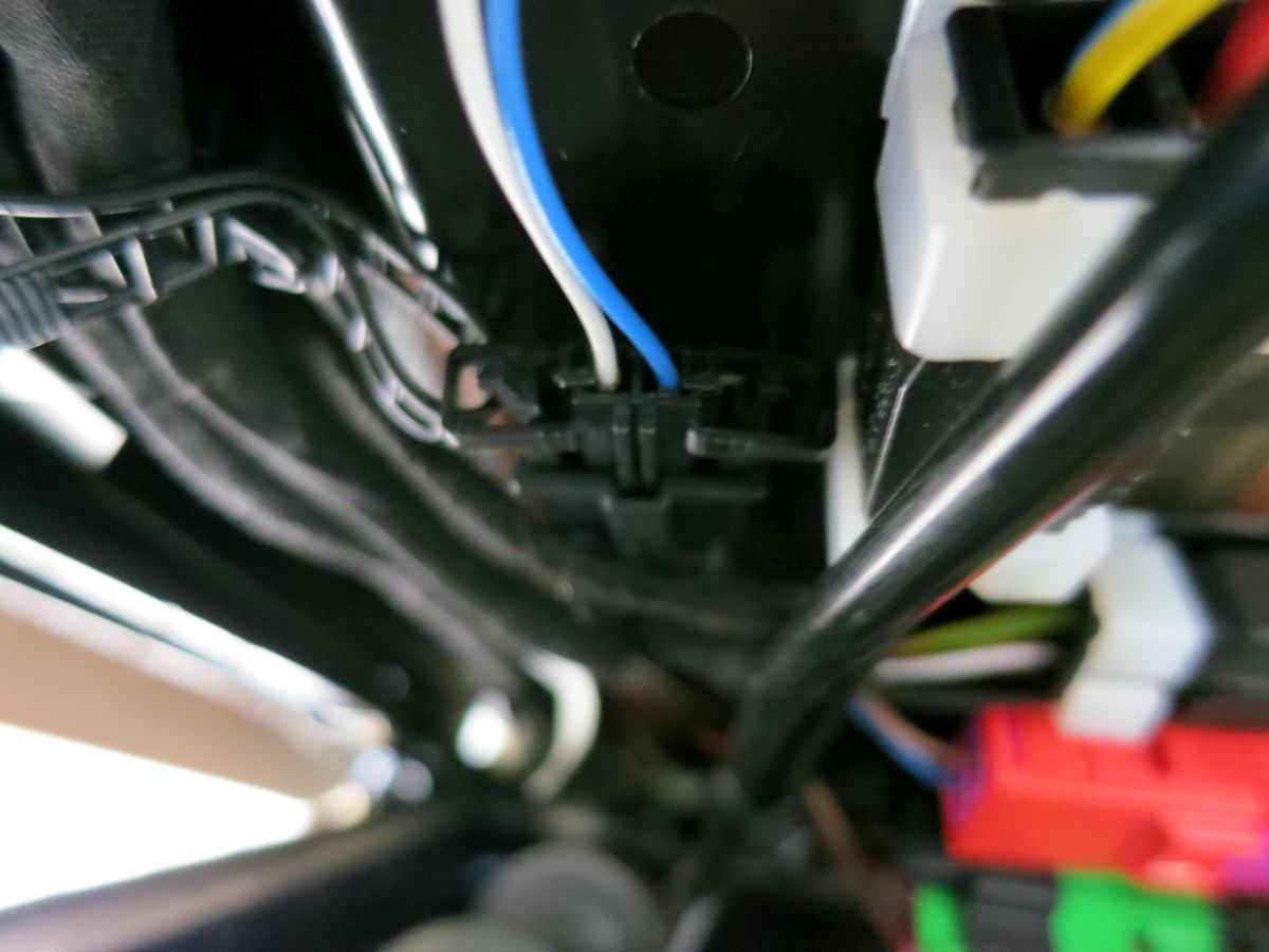

Just in case anyone didn't know. If you want to fix your passenger seat occupancy sensor causing airbag light on dash, there is no need to cut the blue and white wires on pins 2 and 3 at the brown plug.
Simply find the little black 2-wire plug, unplug, and plug your resistor straight into it. Or if you really want, remove the two pins and solder the resistor to them. That way if you ever want to go back to a seat pad you retain the oem look without any patched up wires.
The little plug is also a lot easier to reach and remove than the same wires at the big brown plug.

Old 15th July 2017, 05:30 PM
Excellent Goran!
Do I need to buy 470 Ohm resistor to fix that?
Could you provide a link to this resistor if purchased online?
Old 15th July 2017, 06:48 PM
Hi Sergey,
I bought this one from Maplins. There is a 10Watt one too but I thought maybe that's overkill. The 7watt one is big and solid looking.
Another tip, the tin? wires on the resistor are soft, flatten the ends with some flat pliers and then you have bayonets to plug straight into the plug. The round wires dont plug in as nicely.
http://www.maplin.co.uk/p/wirewound-...resistor-l470r

Old 17th July 2017, 08:17 AM
Just a reminder, if it's only the front (thigh) pad that is causing the problem (commonest case) you don't need a resistor, just disconnect it and leave the main pad joined up.

I'm presuming that the airbags will still work. Know to go off in a collision, but everytime in stead of, selectively only when there's a seat occupant detected
Yes, I assume they are active. With VCDS sit in the passenger seat and read the measuring block, it will say 'occupied'. The guys on the forum tried different resistors or measured the occupied resistance and came up with 470 ohms.
When I plug in that resistor, the measuring block says 'occupied'
So I assume the airbag is active.
