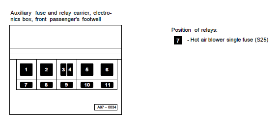

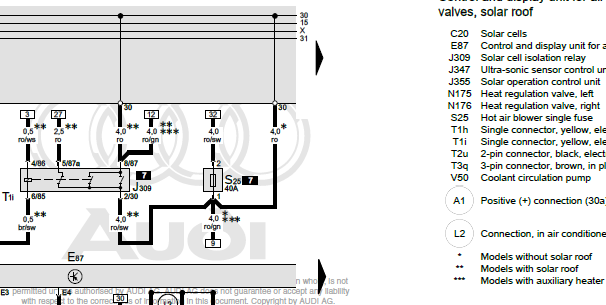

I've never had to change/check that fuse but it does seem to be in the passenger footwell, according to this pdf (position 7, S25):
Current Flow Basic equipment From model year 2001.pdf
It might be visually obvious if it's blown. Otherwise I'd pop it out and check it for continuity.

Thanks Mark, found what I think is it mounted with a type 204 relay; looks OK, tests OK.

Very useful attachment which I've been studying. Thanks Mark (moltuae).
As far as I can see the main power wiring for the fan is "relatively" simple, though there are some additional thin wires to control units that are probably signalling/sensing in function.
Basically the Brown/Red Earth side goes to a major earthing point via the Blower Controller. Is that the "hedgehog" unit?
And the Red/Black Power side (up to 12v) comes via the fuse and solar panel relay.
Now, I have noticed the recirculation flaps are sometimes closed and reluctant to open, though haven't yet detected any pattern to this. Does this give any clues?
