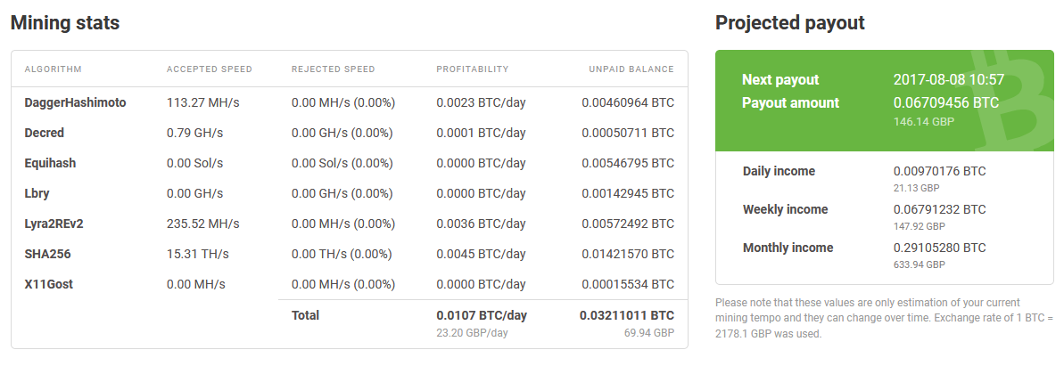

This is the total of my own personal mining efforts now by the way (my customer's operation is more than 4 times this size).
The SHA256 is my Antminer S9. The rest comprises of 4 x 1080Ti cards and a mix of 3 different RX 480 cards (including 1 lowly 4G model).
I'm hoping this figure will be more than double when I get the L3+ miners online.
