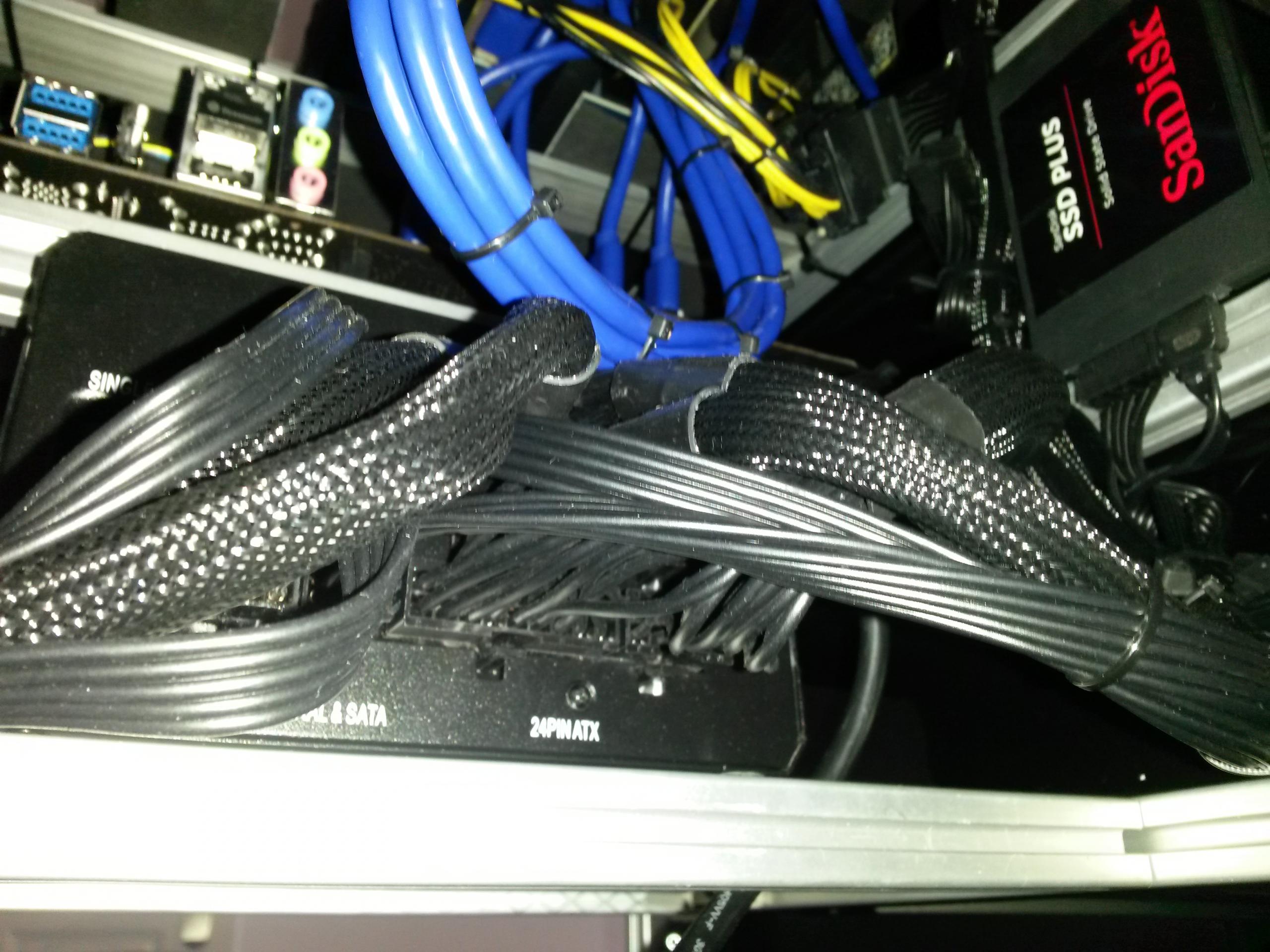

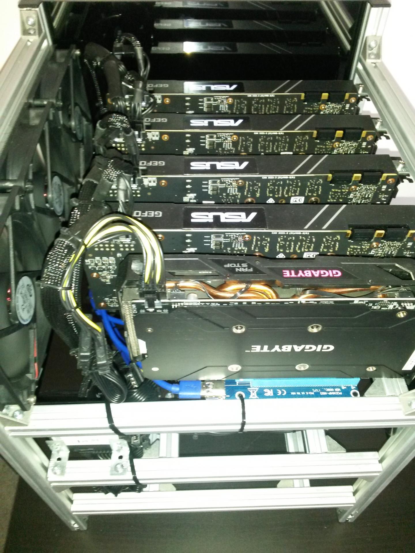

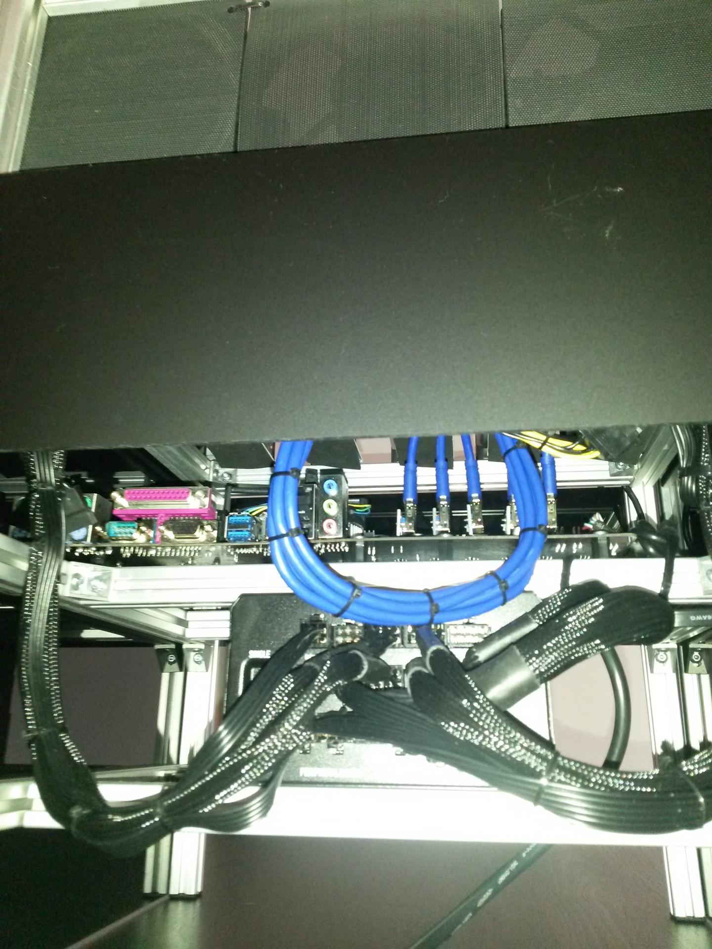

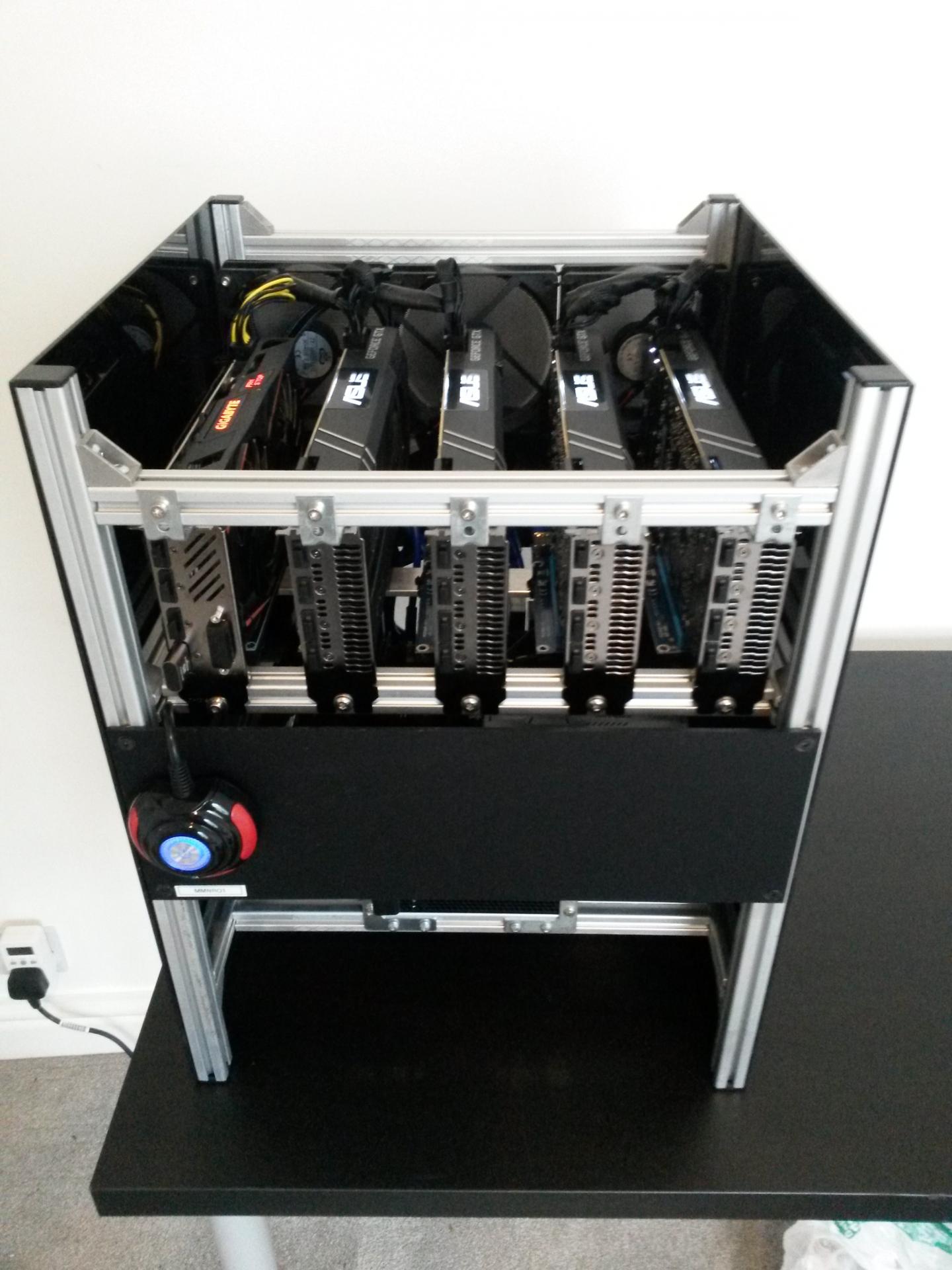

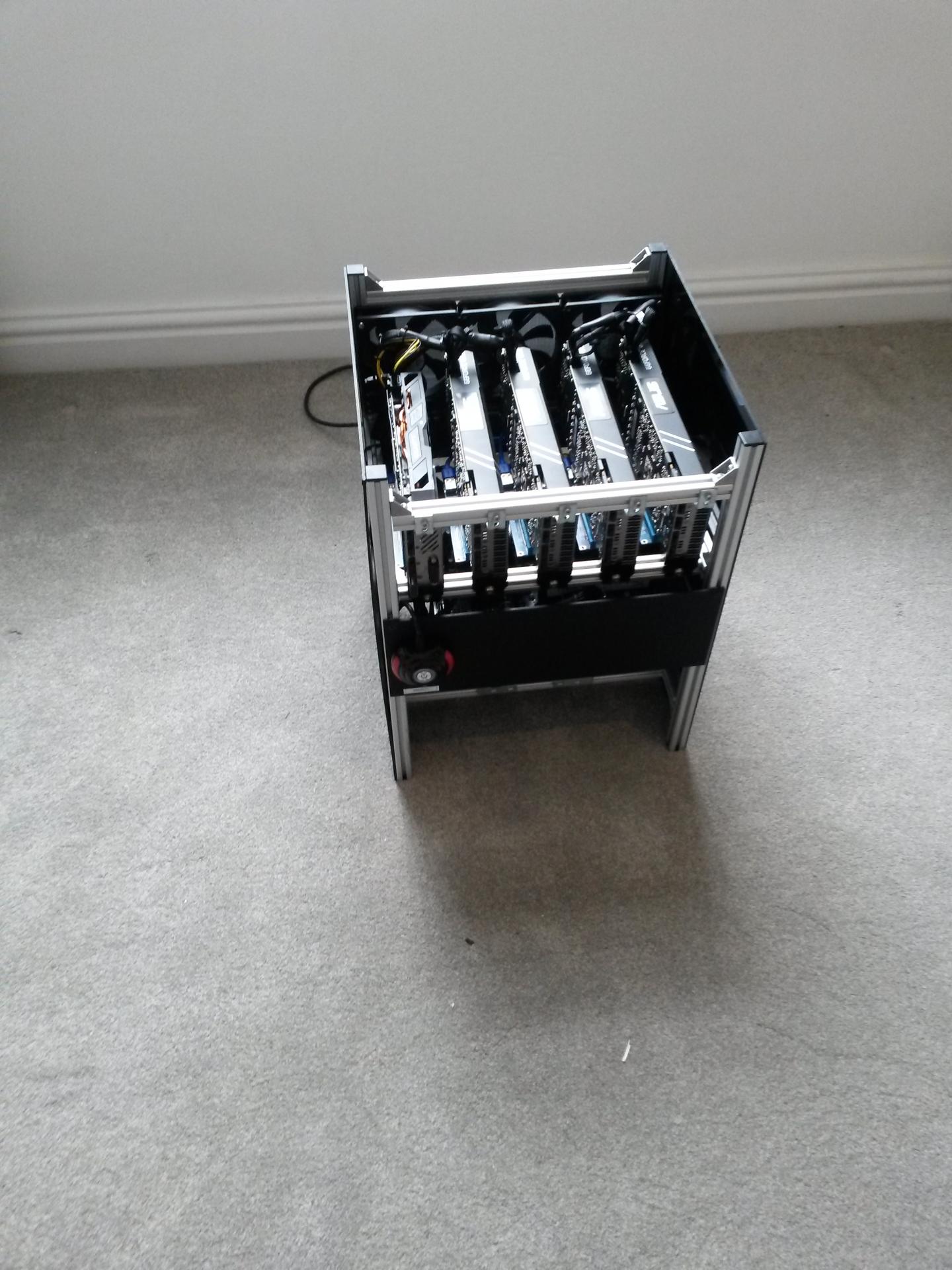

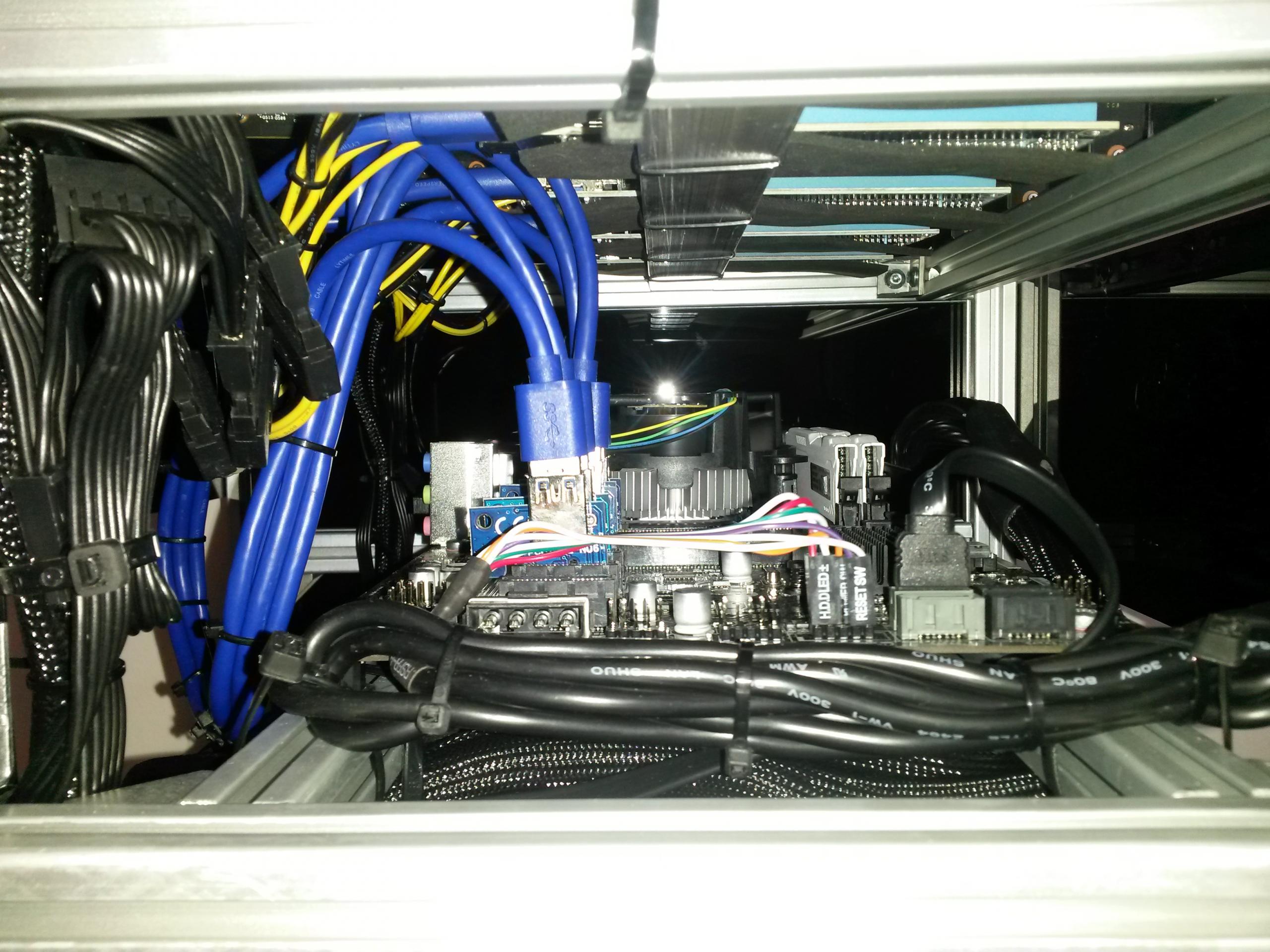

Finally got around to finishing and photographing my latest mining rig.
My aim was to make something robust, easily repeatable, stackable and (reasonably) compact. I intended it as a 4-card rig but I've squeezed a 5th card into this one for now, which is pushing it a bit on a single 1200W PSU. There's room for a second PSU though if necessary.
It's relatively portable and easy to carry (guessing it probably weighs about 15Kg). The black acrylic sheet panels give it a little protection and, along with the rear (filtered) fans, help to project most of the heat forwards to allow it to be used as a space heater.
I've also added a WiFi adaptor to enable it to be used anywhere there's a power outlet. I expected poorer performance mining over WiFi but there seems to be negligible difference compared with Ethernet. I do have 3 UniFi WAPs in the house though so that probably helps.

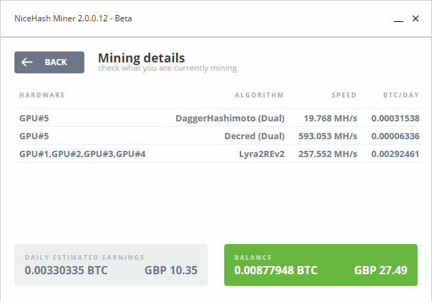

The rig currently contains 4 x 1080 Ti cards + 1 x RX 480 ....
