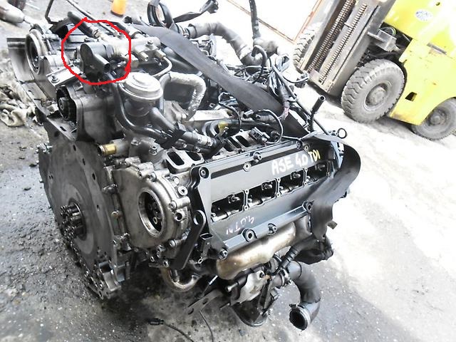

i still have to try the test where I pull the plug on the IMV and log the rail pressure. Trouble is, the thing I thoguht was the IMV might be the DRV going by our description above. I have circled the thing I thought it was in the attached picture.
As with you, the thing that confuses me is that everything seems to run perfectly when its actually running, so a sticky IMV or DRV would presumably cause some disruption while running.

The item circled in the pic is a DRV ...it's part of the high pressure rail assembly, the IMV is on the high pressure pump .
To do a proving test on the pump ideally you need to either take control of imv duty or 'dead head ' the pump , cap off all injectors , disable drv , this is so you are taking away all the routes that the pressure can escape from , we use a pressure block here with an extra rail pressure sensor in it so we can confirm the cars own rail pressure sensor is reading correctly and also the block had a safety blow off valve that lets the pressure off when it gets to 2000 bar !!
