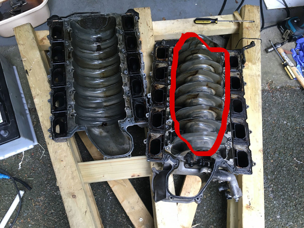

On the phone he said that unless he's done the correct work to the manifold there is no point in mapping it and it just won't make more power.
He also mentioned that the internal alloy baffle plate should have been left out i.e. this part on the right side of the manifold that's sandwiched:
I bolted my one back in after removing the flaps.
Anyway, its a shame as I'm still on the hunt for someone to map the car.
MRC also won't do it because they say it just won't make power and a new manifold would be needed so the search continues.
