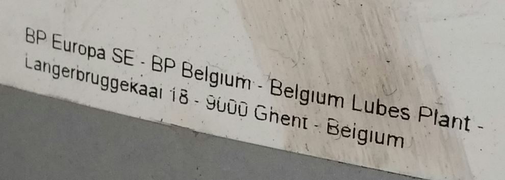

Quantum is made for VAG UK by BP, who own Castrol
This is a label from a drum of Platinum 5W40:
I put Longlife III 5W30 in everything except the old TDIs which get Synta 10W40.
