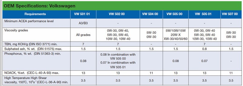

Interesting thread
https://www.bobistheoilguy.com/forum...or_am_I_wrong?
Name:	VW oil spec.png

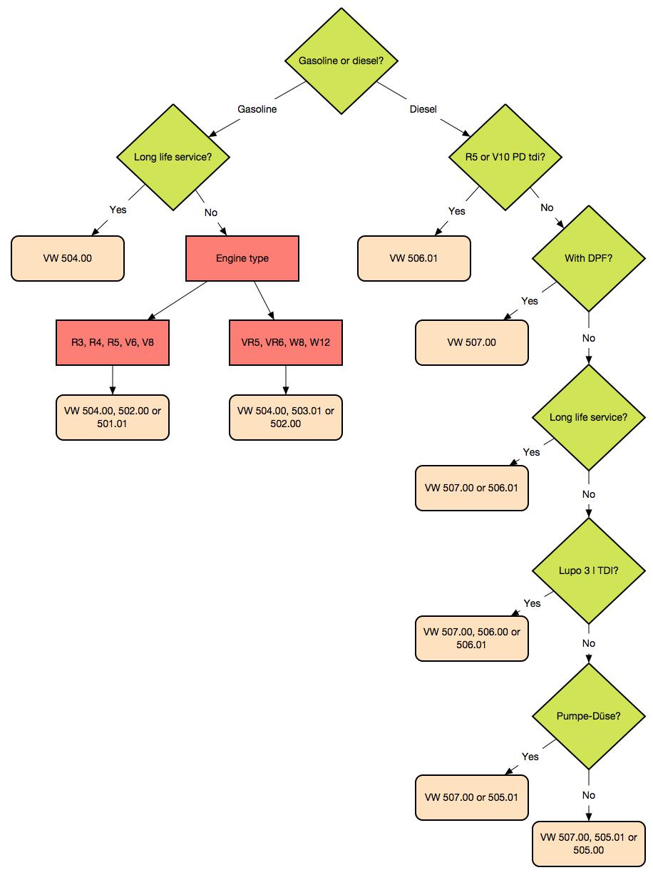

This diagram from the oilspecifiation.org site was quite good i thought.
Yes and one of the few sources that correctly says the R5 2.5tdi needs 506.01, its unusual for anyone to get that correct.
Slightly confused now, this suggests 507 is for Diesel, whilst my handbook for the RS6 suggests 507 is the correct spec, I know it supersedes previous 50* for the S8, so hence confusion from a simple country boy in a very dreich Scotland..
