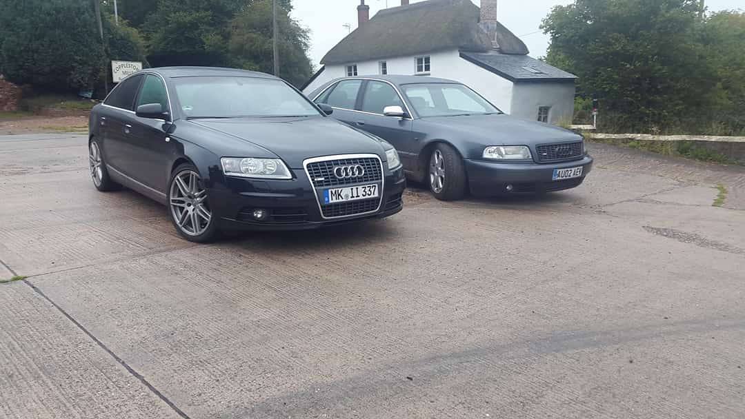

I was pleasantly surprised by a VIP visitor yesterday too

Is it my imagination MJ, or is your S8 lower at the front than the norm?
Love that Grey - My old A4 was Achat Grey and I loved it! The XC90 is dark grey too and looks great.
I don't think any were sold here that colour!
The mix of Black and Silver might be the closest I'll get

Its not your imagination - she is lowered on Intrax springs and Bilstein dampers
