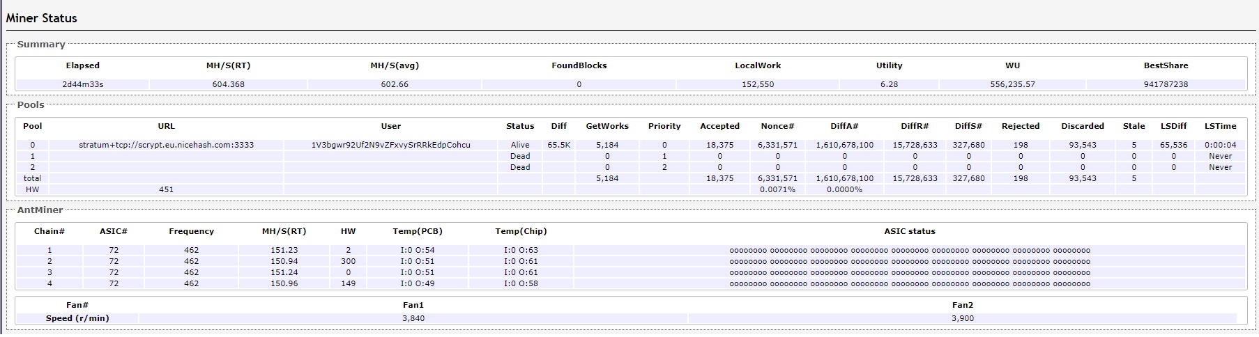

Yes, just changed frequency in advanced settings. Hashrate stayed 0 for a couple of minutes so I restarted it and could not connect to it anymore, got a bit scared. Turned out DHCP has assigned different IP, changed it to static to avoid future issues and has been fine since. Never seen any Xs but I only had it for less than week and played around with it a bit so it has not been running for long periods at the time. It does get HW errors on 2 hashing boards but it did it before overclocking as well and it's not too much of them to affect actual hashrate much
Also funny thing it found 3 blocks on the first day and none since that. If I was solo mining that day it would have been 75 LTC- £3000+

I get a lot of found blocks on the S9 some days, while using NiceHash, most likely when it's mining an SHA256 altcoin. I suspect it's the same with the L3. The blocks yours found may not be Litecoin blocks.
A small percentage of HW errors are considered normal. I'm not sure of the exact normal range but it's typically a fraction of one percent.
I think I'll try overclocking one of the L3s later. Why did you choose 462MHz?
Also, out of curiosity, what firmware version are you on?

Did not think about altcoins, you are probably right about found blocks being for altcoins.
My firmware is :
Hardware Version 1.0.1.3
Kernel Version Linux 3.8.13 #22 SMP Tue Dec 2 15:26:11 CST 2014
File System Version Fri Aug 25 17:28:57 CST 2017
There is only 1 available to download from Bitmain and that is from the same day 25/08/2017 but 17:37 instead of 17:28 if I remember correctly.
I chose 462MHz because I found a post on internet somebody else successfully using that speed. When the weather gets colder I might try a bit higher.
