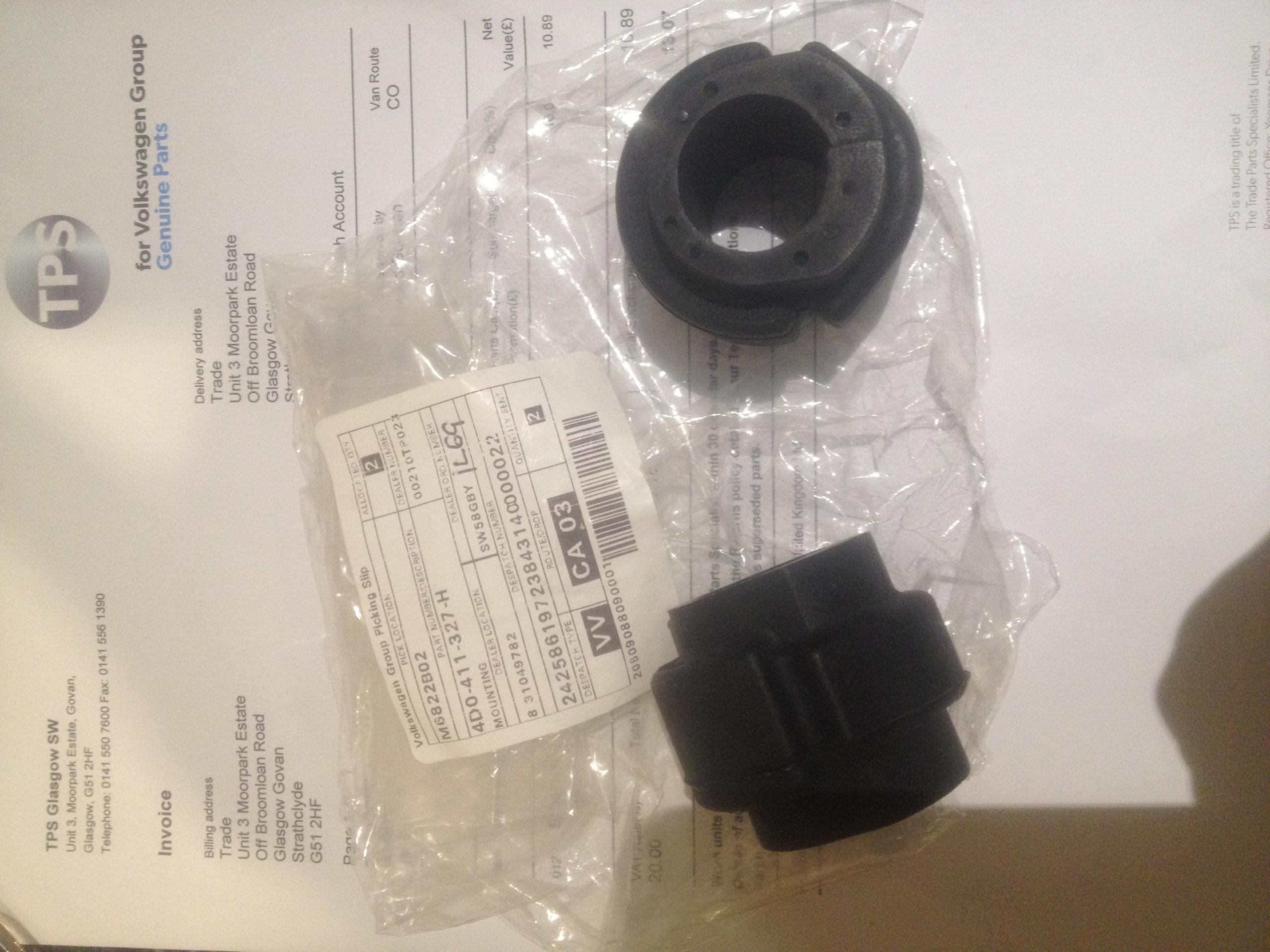

Well, after looking at online suppliers, whilst they show good "headline" prices (around £3.50 each for Febi bushes) the (european) suppliers pile £8 postage and £3 "delivery charge" on top. TPS provide OEM bushes at £13.07 inc VAT for a pair.

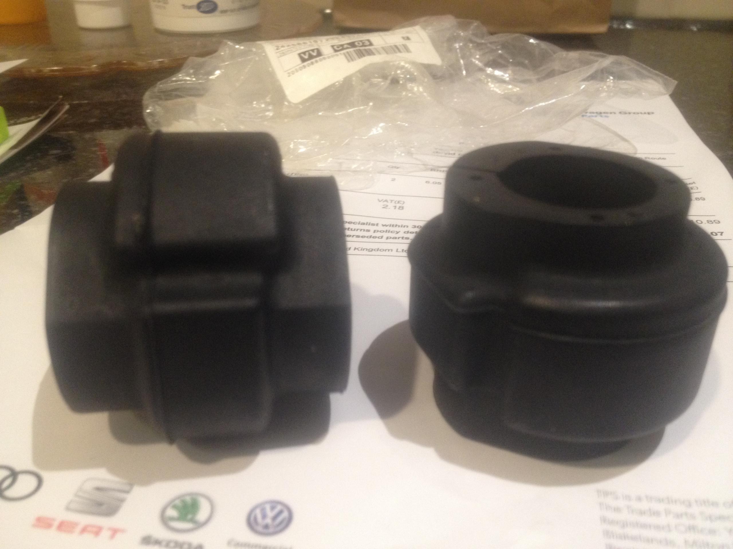

Old 1st November 2017, 07:12 PM
i did wonder about the 27/28/29mm sizing. I measured the bar at 30mm using calipers and a ruler so probably over-estimated it. The bushes for the non-sports bar are all listed as 25mm so 1.8mm less than the actual bar size. Interesting
And you'll know they'll fit.
Thinking about the dia being slightly smaller dia than the bar, so I'm assuming because they're split, when done up they get squished / stretched together some the ends don't meet before clamping the bar.

Yes, I just thought that I would give TPS a call. They had them in stock so picked them up when going into Glasgow
I hope they fit, Dezzy. I measured the bush inside diameter and they look to be about 26-27mm and I guess your hypothesis about stretching under compression and therefore they need to be smaller diameter than the ARB.

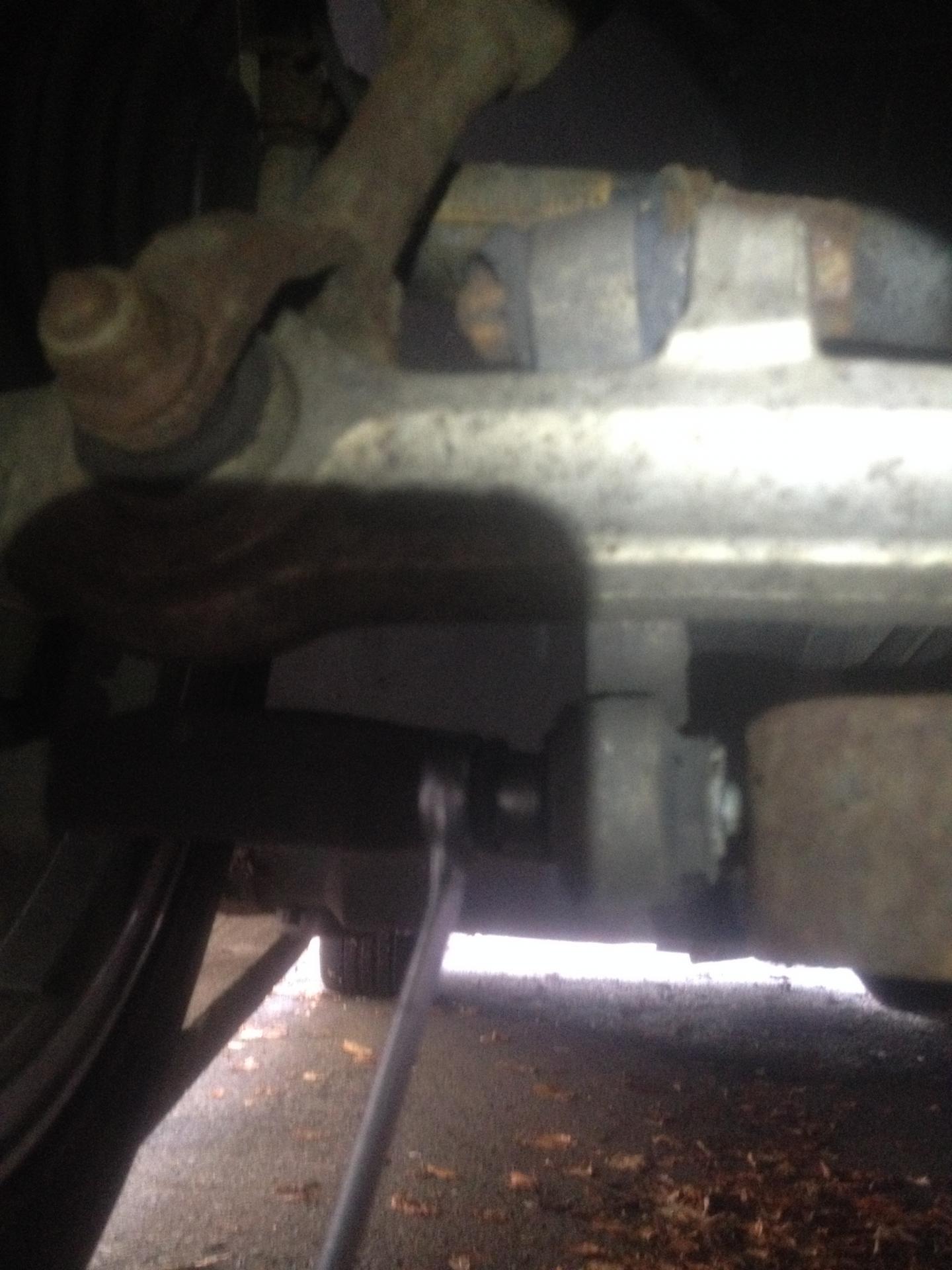

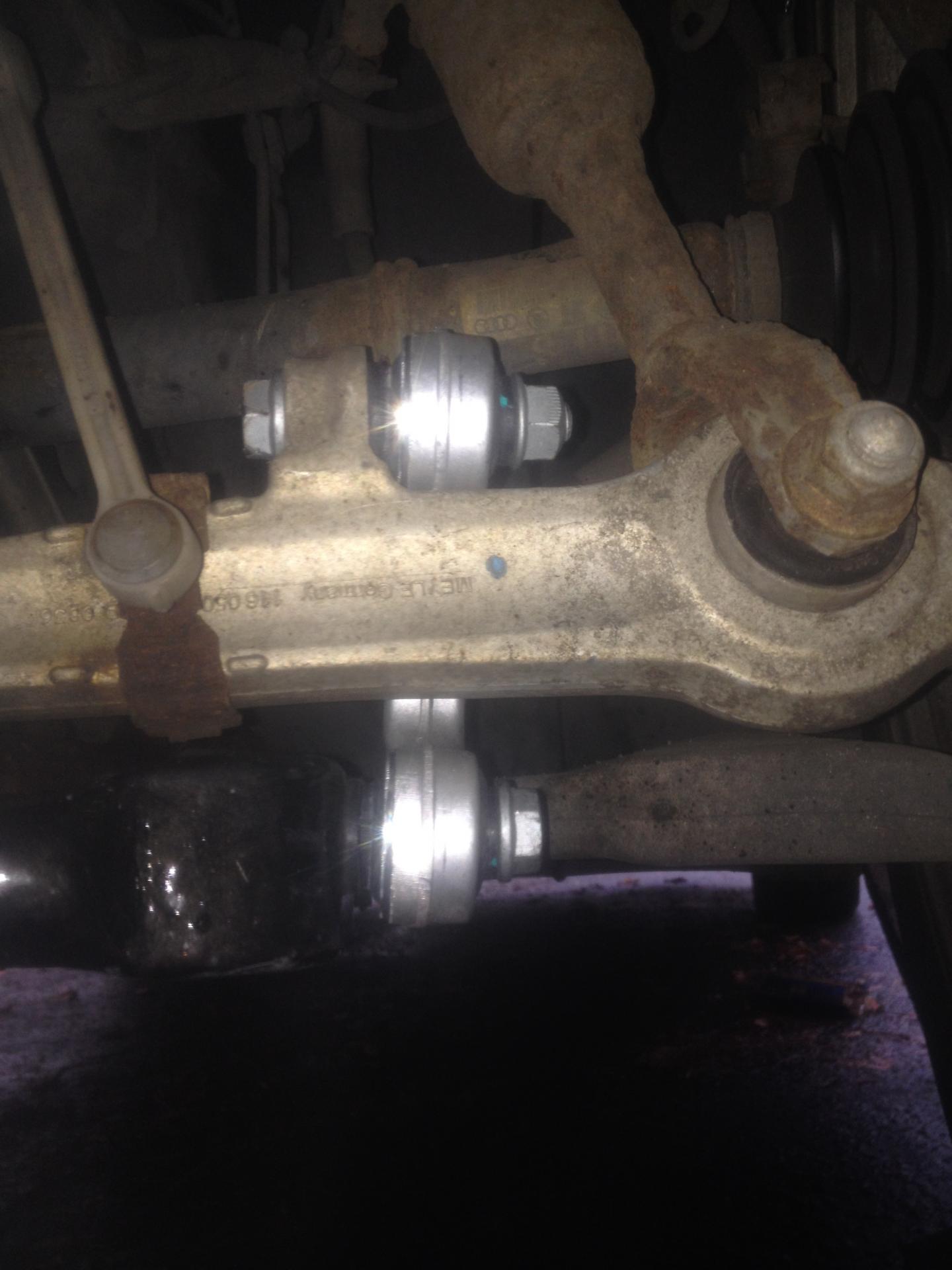

Despite the rain and cold, bit the bullet to finish this job off. Careful to follow instructions in service document, I am concerned about the final line up of the "C" shaped link, the anti roll bar and the track control link (arm). The Service Manual Running Gear page 81 clearly states that the connecting links have a "permanently fitted spacer disc" which must be fitted to the ARB end. From the drawing it appears that one of the bushes IS slightly thicker. However, the bushes on the Meyle links dont appear to any different at either end. On inspection of the old (original, AUdi) links there is no discernable difference on those either. This results in the links not being truly verticle with the result that the bushes are under strain. The photos below show both the old and new bushes in place and the lack of alignment is apparent in both.
Any advice?

Old 6th November 2017, 02:49 PM
I think the links were originally handed but at some point that spacer piece was removed and they became identical. The aftermarket seems to be fairly split on whether to put it on or not - when we did the suspension on the Trader's 8 we had two identical links with the spacer which both fitted the left of the car but not the right
I'll have a look at mine later. I'm not sure they're at such an angle like yours but its a while since I put them on, and mostly I only see them with the car in the air. I wonder if some alloy spacers on the bar would improve their service life?
Hmm looking at Etka they are handed for the A4 & A6, but never so for the A8, which explains why I have both in my spares pile I guess we could use the A4 links to reduce the angle, but one has to wonder why the A8 had different links in the first place since it shares so much else in that area
