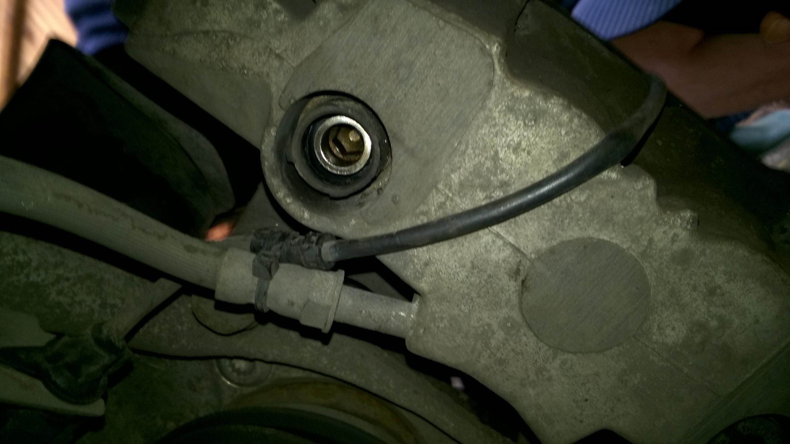

Just come across this myself, In france front wheel off trying to change the pads
Stuck at the caliper
anyone have a definitive idea on the tool required and size?

just going through some old posts and saw this
the socket required to remove or loosen the caliper slider pins on the front brakes
is a " H9 socket " 9mm hexagonal socket
some silly bugger thought it would be good to come up with an odd size socket so it makes it harder to change things
