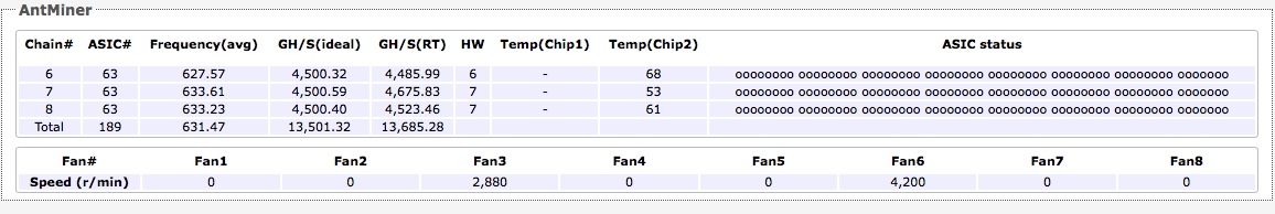

What kind of freq is your S9's running at?, i assume its related to temps is it?

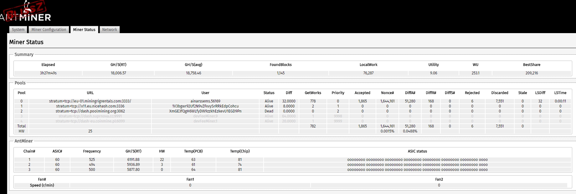

Good question. I'm not sure. I assumed it was a fixed freq. Here's mine ...
(First one is running is running in a customer's server room, which has HVAC, keeping the room at ~18 degrees C. Second one is at home.)

Abut the same frequency here. On the older S9 you could set frequency and fans speed yourself on the later models they use so called autotune. If the temp goes above 75C it starts increasing fan speed, if the temp gets near 110C it will start decreasing frequency and voltage. Looks like yours have very different fans as they run different speeds. My and my friends are running both at the similar speed. My has Delta 3A intake fan and Yate Loon 2.3A exhaust, his has Nidec 1.65A both ends. All running about 4500rpm without ducting and near 6k rpm with the ducting. The fans have different pitch, mine is easier on the ear without ducting but with the ducting his are quieter.

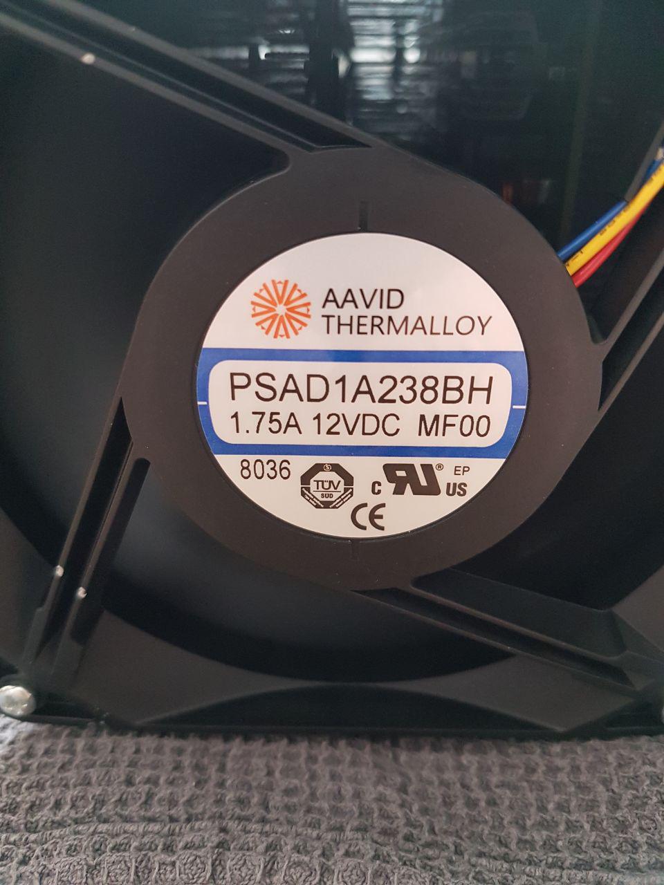

You mentioned about the fan speed, so I took some pictures of the fans, btw they are noisy at full chat
Pull Fan
Push Fan

AAVID I have not seen before, Shengjiu I have on one of L3+
