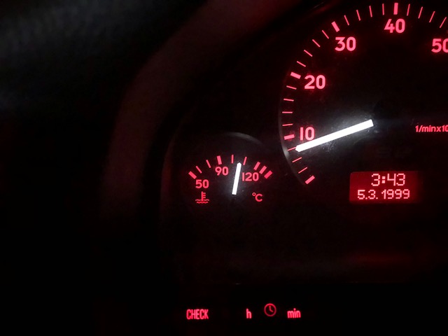

Damn vcds couldn't get it to work. I think my cable is broken. Anyway see attached I didn't dare go any higher than that. It was running absolutely fine. I guess there is a simple test to see if the water pump has gone?

Old 23rd February 2018, 08:15 PM
Join Date: Jan 2018
Location: Isle of Wight
Posts: 283
Do you have a flux capacitor in your car? The date on it is showing 5th March 1999!!
Does the overheating kick in around 88mph?!
