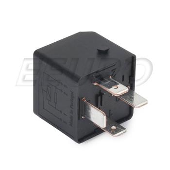

I got the car back and drove it home
They replaced a multi purpose relay 4H0951253A.
From what I can see on the bill, there is a control unit for the fuel injection as well. But I can't figure it out. 24701900
*edit - probably the work removing and installing the ECU

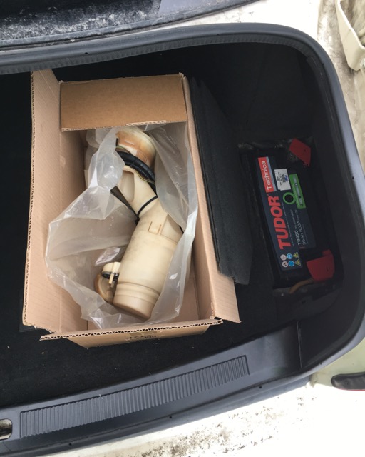

They didn't charge me for it. They left the new fuel pump installed. And I got the old fuel pump back as well
Man, is that a large unit?!
