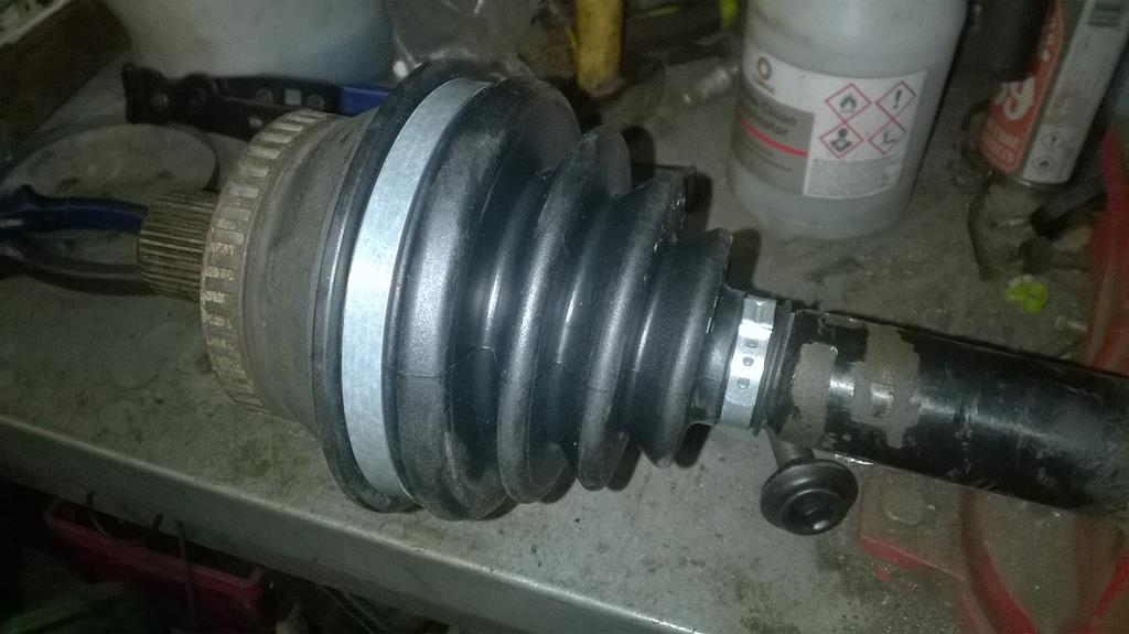

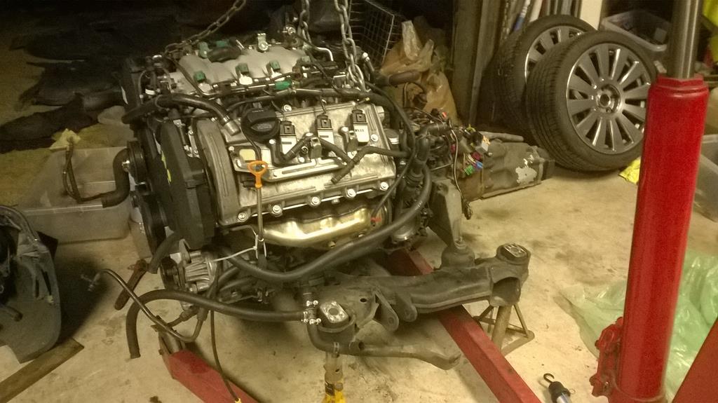

Last night's update this morning since I finished quite late. Time is getting rather tight now with the two new challenges.

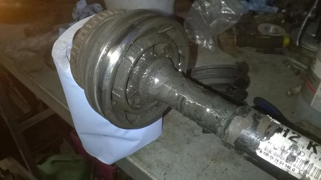

Did the CV boot. Caught it just in time - there was hardly any grease left in it, but no dirt and the joint is fine.
New boot

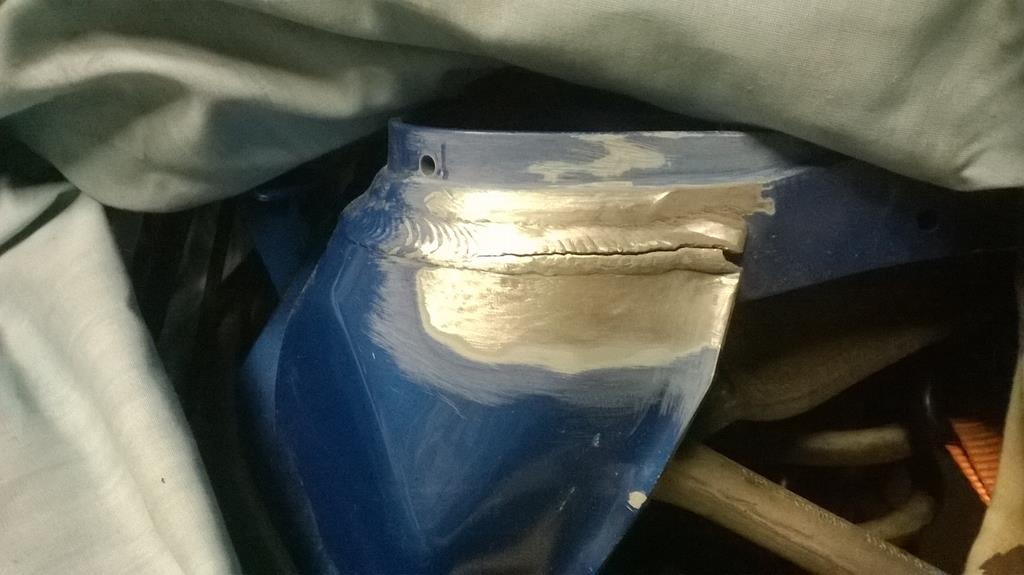

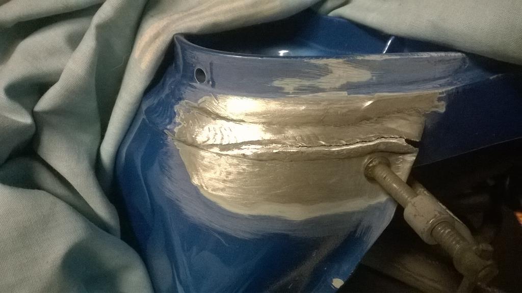

I was not expecting to be removing blue paint this week Cleaned up the area to be welded and chased out the crack with the dremel.
Clamped it down ready for welding
The engine is patiently waiting to go back in

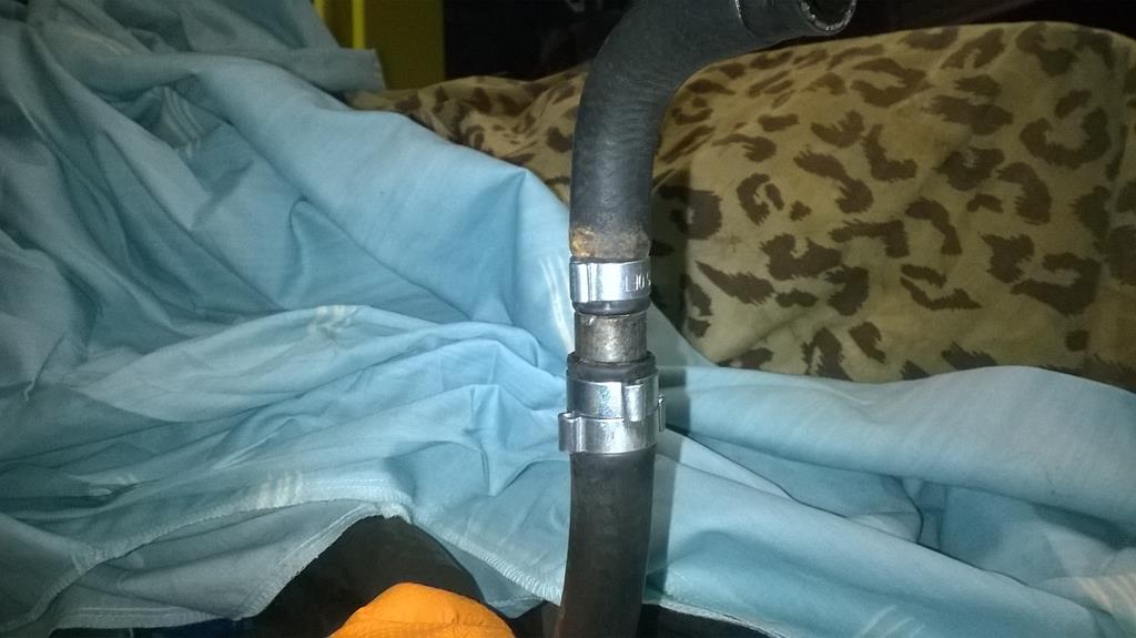

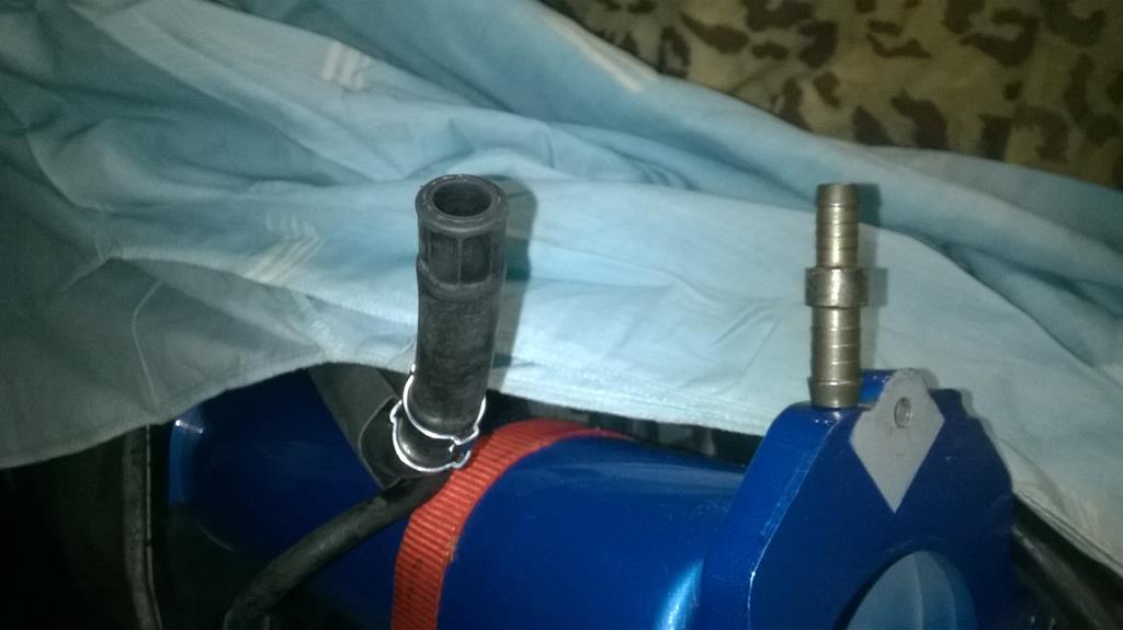

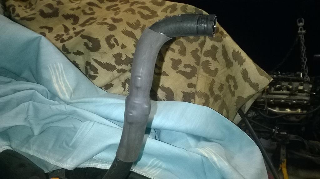

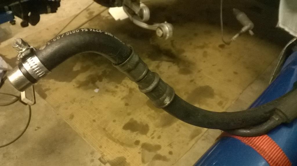

Tackled the leaky power steering hose. Since this is a LHD-specific part there's no way we were getting a replacement in time so I'm repairing it instead. Its leaking from the joint as the crimped joints are loose - a standard D2 failure mode
Carefully cut the old crimps off with the dremel and clean up the joiner and hose ends
Re-crimp the hoses with O-crimps
Cover with adhesive-lined heatshrink for protection and neatness

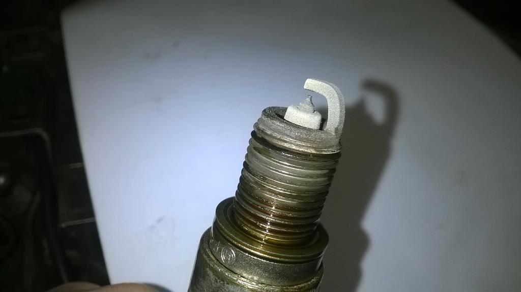

One of plugs from the old engine. The ash on the tip tells me its burning the oil, but the lack of petrol smell in the sump does reinforce the blow-by through the crankcase vent theory.
Welding commences in about half an hour hopefully...

Old 12th April 2018, 08:09 AM
That cracked weld is a bit worrying. I wonder if it's a common problem. Can the weld joint be seen/inspected without major disassembly?
  #47
Old 12th April 2018, 08:13 AM
I've not seen it before, but its mostly hidden by the header tank and the plastic strut cover. You could see it by removing the cover.
  #48
Old 12th April 2018, 08:39 AM
Given that MJ believes the usual cause to be "potholing" then I wouldnt be surprised if its a common problem given the state of the roads. My Indy garage reckons that he sees a big increase in suspension/wheel damage over the past few years as the roads deteriorate.
