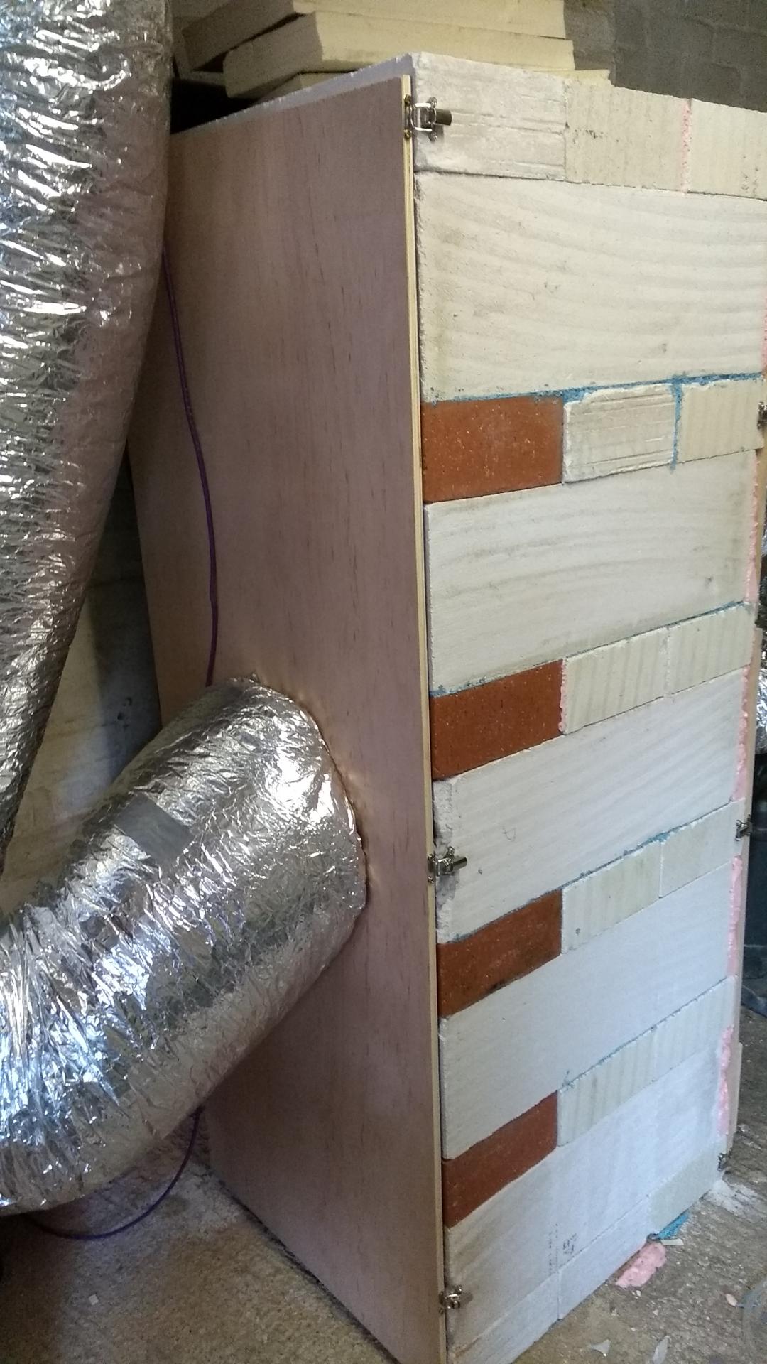

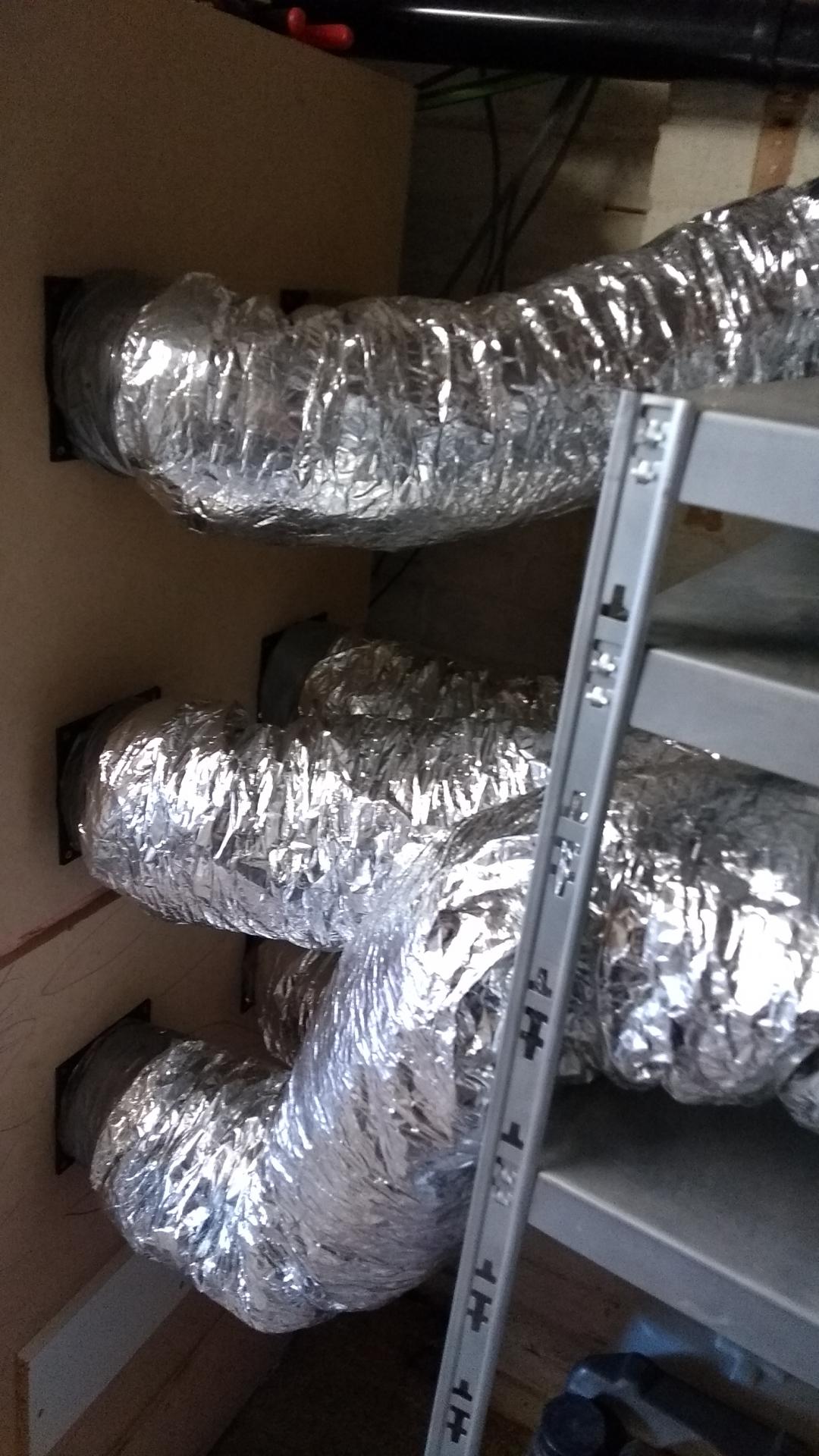

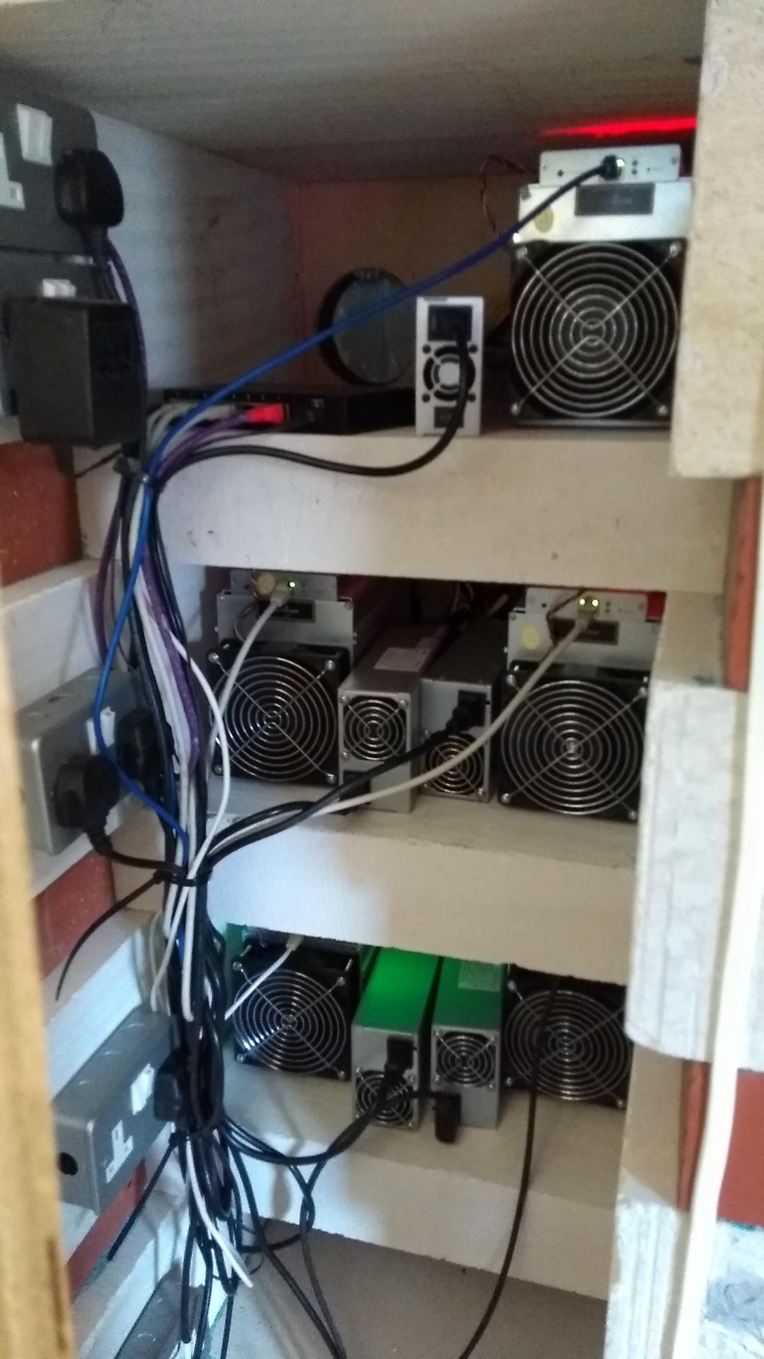

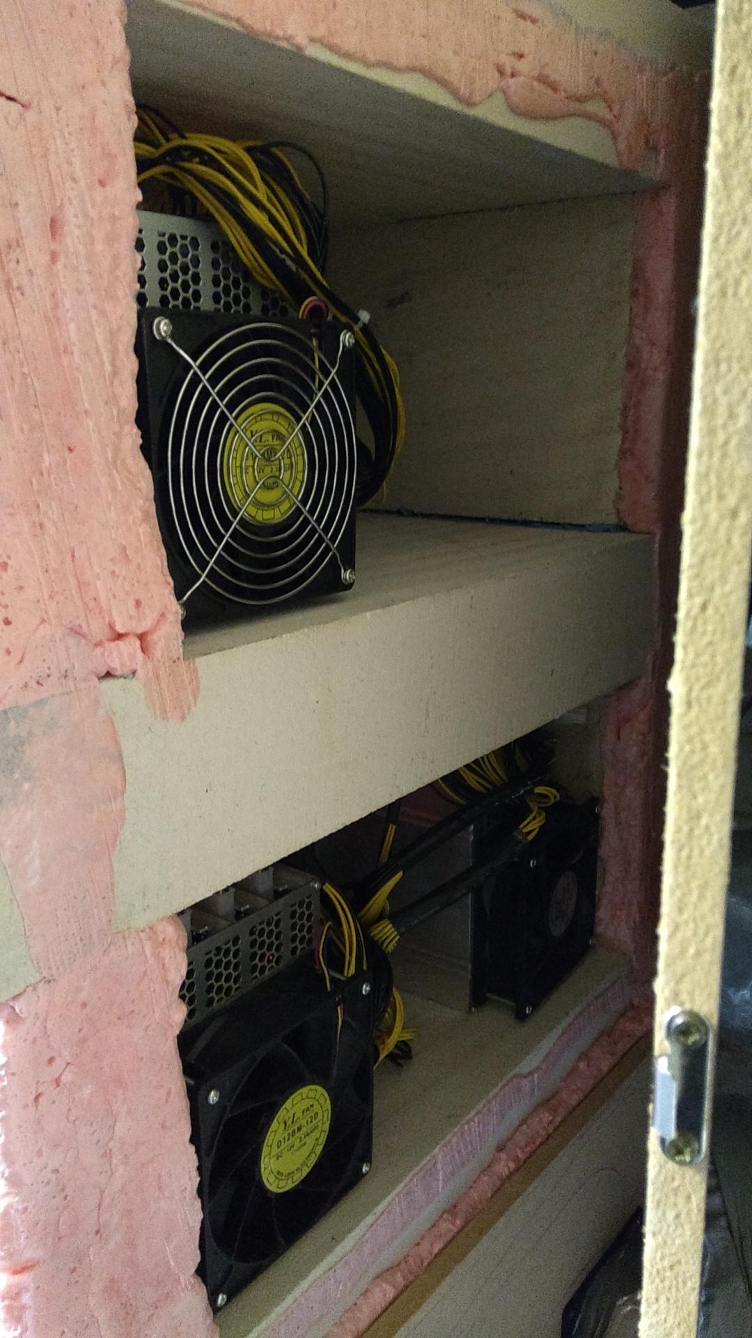

I made a 'box' as well although not fully finished yet, needs a bit of noise insulation on the exhaust side and also around air supplying fan. Noise gone down from 85dB to 50 with external fan off and 60-65dB with fan on. There is space for 10 miners but at the moment only 5 in there.

Nice job
That's for an S9 presumably?
The problem with the L3 is that it has those extra ventilation grilles above the fans, so any enclosure needs additional fans to vent the heat from those grilles ... but then the L3 isn't as noisy as the S9 anyway.
Yeah I've got s9 and a3 in box like this the L3's are in the shed keeping mike bike warm
I baffled the inlet side with foam so the intake fan is sealed from the exhaust side
seems to work just fine so far

Nice setup
